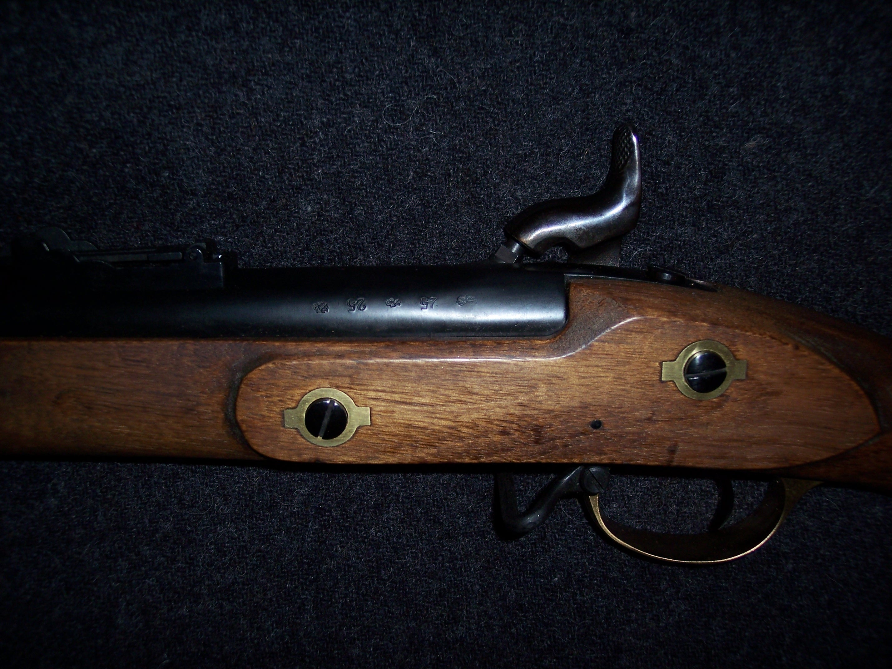

    Well, he told me to be amazed when my Enfield arrived after his defarb job, and I must say he wasn't lying. I took it out of the box an hour ago and there isn't a hint of any old markings, except for a small dent on the lockplate, but that was to be expected, and you wouldn't know it unless you knew exactly what to look for. The stock was stripped, reshaped and oiled a really warm brown, and restamped with the inspector's marks. All the stamps on the barrel are in all the right places. And the barrel bluing is literally top shelf -- like it just came off the top shelf at the retailer. Bands were also reshaped and blued, and the nose cap riveted. Plus he threw in a good polishing of the brass all around. I also sent my bayonet, which be blued and stamped.
    I definitely recommend his services to anyone who needs an Enfield defarbed. Great job Todd!!!

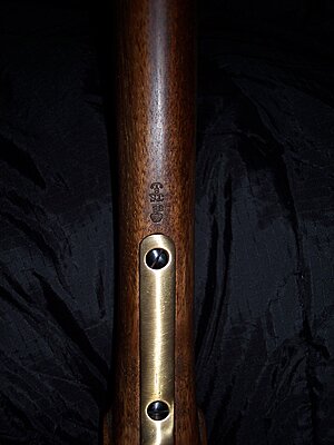

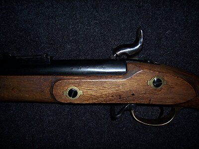

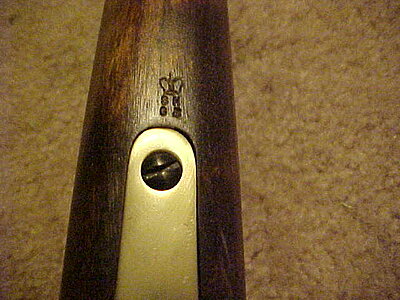

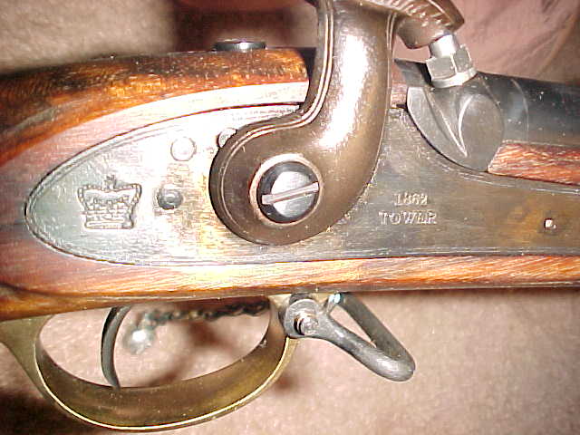

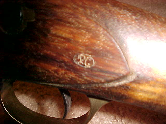

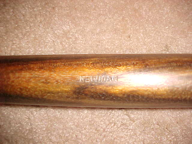

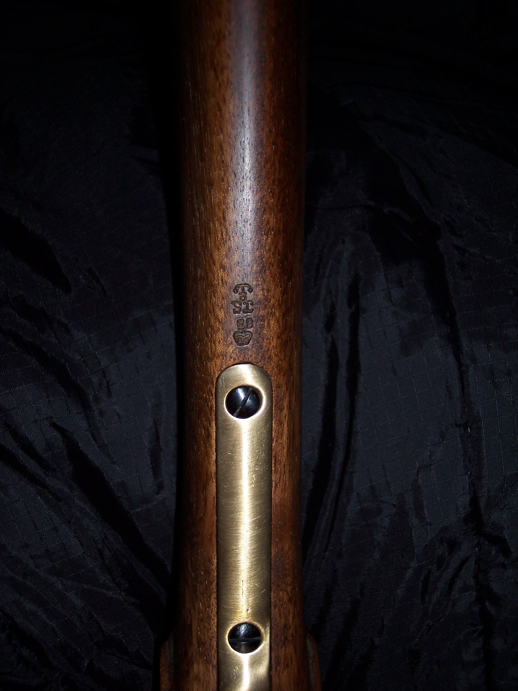

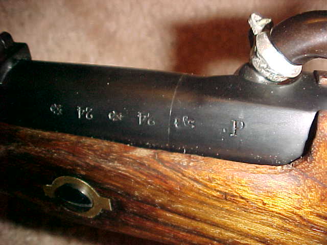

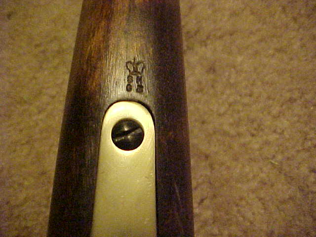

                    Just finished the Shuyler, Hartley & Graham version. Attached are some pics of the more special parts. Just like the original I copied, it has a brass-rivetted nose cap, is dated 1862 over TOWER, and is #3 on the stock SH&G stamp as well as having #3 on the barrel bottom, hammer, lock interior, breech plug back and breech base, and has hand-filed "3-lines" inside the barrel bands, under the butt plate and on top of the trigger guard. The Lock interior has no maker's name as the original didn't either. I copied the inspector's oval and initials as best as I could. I was not sure if it was a P or T there so I guessed it as a P. The rammer channel has a T.TURNER and the barrel maker's initials "J.H" are stamped under the barrel. As with all of mine, the wrist is slimmed na dthe butt narrowed a lot to get it as close as practical to the original contours. Please do critique it so I know your thoughts and whether improvements need to be made that I missed.

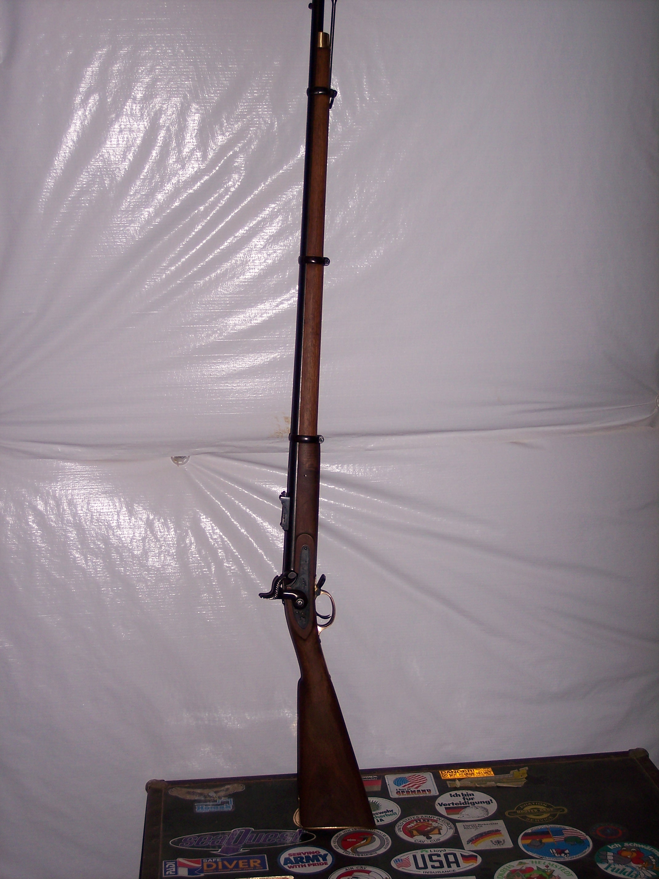

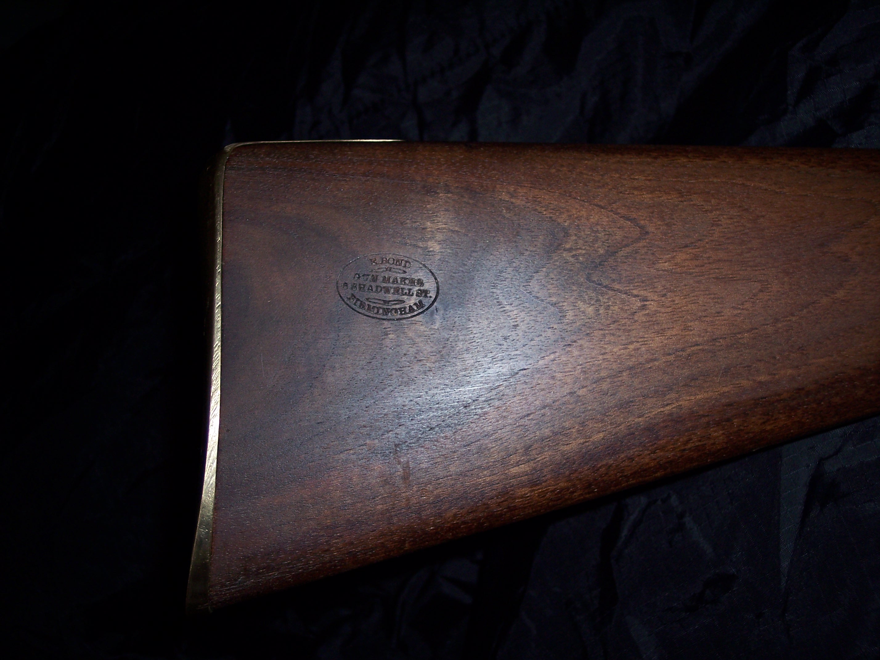

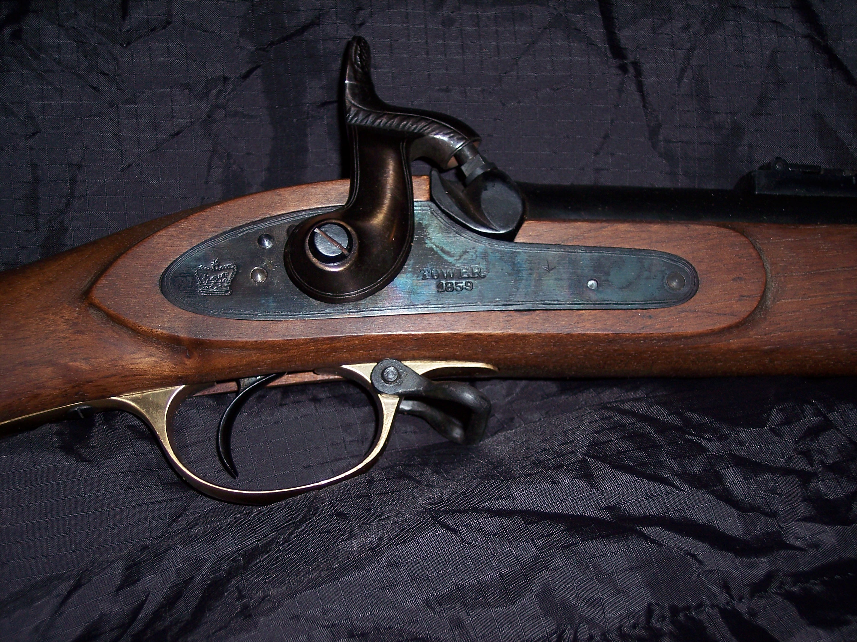

                      I just got my PH Enfield back from Todd yesterday afternoon. I'm pretty pleased with it. My favorite part is the E. Bond cartouche on the stock! It is awesome! I asked Todd if he would put "Tower" over the "1859"; he after checking that it was correct and accomadated me w/my request. Thanks Todd!
                        Re: Massive Todd Watts Enfield Defarb!!!
                        Thanks for the pics! That is quite an improvement over the "out-of-the-box" repro!
