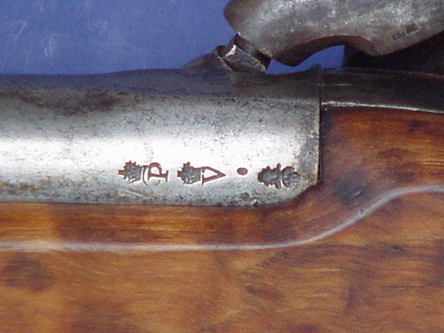

                My enfield was defarbed by James River Armory. Perhaps these pictures may help.
                Brent Conner

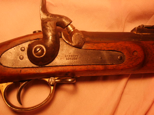

                            Here's my Barnett. I really don't know too much about it,and the lockplate stamping seems atypical. The barrel has Birmingham proofs on it,too.
                            Doug Price
                              Re: Barnett Enfield question, proof marks…
                              Jim,
                              Doug has posted an excellent picture of the faux "machine made" Barnett.
                              Made to appear as if it were the same quality of the London Armory or Enfield made arms, notice the lack of engraving along the edge of the lock or hammer.
