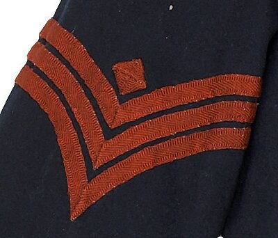

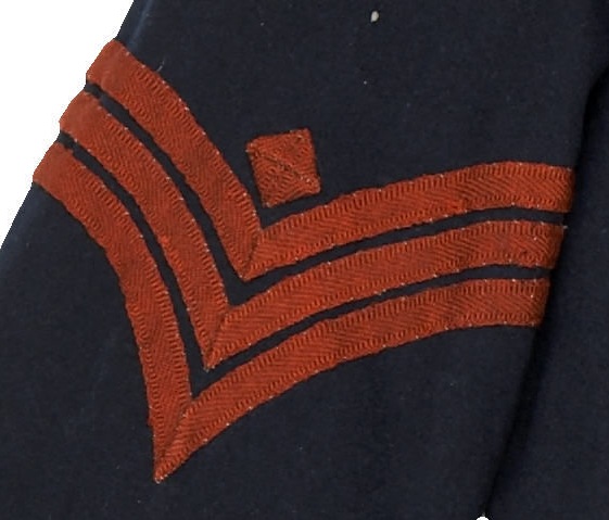

                And to add to the list, the Schuylkill Arsenal contract frock coat from the recent Kurtz Collection. The listing stated, "...hand sewn directly to each sleeve are the three worsted red stripes and lozenge of a first sergeant of artillery."
