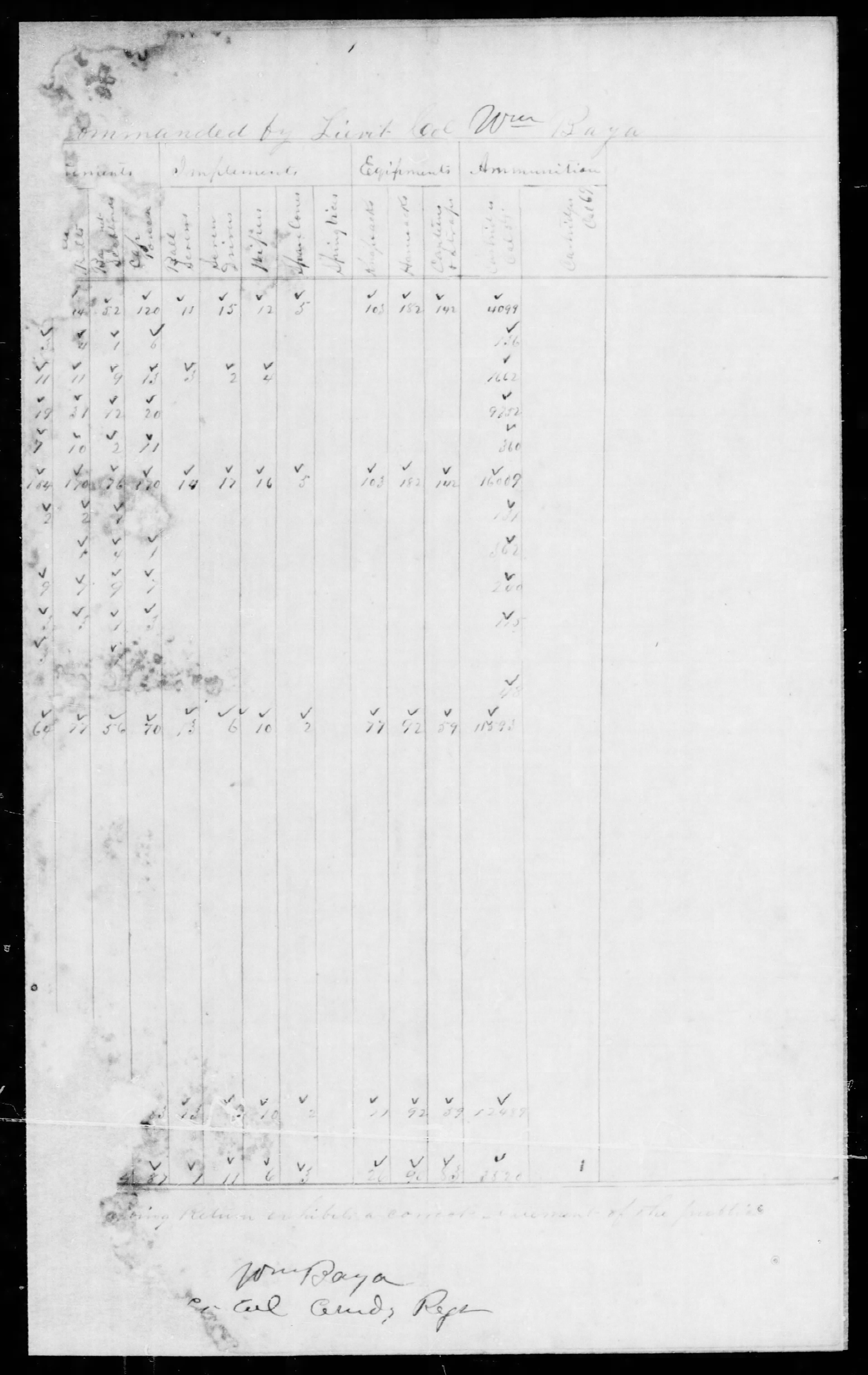

    I have pulled the files from the CMSRs at the National Archives. Obviously they were wearing Richmond issue items once they were up in the ANV and the depot system took effect. But I haven't found anything regarding the weapons they carried. The only references are to .58 cal. Does anyone have anything more specific or any sources for photos of enlisted in uniform?

        Re: Equipping the 8th Florida
        Bryant,
        I'm doing this to help a friend who lives in Florida and is curious about what they really did and not what you see down there in Florida so much....

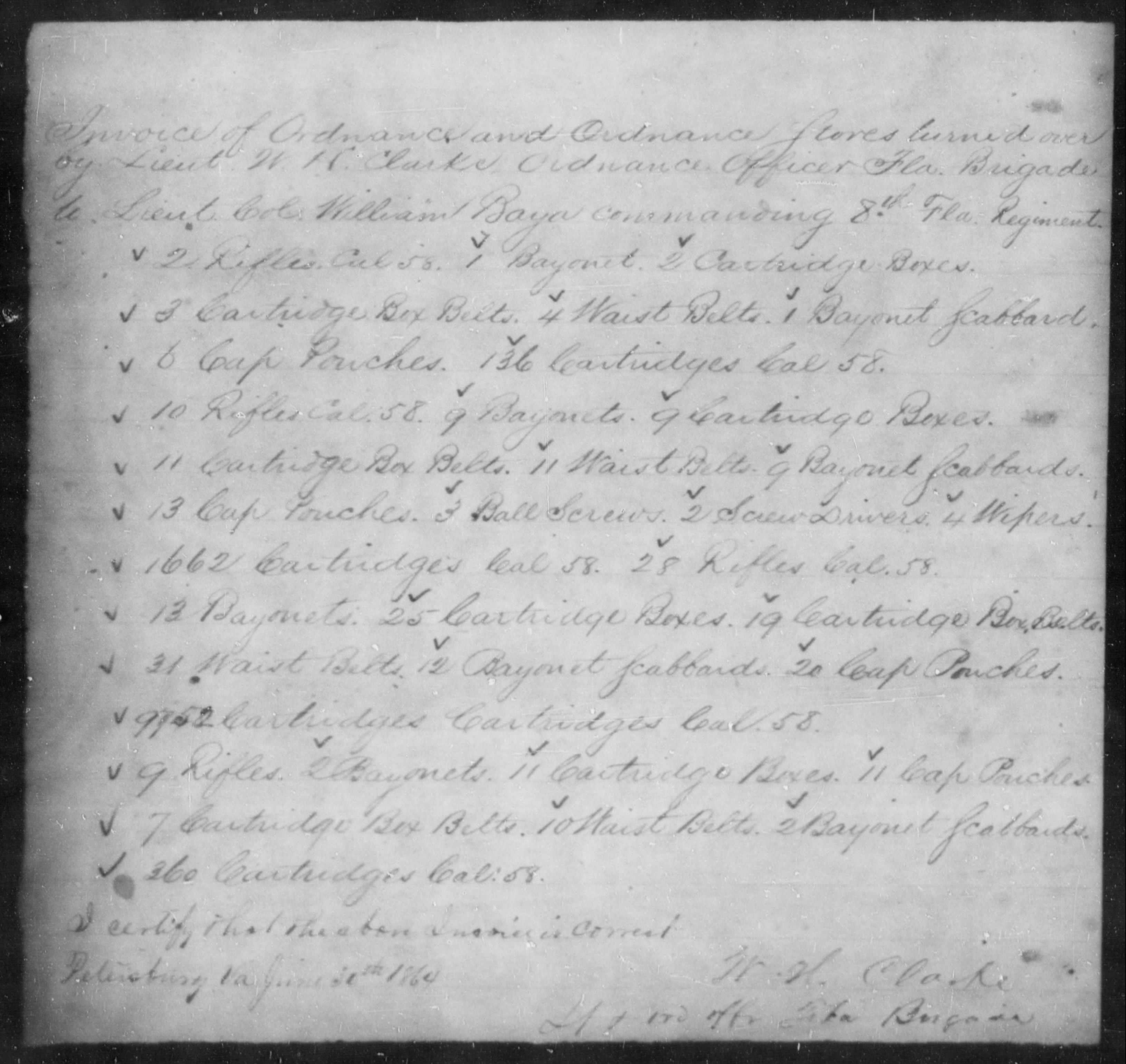

        The dates are '64 for the invoices for .58 cal rifles.
        I have included them below.

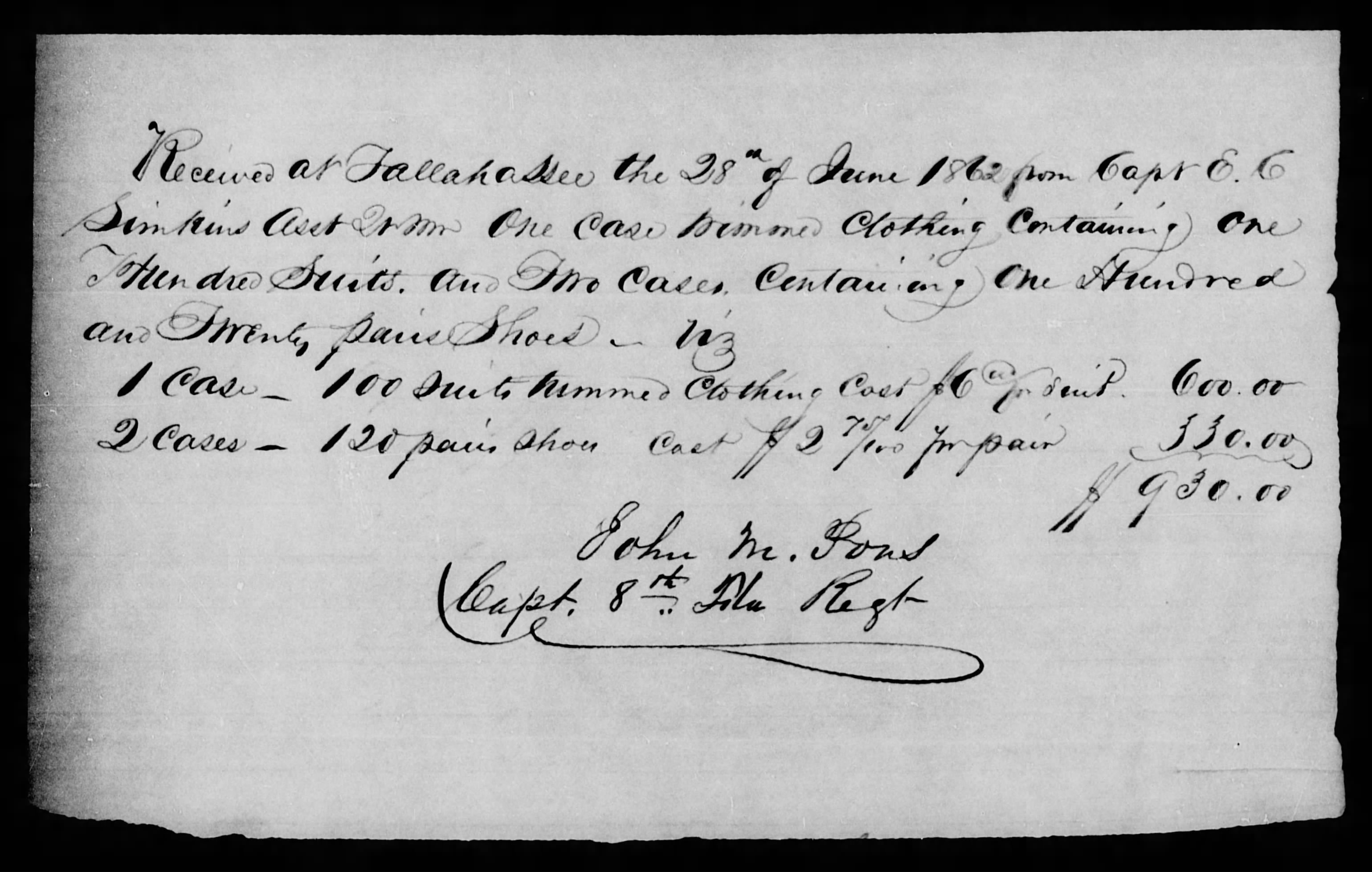

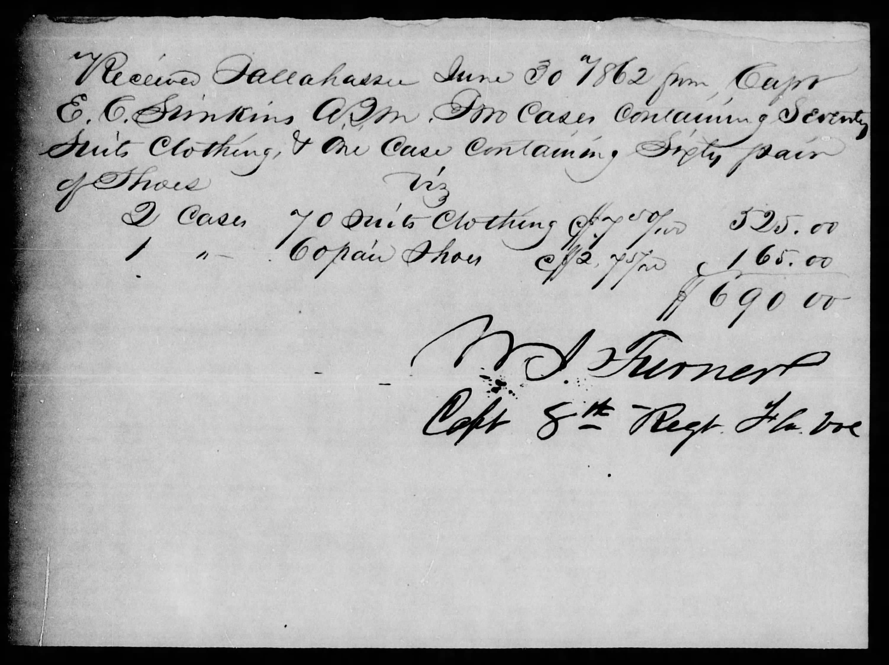

        I have also included one invoice for uniforms typical of many found in June and July '62 in Tallahasee.
          Harry,
          Your guess is as good as mine on the rifles. I'll be home for Easter and will see if I can find the Lang letters, that may be the best bet. It also wouldn't be out of the ordinary for it to be a mix of Enfields, Springfields, and Richmonds. Going on the 10th Florida returns, all but 2 companies had .69s at Olustee, but by the 2nd qtr reports of '64 htey are listed as having ".58 rifles" as well.
          The clothing reciept is from John Pons of company I. wonder if he was purchasing for his company of the reg't??
            Bryant,

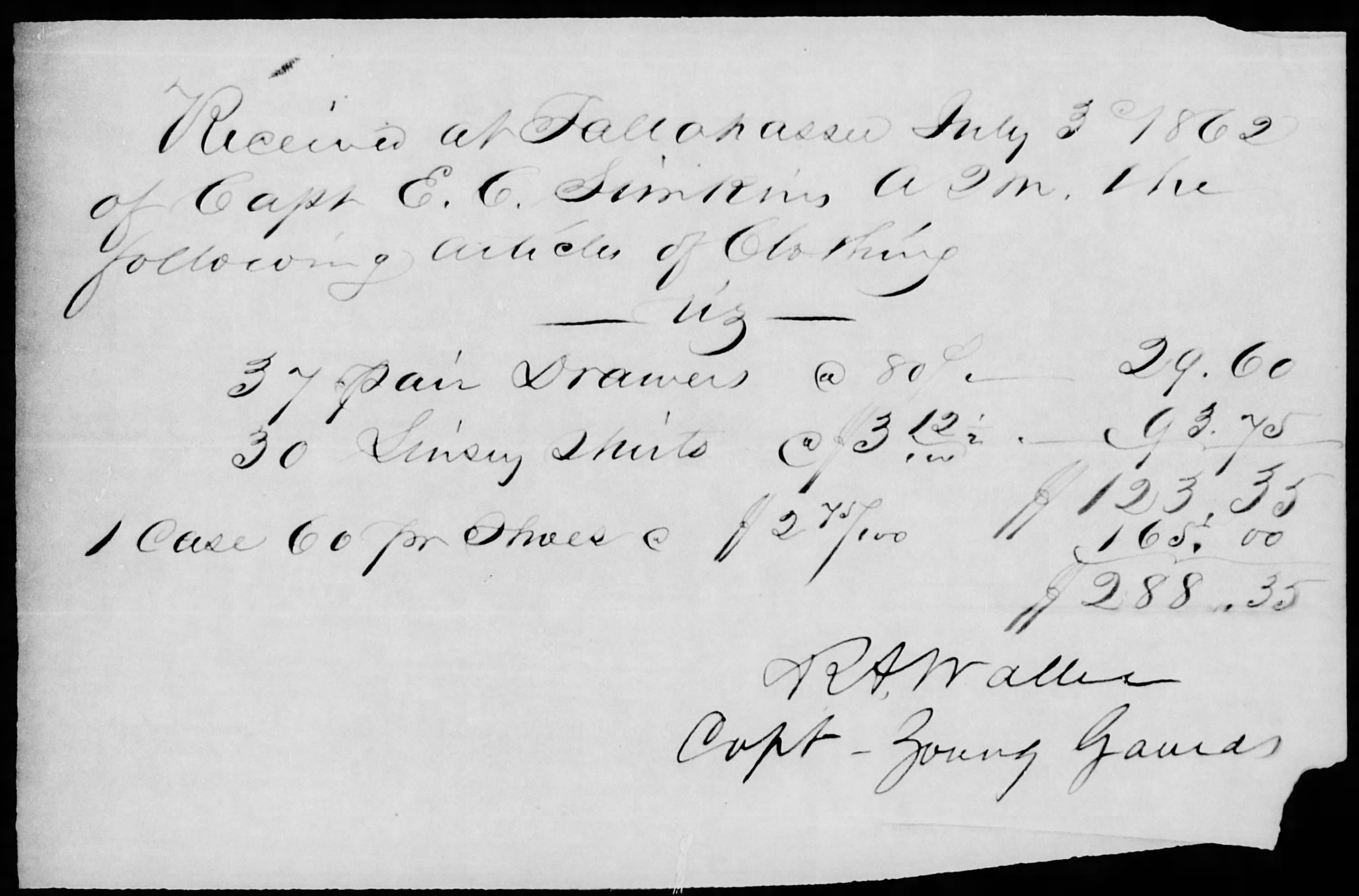

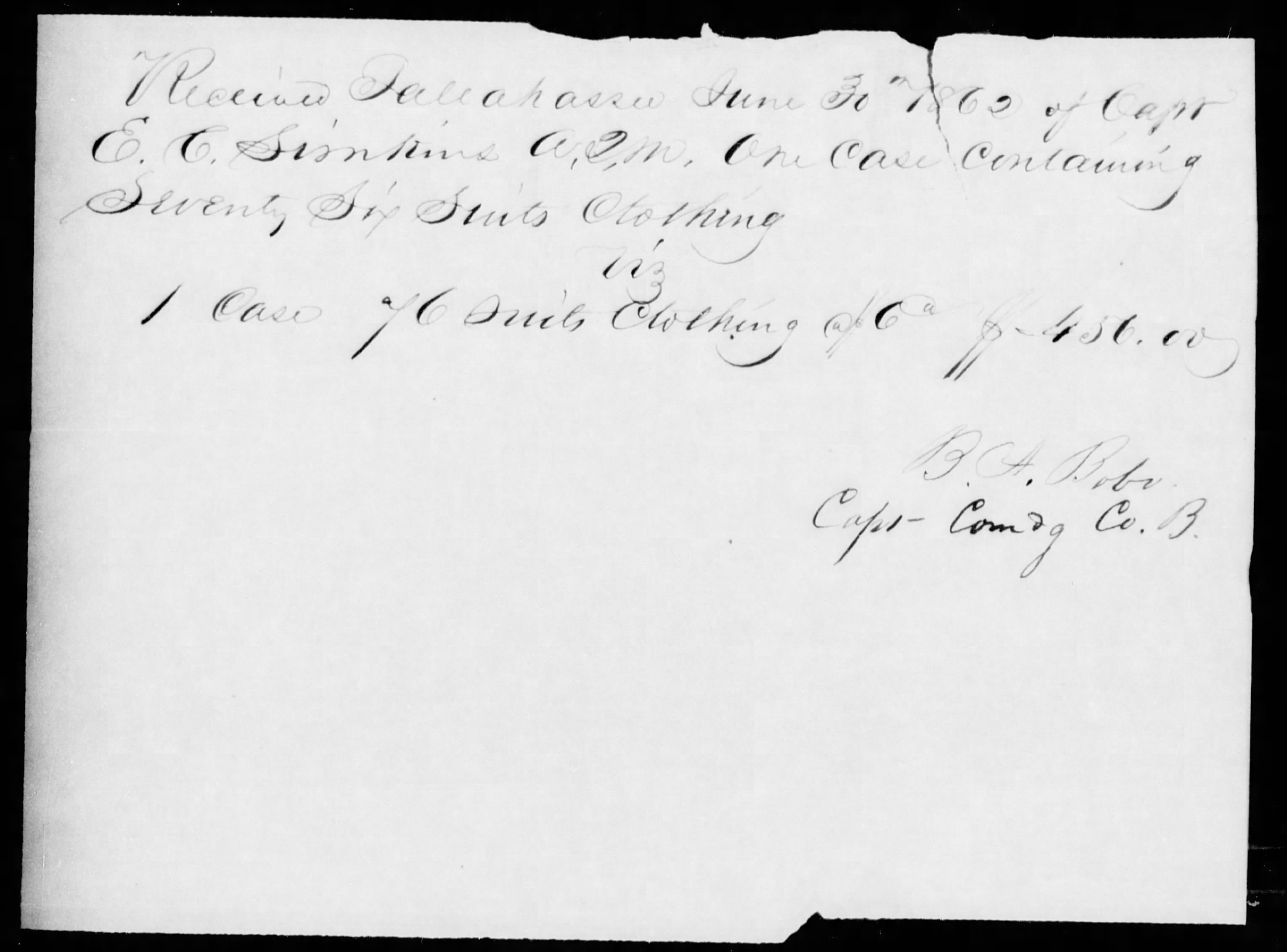

            I am attaching some more invoices from other officers of the 8th Florida showing their invoices similar to Pons. Looks like they were just simple Florida state issues rather than purchases by unit commanders.
            Wish I could see some photos of these uniforms....
