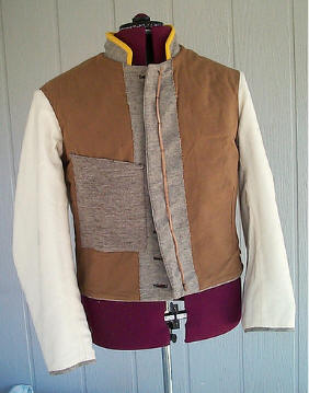

                  Some other clothing items that are notes as being pieced :
                  Page Lamphams trousers, MOC, The one pocket "ear" is pieced ( I believe it is the left hand pocket).
                  The A. Smith Jacket at the Atlanta Hist. Center, The undererarms are pieced up by the arm pit & the one side of where the body meets the collar is pieced ( did survey of this coat back in 1999, very neat jacket).
                  The Jacket at Mansfiled SHS in LA is pieced down one side and features closed up buttonholes on the right front exterior pannel ( did a survey of this jacket in 2002).
                  US Mounted Great Coat capes on occasion are seen pieced on one side or the other due to their length.
                  Some US Dress Frocks have some small amounts of pieceing encounterd along the reenforcement strip that covers the body/skirt seam ( Randall Pierson of San Jose CA pointed this oput to me on a survey he did of an original US Frock &I have noted this on some other I have viewed)
                  It is interesting to note that a good amount of piecing on military garments is kept to the areas of the garment that are usually not seen readily (Facings, Undersleeves, Etc . This is not a hard and fast rule, but a general observation.
                  At any rate....... those vests pictured are Very cool , I especially like the one with the different directions of the warp. It would be neat to see a repop produced showing this.

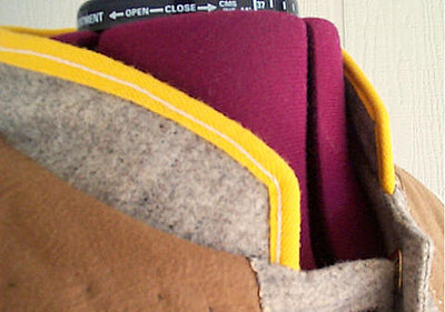

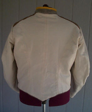

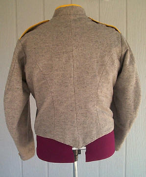

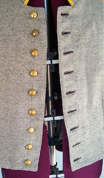

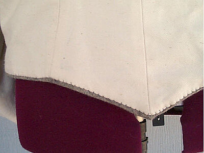

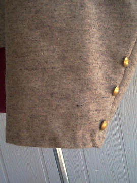

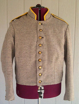

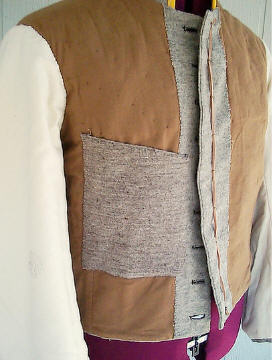

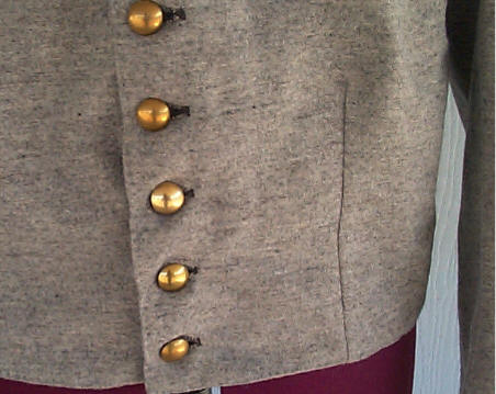

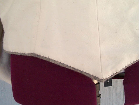

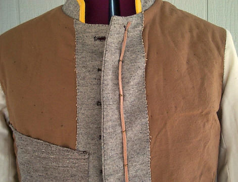

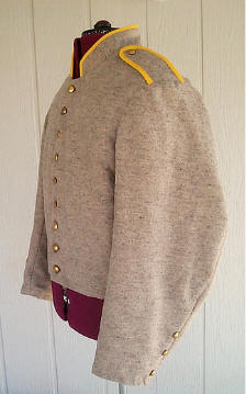

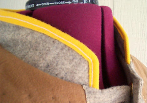

                        The Mansfiled Jacket is simmilar in its oddness in patterning. It has long darts in the body and a very pointed bottom to the back of the jacket , further it is lined in the front with cotton flannel, with the rest in cotton drill. Further the jacket originallhad branch of service tape ( Sky blue woll tape) on the epaulets and collar. The epaulets were cut off and the collar was coverd over with yellow cotton by the soldier when he transfred to the cavalry
                        Here are some pics of a copy of the jacket I made for Bill McKown of TX of the jacket in the original issued configuration with cavalry trim.
