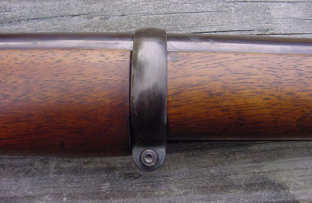

            I have put Armi-sport bands on my 80s vintage Parker-Hale - they fit with little difficulty, but I did reshape the outside a little and heat blued them instead of leaving them case hardened. Also, I did have to cut the threads on the middle screw longer, as I couldn't tighten it properly...probably as the Armi-sport barrel is fatter in the middle.

                I used the Armi Sport lower and mid bands on my early PH. They were fairly easy to fit and look tolerably well. I also reblued them using the cold blue method I also used on the barrel.
