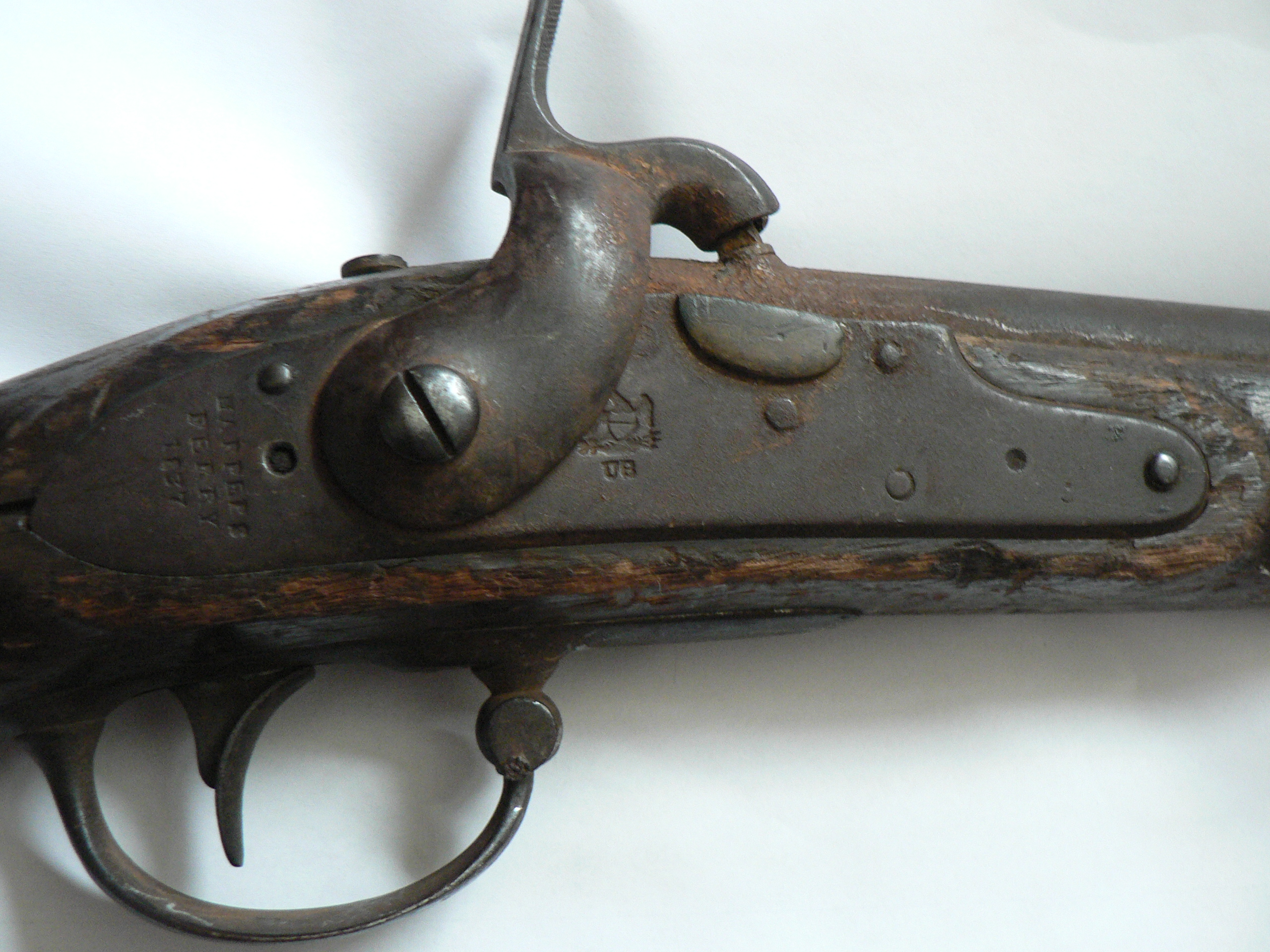

                I know this isn't quite the weapon you're interested in, but it is a conversion from flintlock, the Belgian method I believe. It's a Harper's Ferry 1837, enjoy
