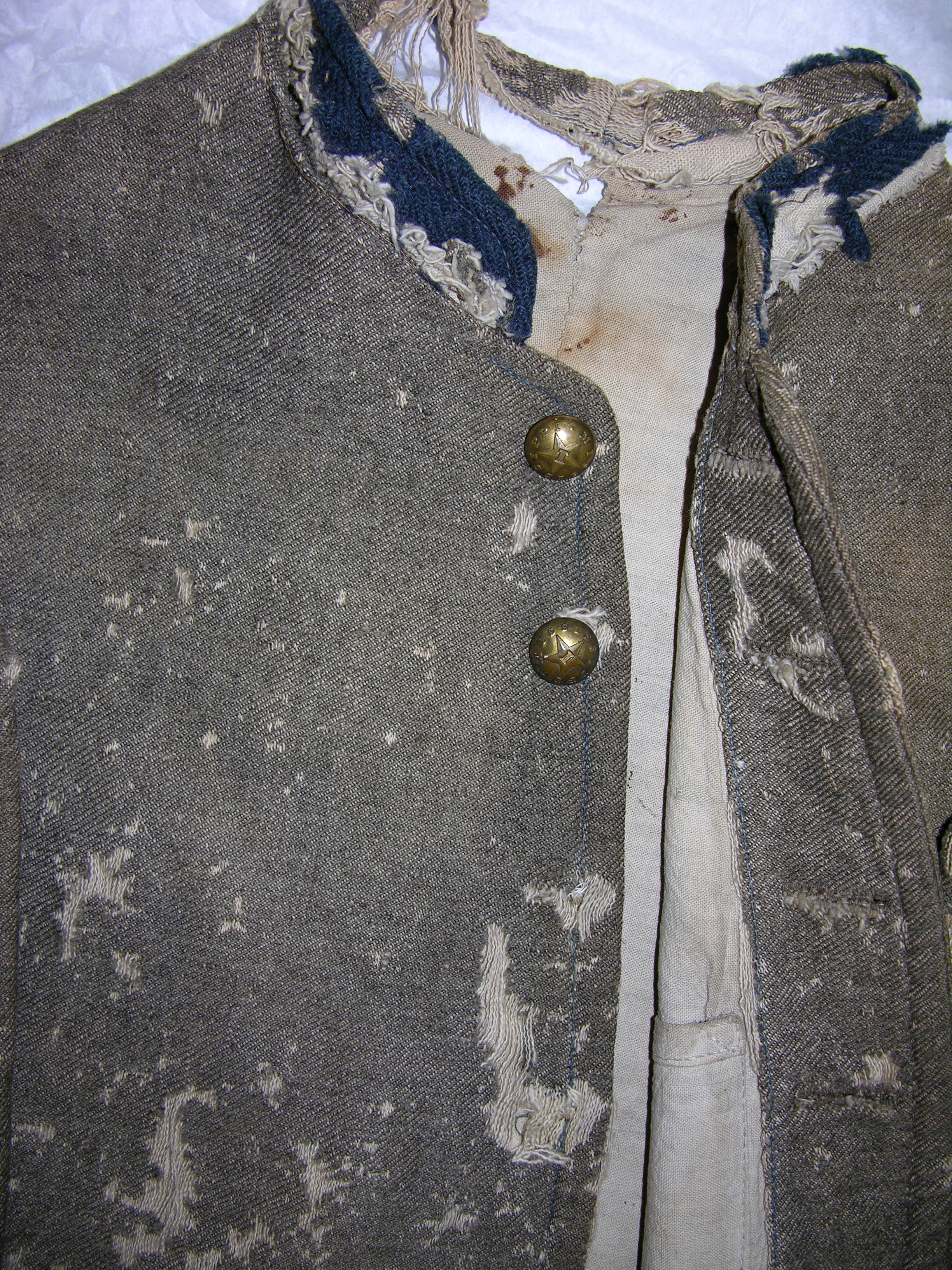

      cool picture! Is that blue swatch the original dye color of the wool? Just curious, as from what else I've read on this post, most are saying it would look something like that.
      I would presume as much. Michael pretty much covered it in regard to oxidation and fade, plus there were scores of diffrent dye lots.
      Here is a nice overall pic of the jacket.

              I would like to thank Matt Caldwell for posting the remarkably detailed pictures of the CD jacket held by the Mississippi State museum at Jackson - commonly known as the "McDonnell" jacket (see further details on earlier link to Geoff Walden's article). Try zooming in on the picture - it's remarkable. You can clearly see the line of blue machine-stitching the jacket is well known for. Matt - any more pictures!?

                Just saw this request. Paul, email me at civilwarhistorian (at) gmail.com and I will send you more images.
