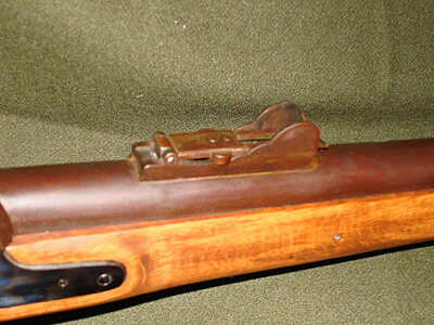

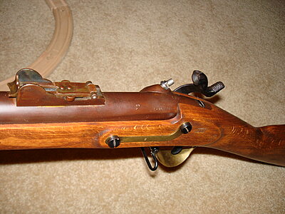

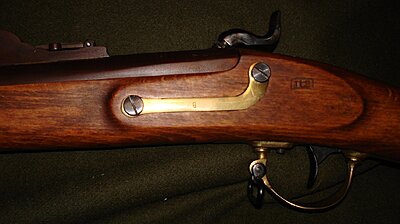

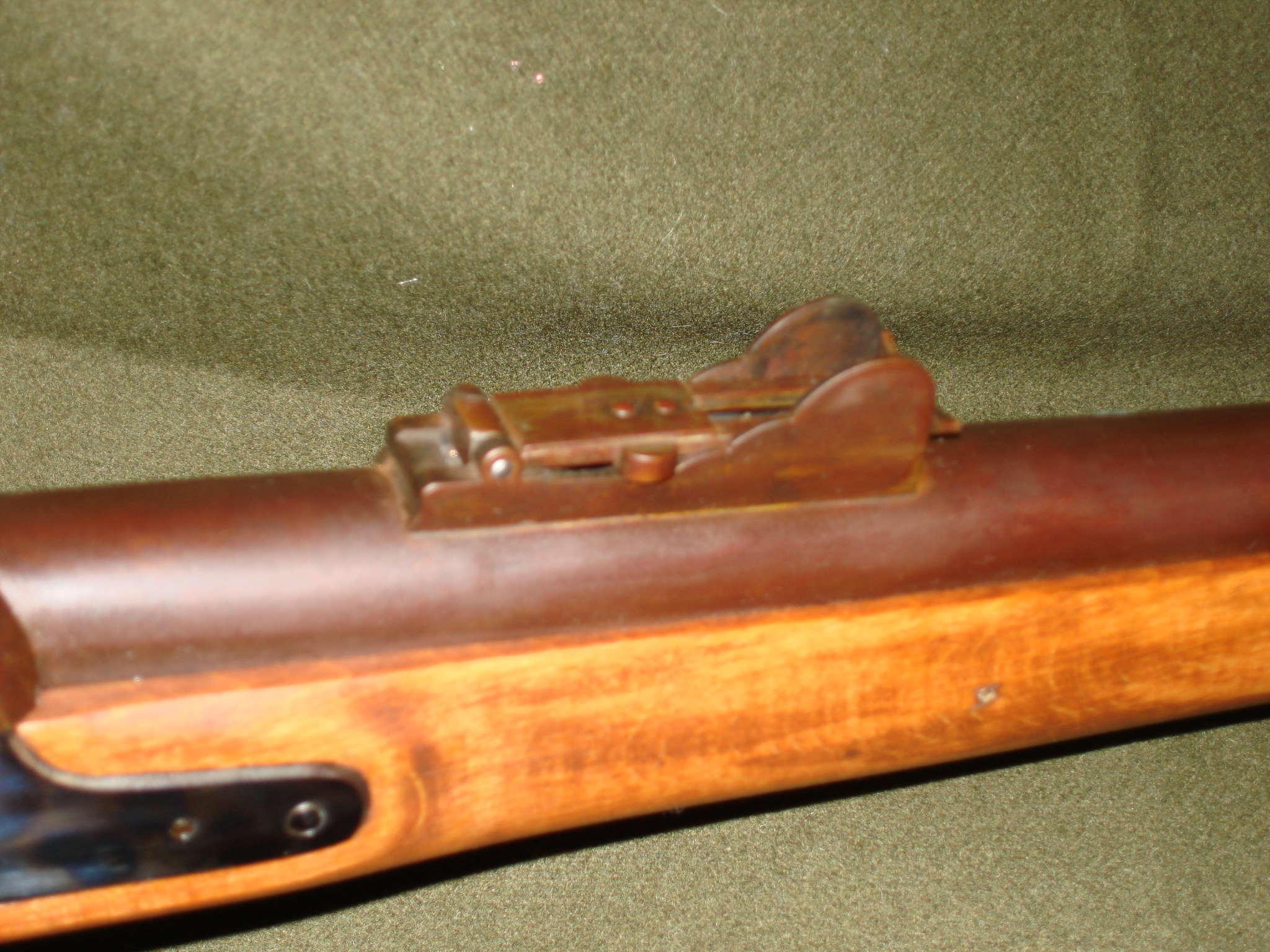

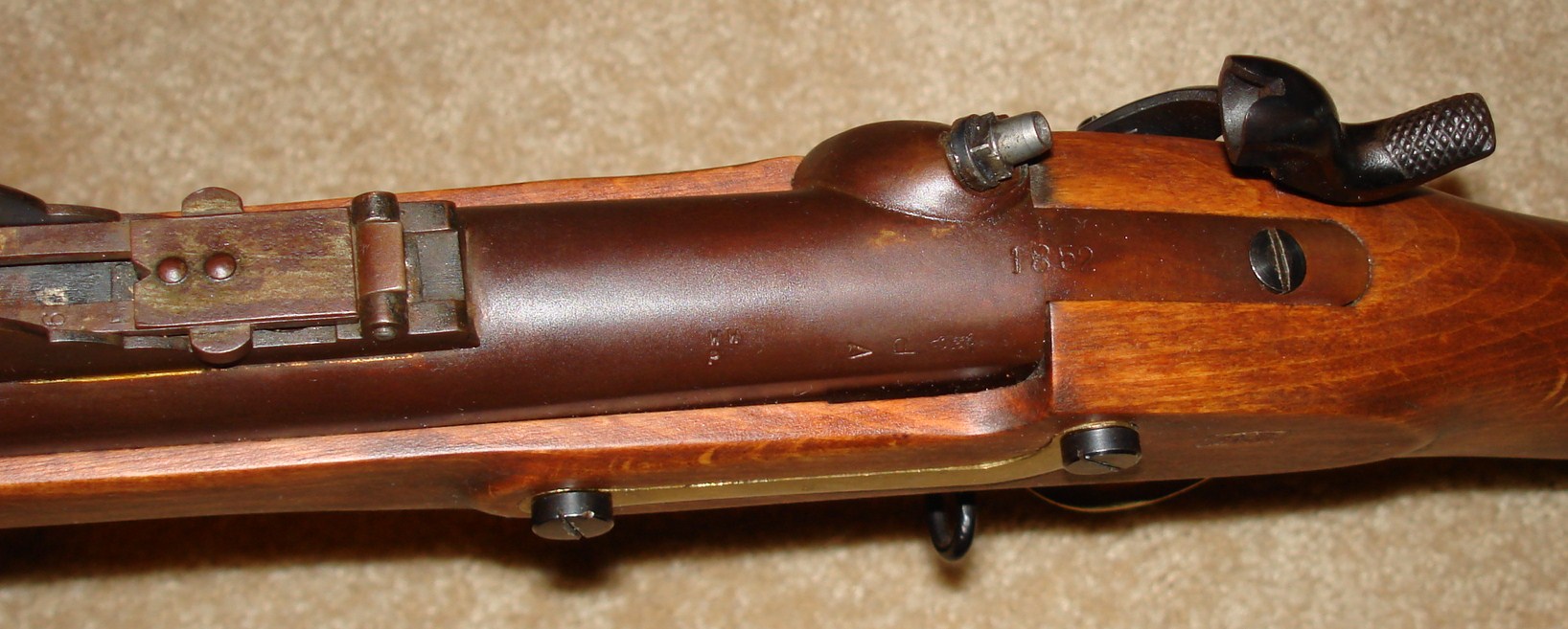

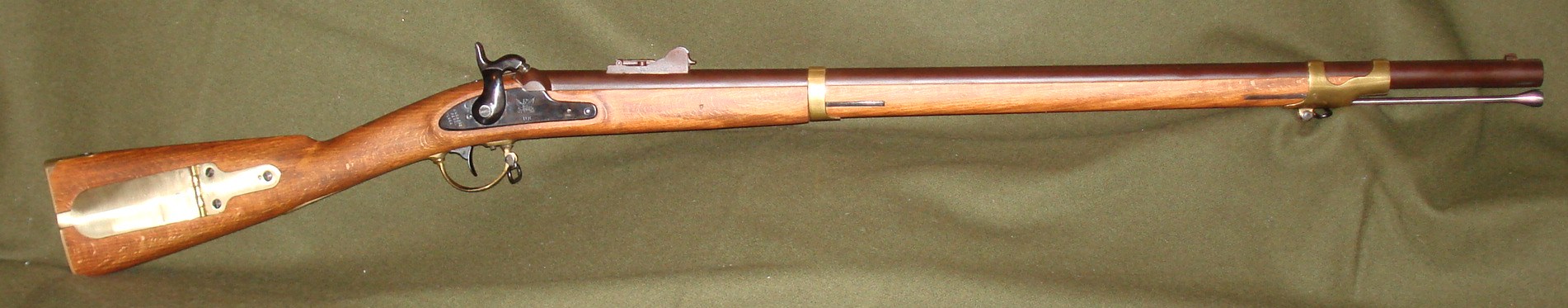

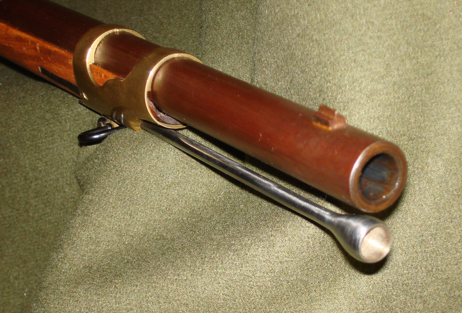

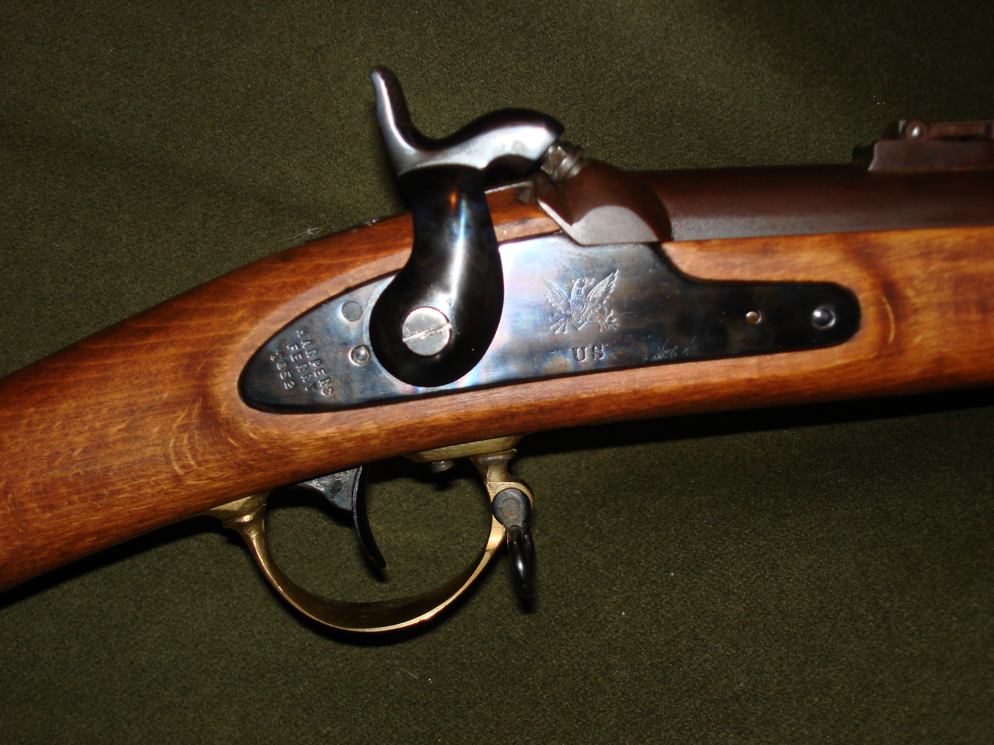

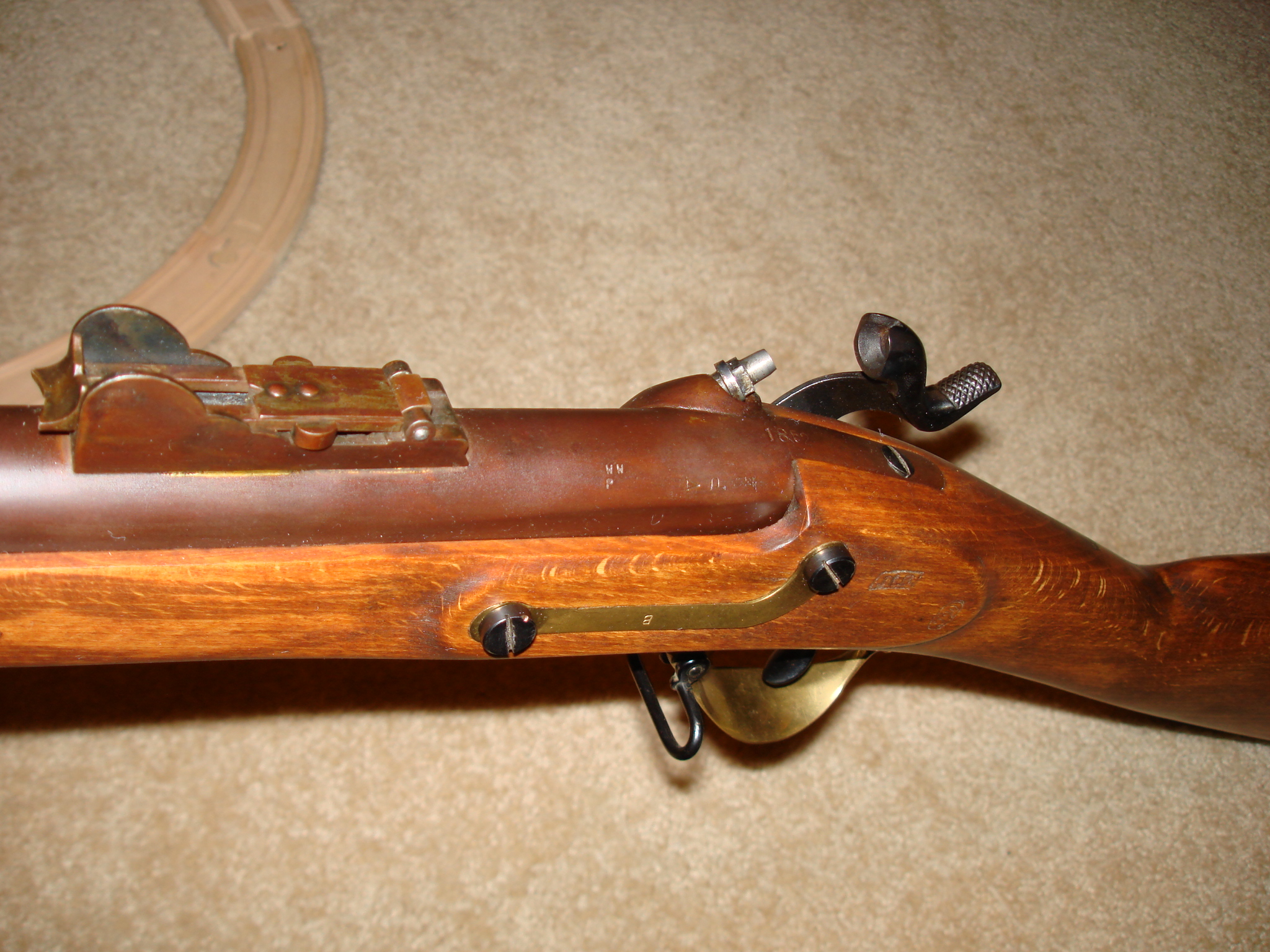

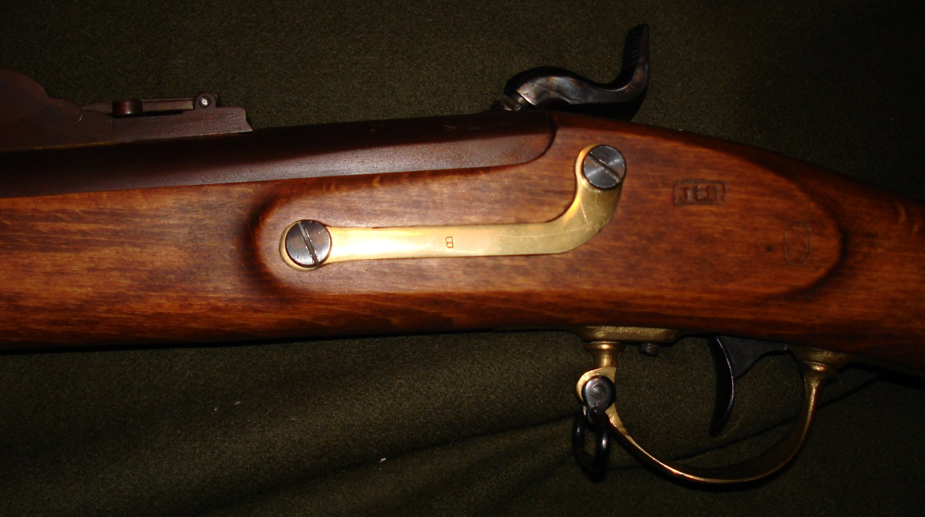

    OK, Craig asked, so here you go...
    Pics of one US M1841 (aka "Mississippi") Rifle, defarbigalated by Mess'r Todd Watts.
    As they say, pictures are worth 1,000 words, so I'll let them do the talking. However, let me say this...
    - The National Armory Brown finish is really great. I've always had a soft spot for this finish over the "National Armory Bright" polished finish.
    - This rifle has the best functioning lock of any Italian repro musket I've ever handled - bar none.
    Enjoy!

          I always say start out with a better rifle (like a Zoli US 1841), and end up with a better de-farbed rifle in the end. Watts has a couple more Zolis and a Bernadelli he will be doing with various makers and configurations. A good case can be made for keeping them simple--it is part of their charm--but that one with the long range sight is just plain easy on the eyes. It has a bit of cosmetic damage to the patch box door as I recall, but not too bad for a thirty year old weapon. Feels good in your hands. Nicely marked as the photos show. Great brown barrel finish, which is built up.
          And yes, the lock function is much better on the A. Zolis than the Euroarms. I did a bit of tuning work on it. The springs are nice for an older gun. I like that one quite a bit. Think you are going to keep it, Wick?

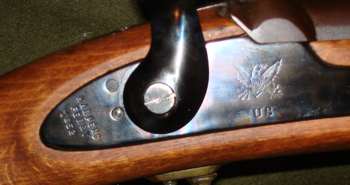

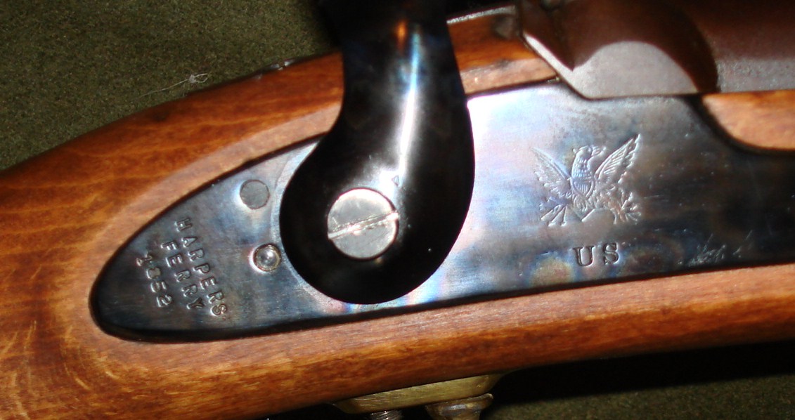

            Just curious... were some original Harpers Ferry stamps in the sans-serif typeface as shown? Images online show stamps from Phila., Whitney ('N. Haven'), and Robins and Lawrence ('Windsor Vt') seem to be a serif typeface, and I did find many Harpers Ferry stamps in serif, but none in sans-serif. Of course these are only a few samples.

              I used alpha-numeric stamps I had on-hand for that one, which are arial font. This was just a test-run project and I will be getting better stamps to handle the MS rifles this year. Personally, my pride with this one was in keeping the stamps so neatly arranged considering I did them by hand. took quite a bit of voo-doo encantations on my part with each stamp to get them that close.;) I should have stamps in a couple of months and be able to start cranking out MS rifles.

                  Awesome about the stamps... and wow, VERY well done for doing each letter individually! That minute detail caught my eye and I had just wondered if it was intentional or for the reason you stated.
                  Either way, fine job on the MS!

                    Really? I did not catch the different font, I thought Todd must have had a stamp made for HF. You did do well keeping the letters in line. Wow. I think Robbins and Lawrence was one stamp being tossed around. Personally, I think Whitney is pretty cool, too.

                      I give great credit to lads who undergo the time and expense of lockplate stamps, especially when one considers that a hardened steel stamp can cost several hundred dollars to have made and the "machinery" to "strike" a uniform and consistent depth stamping can be large and even more expensive than a claw hammer.
                      ESPECIALLY when considering the small "demand" for M1841's!!!
                      (I paid $300 for my HF 1851 dated M1841 stamp.)
                      Stamps can be a study in and of themselves. First because they vary by arsenal and/or contractor (as do the U.S. "eagles" and proof marks), and second because they vary over time as stamps wore out or multiple stamps were in use at the same time or over time.
                      James River offers, or used to offer, several redone Italian M1841 lockplates that included Whitney. (IIRC, I have a Whitney plate on my Colt contract M1841 alteration.)

                        Just curious. What M1841 variant does this defarb represent?

                          I took pics of an original Harpers Ferry variant and copied markings as closely as I could with what I had available on this one. My stamps are Cobalt to allow long-life on case-hardened parts like lockplates and sears. It is not cost effective to have a stamp made for 1-2 guns though so I have to use other stamps and my hand-gravers to mimic others. Browing like that takes a few days to accomplish which means the MS rifle will be slower than the Enfield and a lot slower than the Springfields, but I am looking forward to doing some of them. I'm in the process now of getting stamps drawn and measured to be sent to the shop for pricing (dreaded gulp) and then decide which I have to have and which I can do without for a while.
