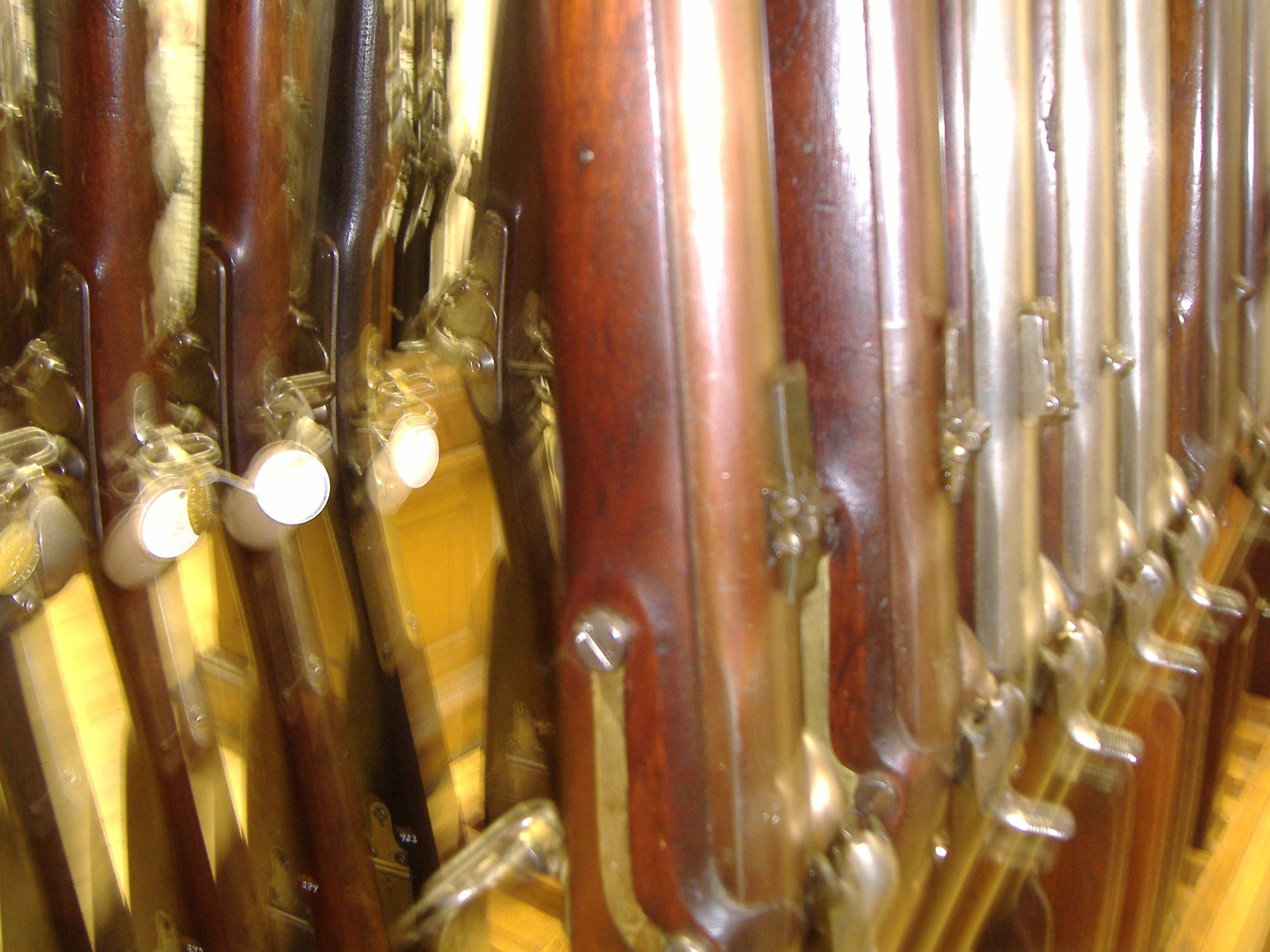

            • Re: A Mississippi Rifle by Todd Watts
              I regret that the attached image is somewhat fuzzy, but it shows a few of the M1841 Rifles in collection storage at the Springfield Armory museum. I took this picture a few years ago when leading a tour there. Note the two with the Colt Revolving Rifle rear sights.

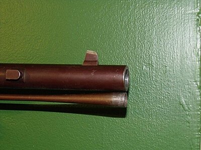

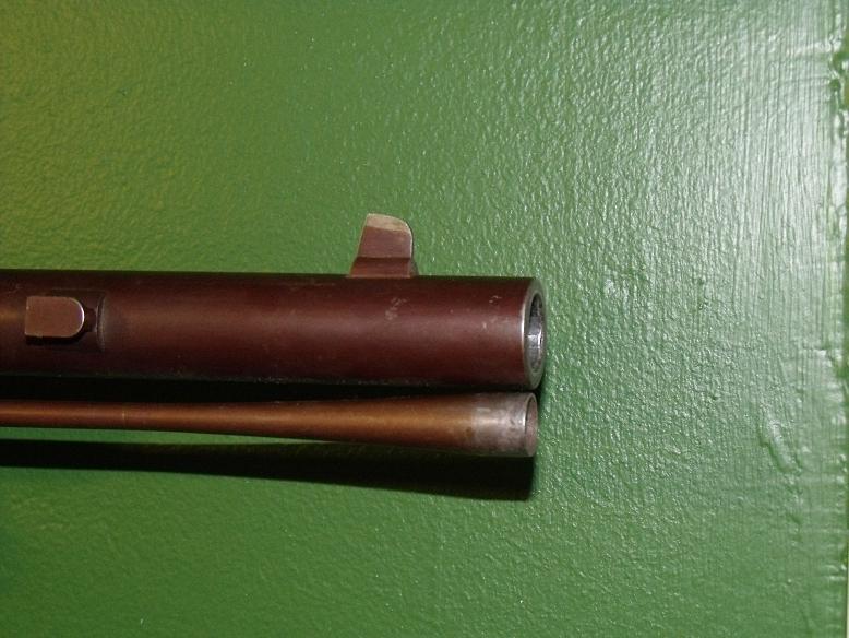

                    Howdy Fellas,
                    Need a little advice here. I FINALLY (after three years) scored the Garrett M1841 rifle of my dreams and it arrived yesterday. Beautiful piece (especially for its age) but as you can see the front sight (I think) is a so-called "skirmisher model" from one of our N-SSA brethren, and not at all authentic.
                    So if I am correct and this front sight is not right what should I do to correct it? File it down to a smaller leaf sight? If so, does anyone know the correct height of the leaf? Since when I received the rifle the front sight was painted neon pink I won't be surprised if there's nothing correct about it, but certainly this is an issue that I want to deal with as soon as possible.
                    Also, enjoy the picture of the rifle reunited with its Garrett brothers!
                      Dan,
                      File it down and re-brown it.
                      The sight base is fine, just the blade needs to be thinned and taken down a bit.
                        Dan,
                        Your M-1841 Rifle is what is called the "D" type variant. The front sight is correct for this variant.
                        If you file it down it will no longer be sighted in for 50 and 100 yards
                          Also, for some of the HF arsenal type alterations, when they added the M1855 early long range rear sight or the later short range rear sight,
                          the 5/16th inch long simple brass blade front sight was replaced with a M1855 Rifle Musket front sight.
                          (Some of the early alterations with the Mississippi sword bayonet lug with the guide rail left the M1841 brass sight intact.)
                            Thanks for the tip Blair. I will leave it be (though I still stand behind removing the neon pink paint...)

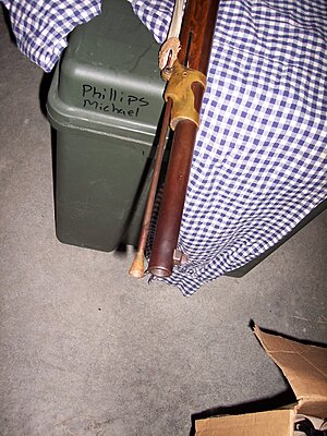

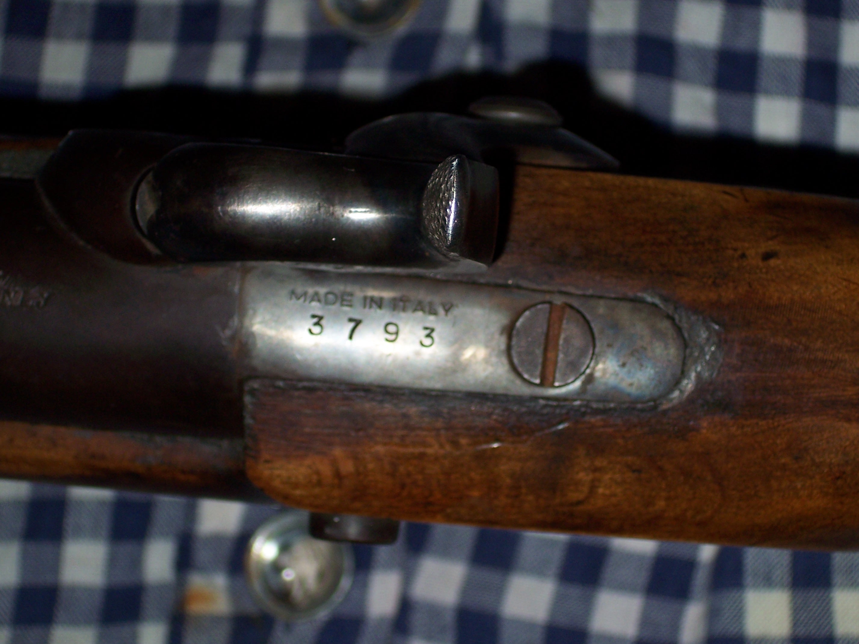

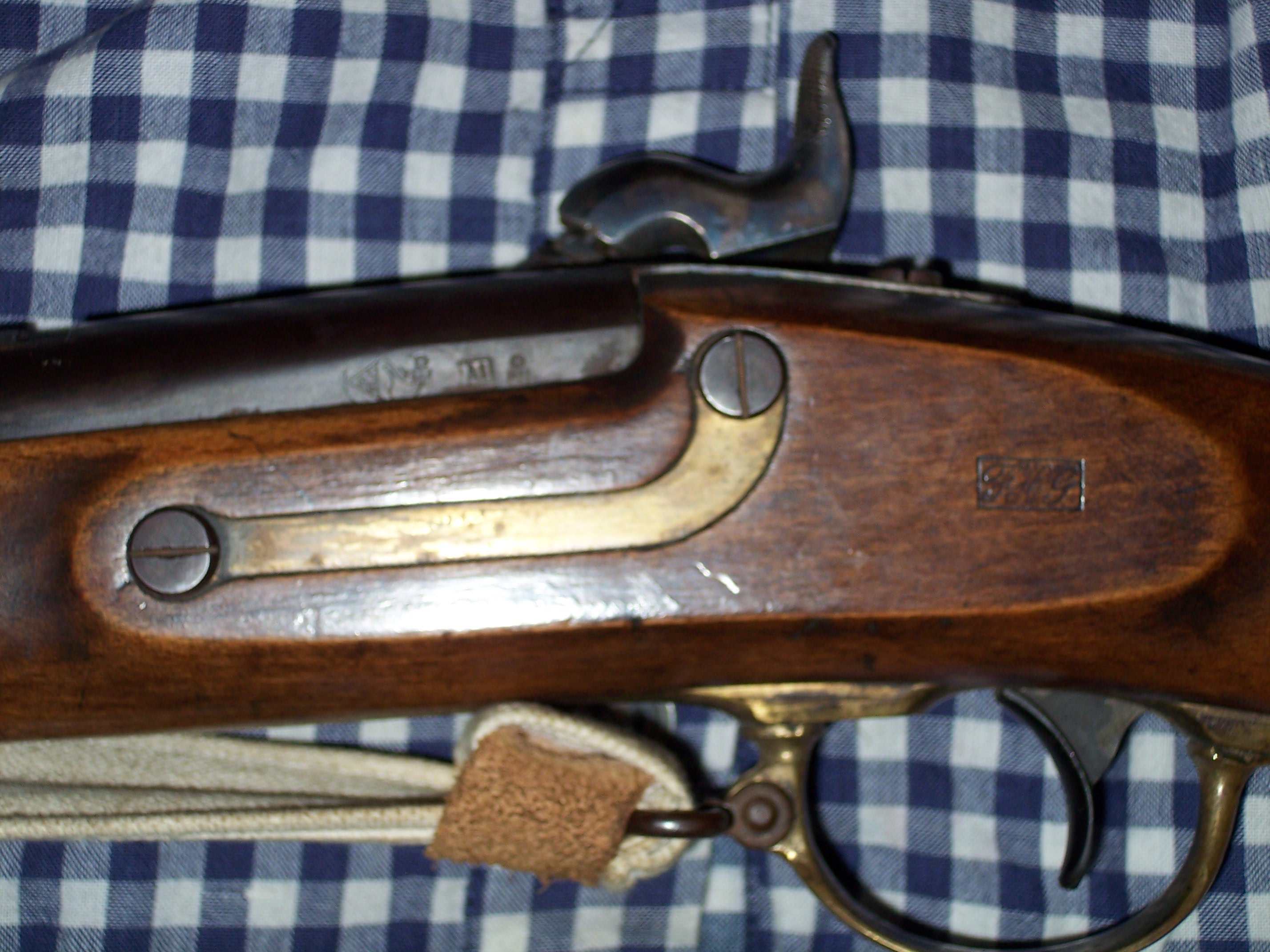

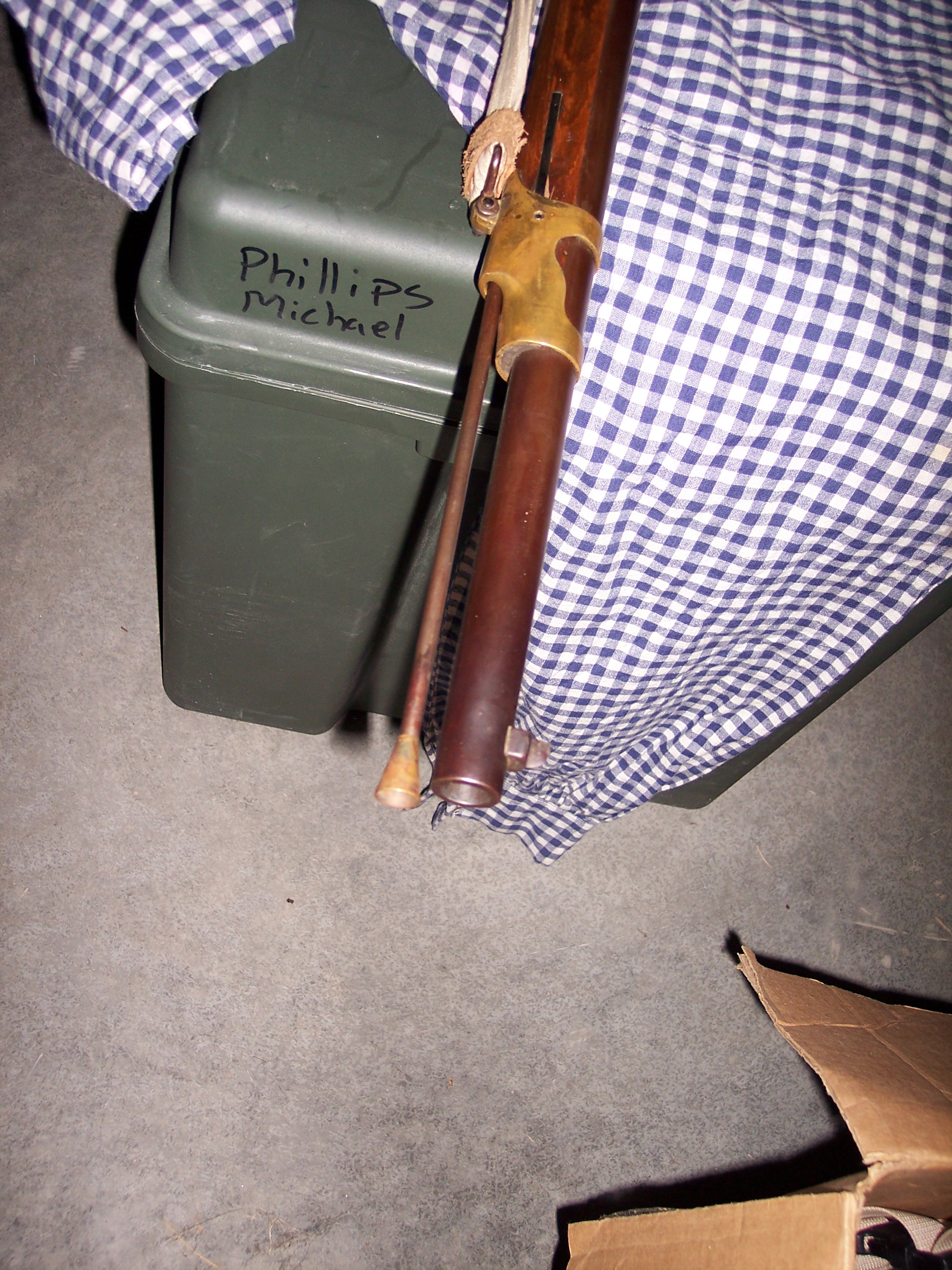

                              Dan,

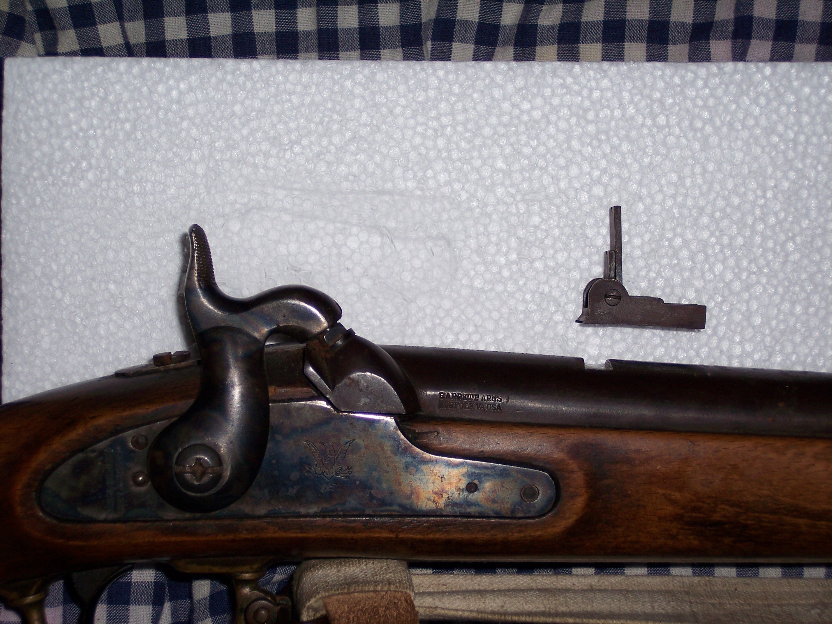

                              glad to see you have your Garrett M1841! Can you or anybody else give me some more background on my "$200 score from a local pawn shop" Garrett M1841. The rear sight was super glued when I got it. The front sight just looks down right to big.
                                Dan,
                                Finger nail polish remover or acetone should take care of the pink paint.
                                The "D" variant '41 has these features,
                                D variant type I, reas sight is brazed to the barrel 2.50 inches from the breech of the barrel
                                D variant type II, rear sight is half/dovetailed to the barrel 2.875 inches from the breech of the barrel
                                Short double strap front band
                                1855 Rifle front sight
                                1855 Rifle bayonet lug
                                All steel ramrod
                                Michael,
                                You should replace the 1861 type rear sight you now have with the 1858 type. Which is correct rear sight for the '41 alteration.
                                The front sight (from what I can see in the photo) looks to be one used for the Rifle Musket bayonet lug front sight. It does appear a little oversized and a bit too close to the muzzle.
                                This type front sight was used on the "Drake" variant type '41's. The barrel on these were turned down to accommodate the '55 Rifle Musket socket bayonet. There is also a "Drake" variant that is addapted for the '42 bayonet with the bayonet locking lug on the bottom of the barrel. The front sight is very different, it is placed on the front strap of the front band like on '42's. Very rear variant!
                                If you keep the "long" double strape front band, you should go back to using the brass blade front sight.
