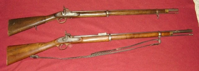

        On a side note, there was an Enfield "sergeant's fusil" which was identical to 1853 but had a 33" barrel and had the butt mounted sling swivel. It was Designed for a socket bayonet. At least 3 known "G" marked examples, I believe Jim Mayo has an original. Click image for larger version

          Re: 2 Band Enfield Bayonets
          Originally posted by pipthelimey View Post
          On a side note, there was an Enfield "sergeant's fusil" which was identical to 1853 but had a 33" barrel and had the butt mounted sling swivel. It was Designed for a socket bayonet. At least 3 known "G" marked examples, I believe Jim Mayo has an original. [ATTACH=CONFIG]48669[/ATTACH]

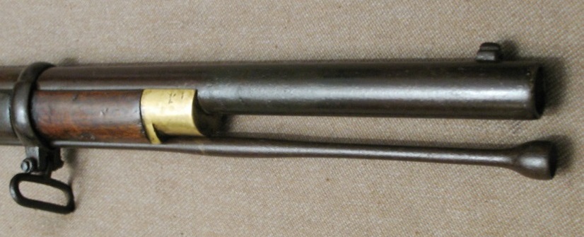

          Andrew: Upon close examination I found evidence of a lug attachment. It's really hard to see and you have to know exactly where to look and get the light just right.Click image for larger version

          Jim Mayo
            We are talking about the rifled P56 "Sergeants' Fusil."
            It did take an 18 inch socket bayonet.
            On July 27, 1857, 10,000 were ordered from the Birmingham makers. They went to sergeants of ''native regiments" in India and by March 1858 8,198 were delivered. Due to shifting circumstances in India no further contracts were given., and the balance of 1,802 were delivered into store by the end of March 1859.
            As part of the "policy" not to differentiate the outward appearance in arms between British and "native" infantry regiments but have the Indian regiments armed with inferior arms- there was also a smoothbore version of the P58 Sergeants Fusil authorized in December of 1858. In January 1859 an order was placed 4,034 with London makers and another 12,966 with Birmingham makers.
            Field use of the smoothbore fusil proved the barrel to be too weak, and in April 1865 a new pattern with a thicker barrel wall was ordered to be made at Enfield.
            Both the (Indian service) rifled P56 Sergeants Fusil and the P58 smoothbore Sergeants Fusil are considered small numbers and not significant so they NUG, typically, do not make it into Enfield reference books too much.
            The Indian Sergeants' Fusil mounted an 18 inch socket bayonet
