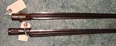

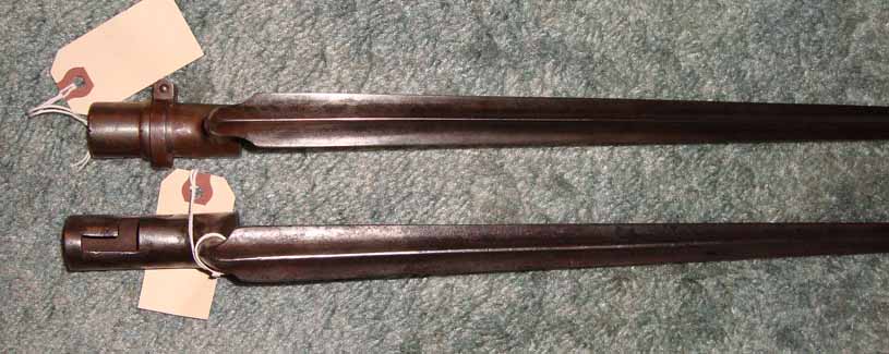

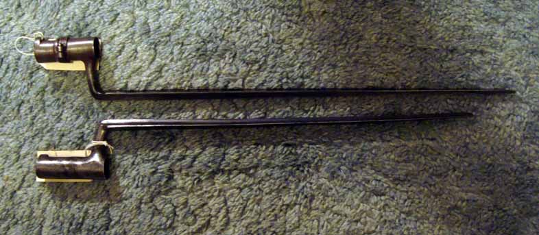

      Re: Original Vs Reproduction Sized Scabbards
      M1816:
      Blade length: 16"
      Socket length: 3"
      Blade width: 1"
      Shank length: 1 1/4" +/-
      Socket front OD, 1 1/16"
      Socket front ID: 27/32"
      Barrel stud: Top
      However there are variants with slightly varying dimensions as well as shape of the stud slot.
      There are also the M1816 for the Maynard Remington conversions with the main variation being an 18" blade.
      M1842:
      Blade length: 18"
      Socket length: 2 5/8"
      Blade width: 1"
      Shank length: 1 1/2"
      Socket front OD, 31/32"
      Barrel stud: Bottom
      Indian and Pakistani Reproduction bayonets will/may vary by bayonet, as they are "hand made" according to the skills and discipline of the workers.
