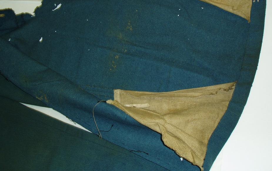

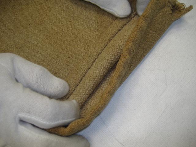

      Occasionally a partial lining/reinforcement above the hem, but I don't believe I've ever seen anything more than that on surviving C.S. enlisted trousers. Going through some notes from pieces I've looked at, it seems that the raw bottom edges of some jeans/cassimere trousers were simply turned up and stitched, others exhibit the extra fold to turn under that raw edge. Kersey enlisted trousers seem to almost always simply have the raw edge turned up and stitched.
      Not sure if we can specifically ID a single specific pattern of pants to the Richmond Clothing Bureau, but if I remember correctly the kersey pair pictured has ANV provenience.
      -Craig Schneider

        Re: Richmond Depot trouser hems
        Ken and Craig,
        Thanks for the photos... that's exactly what I was looking for.
