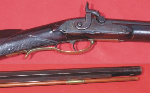

    This replica rifle started out as a used "Hawken" I bought from a neighbor a few months ago. First, I re-contoured the stock to make it less "St. Louis" and more Burks County, PA, polished and stained. Next, I replaced the modern rear sight and cut a new dovetail slot to move the front sight three inches back. The bluing was removed from the barrel and lock and replaced by browning. The most important change was grinding the muzzle down and adding a lug under the muzzle to fit a Model 1835 US Bayonet. This was copied from one dug at Shiloh and a few others that have survived in museums and private collections. This should be a good rifle for 1861 events, or for a 1864 Georgia Militiaman, for example.

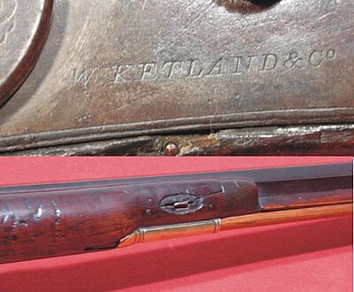

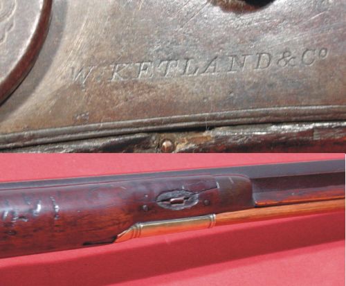

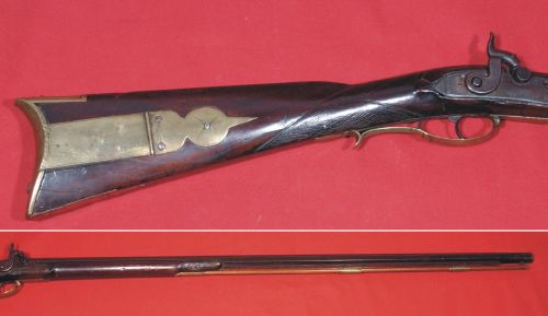

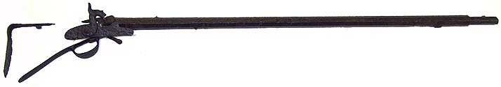

        Here are images of militarized country rifles. The rusty one without the stock was dug near Shiloh.
        The rear sight I used to replace the stock replica version is a hand-made, period sight. It's been a long time since I served for three years as a young officer in Germany, so my Deutsch fails me. Where is the pistonsocket on a muzzle loading weapon?

          Re: "Militarized" Country Rifle
          In Flayderman's, Chapter XI, Secondary Military Longarms, pg. 486 (in my 5th Edition),
          He shows and describes a "South Carolina Contract Flintlock Military Rifle".
          These were civilian type Sporting/Country rifles. They could be full stock and half stocked, flint and/or percussion (many being altered to percussion). They usually had their octagon barrels turned round at the muzzle so they could be fitted for socket bayonets to make them more serviceable as Military firearms.
          I have always heard and known these types of firearms as "Nullification Rifles". During the Nullification movement of the 1830's somewhat large numbers of such firearms were purchased and modified in this manner by the State of South Carolina. To a lesser degree, parts Georgia and North Carolina were caught up in this movement as well.

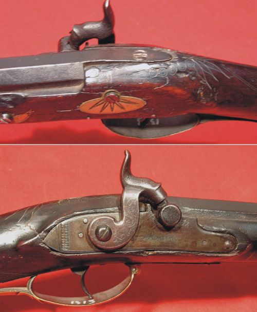

            O.k. my fault, I mean the nipplesocket.(Is it the right term ? ) On an original Hawken it is very complex made, and badly echoed on the Replika.
            Or can you take a new Photo from this area ? The weapon looks like an Investarms- Hawken, Maybe I am wrong
              Charles,
              I think I understand what you are referring to.
              In this Country, we refer to this type of breeching system as a "Hooked Breech".
              The barrel and bolster (contain the nipple bolster seat area) are assembled (breeched) as on piece. The tang section is a separate piece and remains attached to the shock.
              This type of arrangement are found most often in civilian Sporting firearms, Rifles, Fowler's, and Side by Side muzzle loading shot guns. They can date back to the end of the 18th Century in this Country.
              It was intended for being able to dismount the barrel (s) for ease of cleaning.
              I hope you find this info helpful,
                Blair,
                thats what I mean, thank you for your post !!!!!
