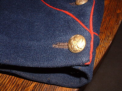

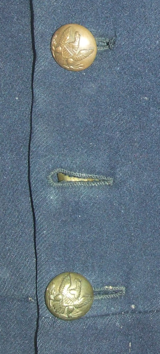

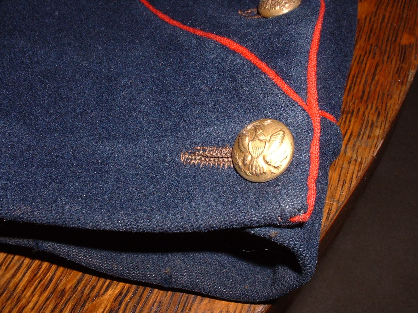

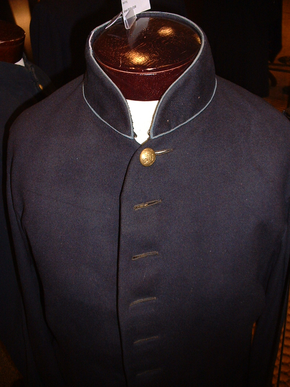

                  Here are some photos for you John. I wish the quality was better on some of these!
                  Infantry Frock, Ross Co. Historical Society: Unknown manufacture, black silk keyhole buttonholes with black silk gimp.
                  Infantry Frock, former John Henry Kurtz Collection: Unknown manufacture, black silk keyhole buttonholes.
                  Heavy Artillery Frock, private collection: Schuylkill Arsenal marked, logwood-dyed linen keyhole buttonholes with logwood-dyed linen gimp.
                  The majority of original frocks I've seen were made by Schuylkill Arsenal and interestingly, the majority of these had somewhat crudely worked buttonholes in logwood-dyed thread. The rest had black silk buttonholes. Styles of buttonholes in all frocks examined were: keyhole w/bartack; straight w/one bartack; straight w/two bartacks; straight without bartack.
