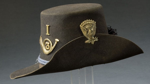

    This is a photo of an original that went to auction a while ago. It appears looped on the left. Who can say when exactly that was done as many of these "relics" were dressed and assembled with hat brass to make them more profitable for the relic dealer.
