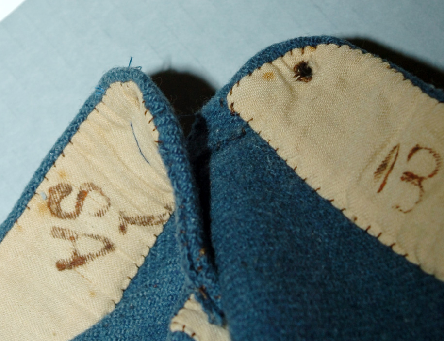

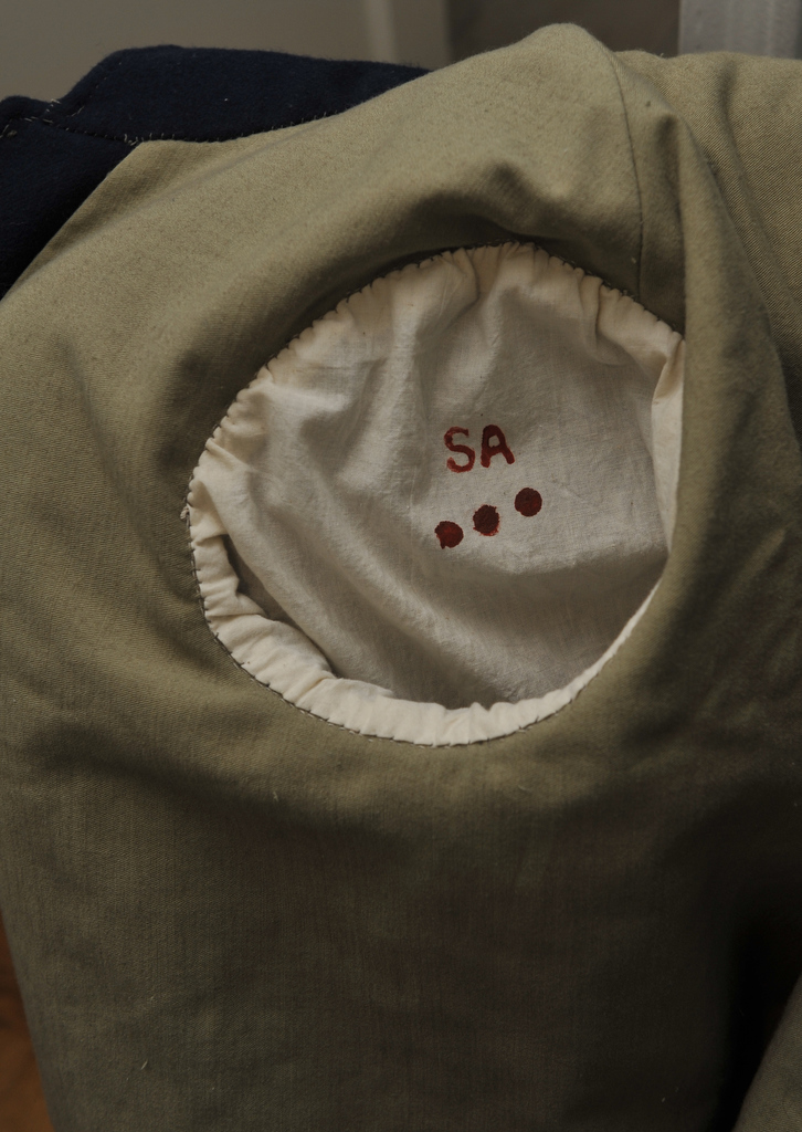

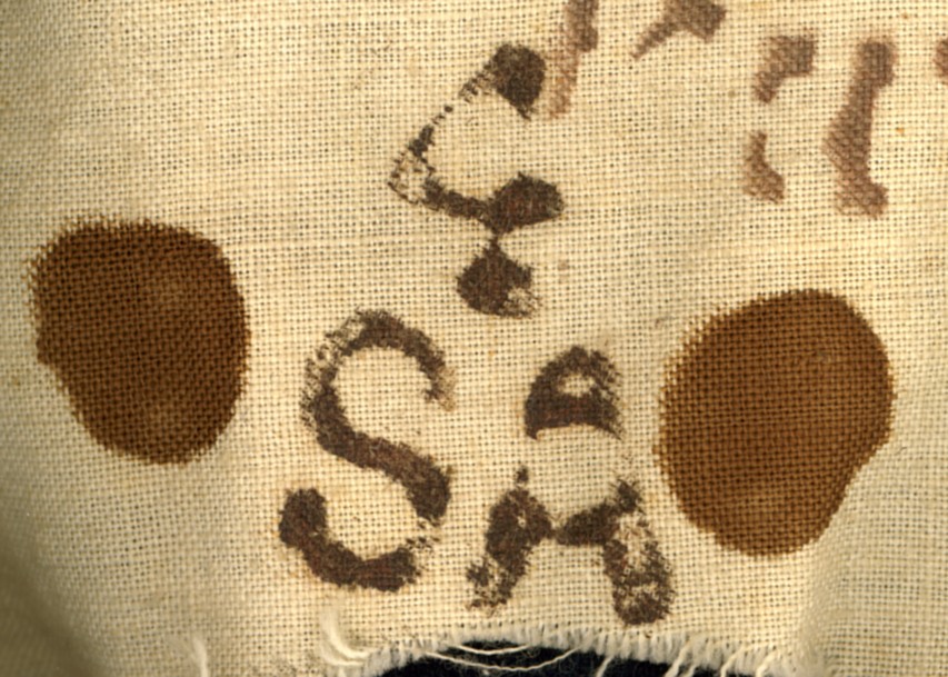

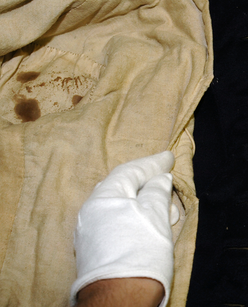

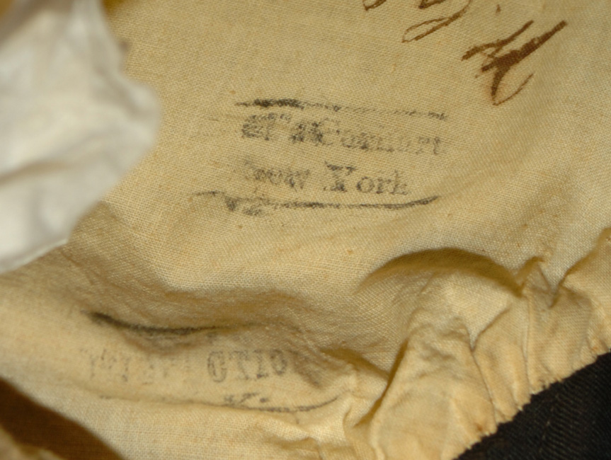

                Some samples.
                1. SA artillery jacket.
                2. Enlisted infantry frock.
                3. Daniel Byam SA "Signal Corps" jacket.
                4. SA infantry trousers.
                5. My repro stamp in the sleeve of an SA blouse.
