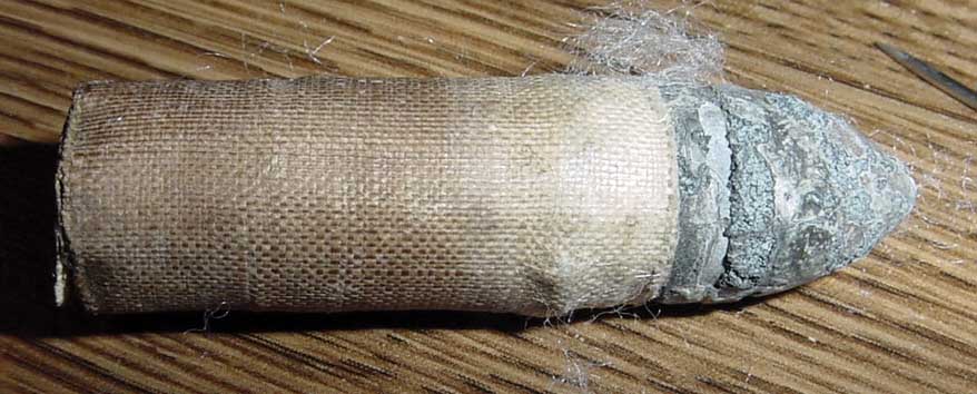

            Re: Linen for Sharps Cartridges
            Took me a while to find this picture. It shows the linen pretty well.
            Jim Mayo
