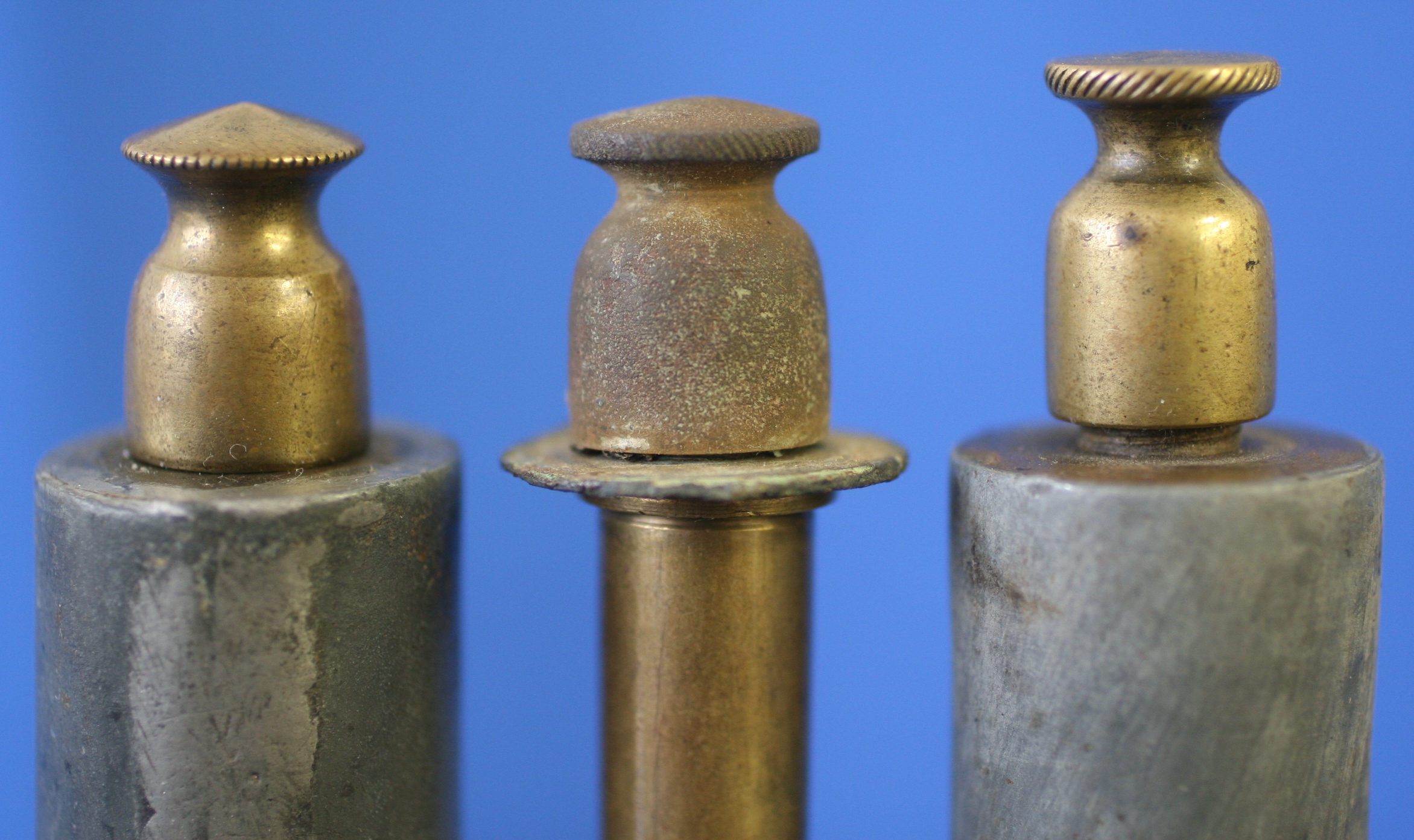

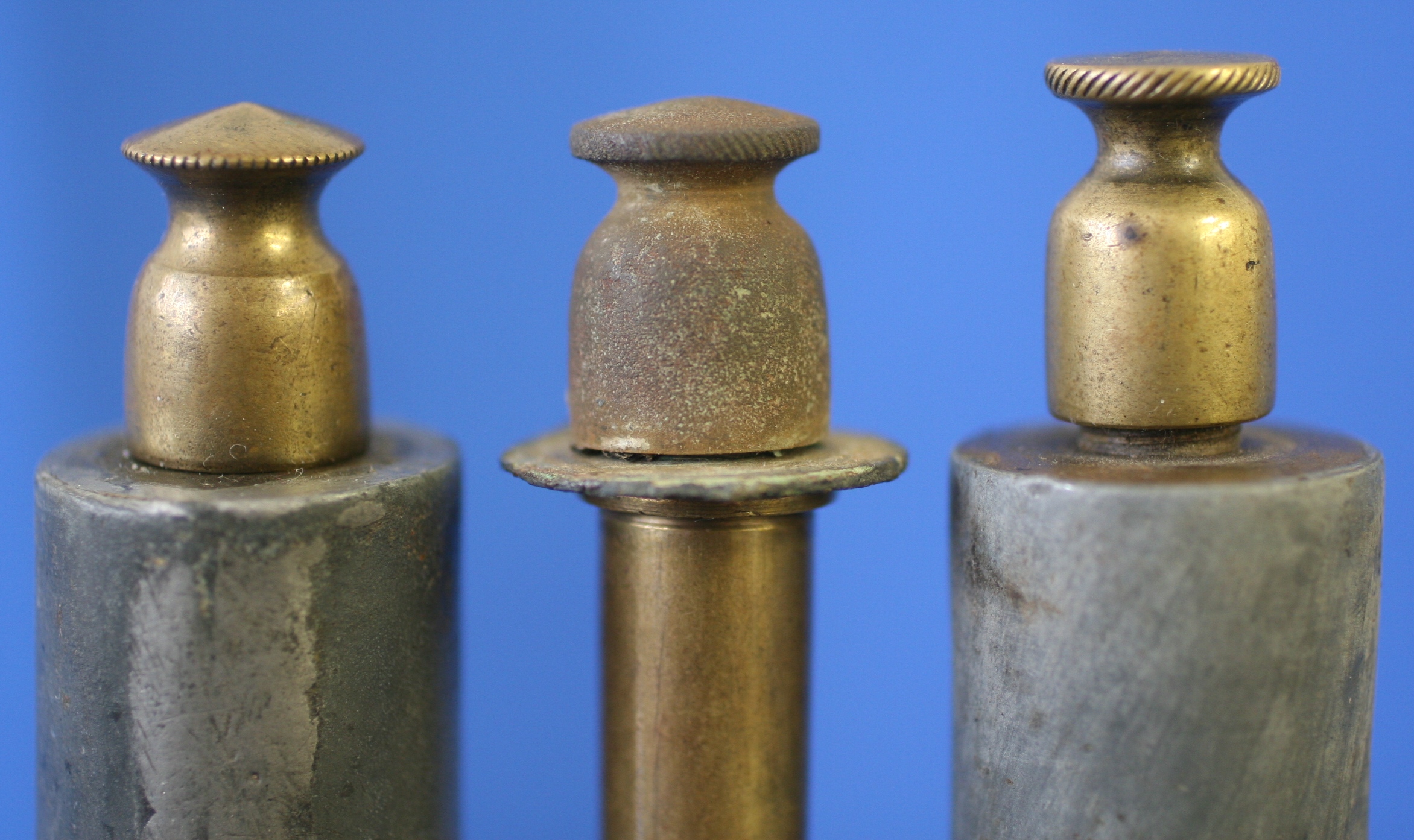

Name:	CW English oil bottles 003.jpg
        My first try on posting a photo here....Center is the dug-up oil cap, set on a .45-70 case to make it the same level as the others. Left is an original seamed oiler, right is an original List of Changes 1862 oiler. The dug one, more favors the seamed oiler, though with most English items, there is quite a latitude within general types...
        Dean Nelson

          Re: P1860 Enfield Oil Bottle
          That's a great picture Dean, thanks. I have never seen the top on the right before, but have seen the one in the middle on seamed containers. It's also good evidence that the seamless P1862 oiler made it in as well. Do any of the pictured bottles have any provenance. And do you know where the excavated cap was unearthed?
          Dave Burt

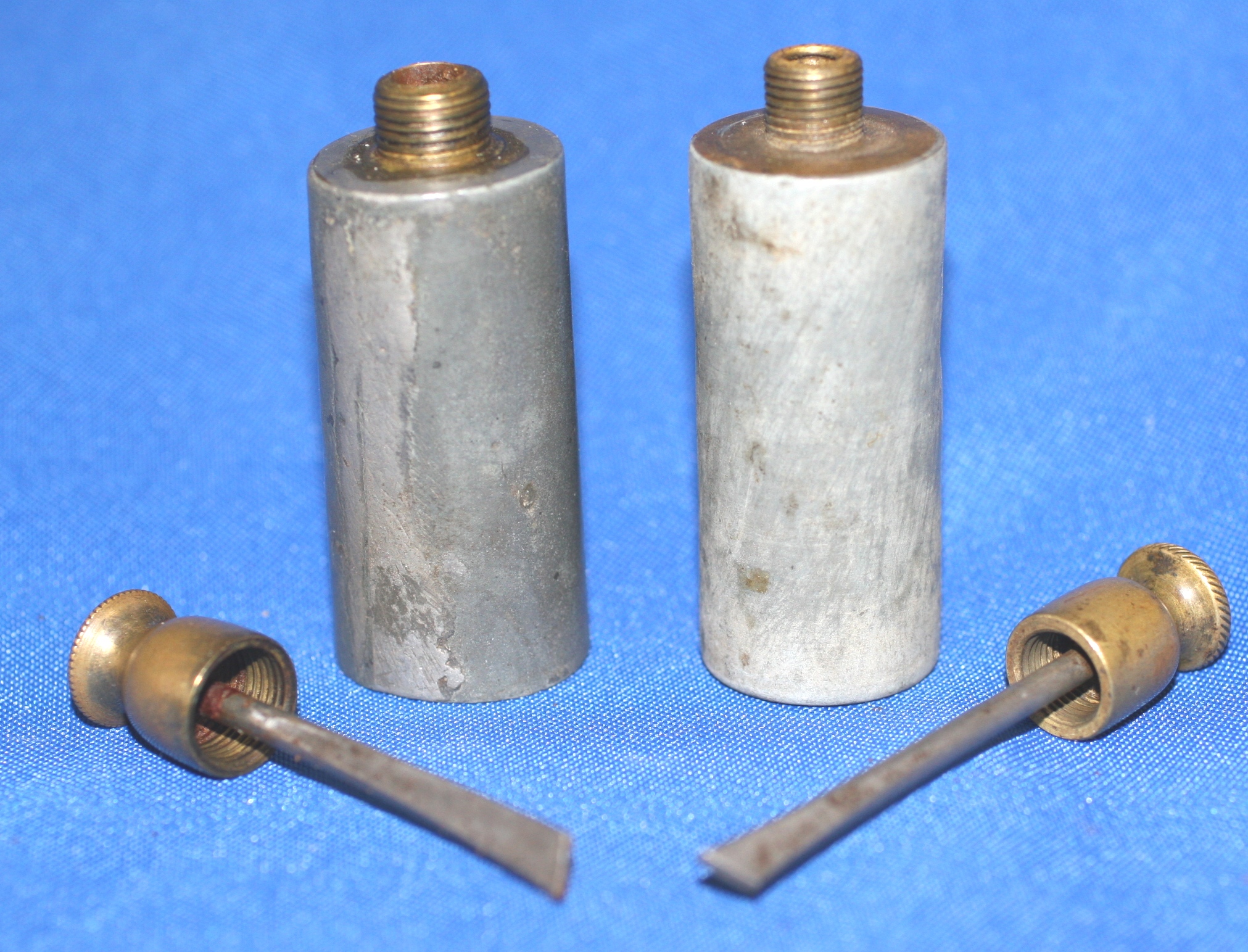

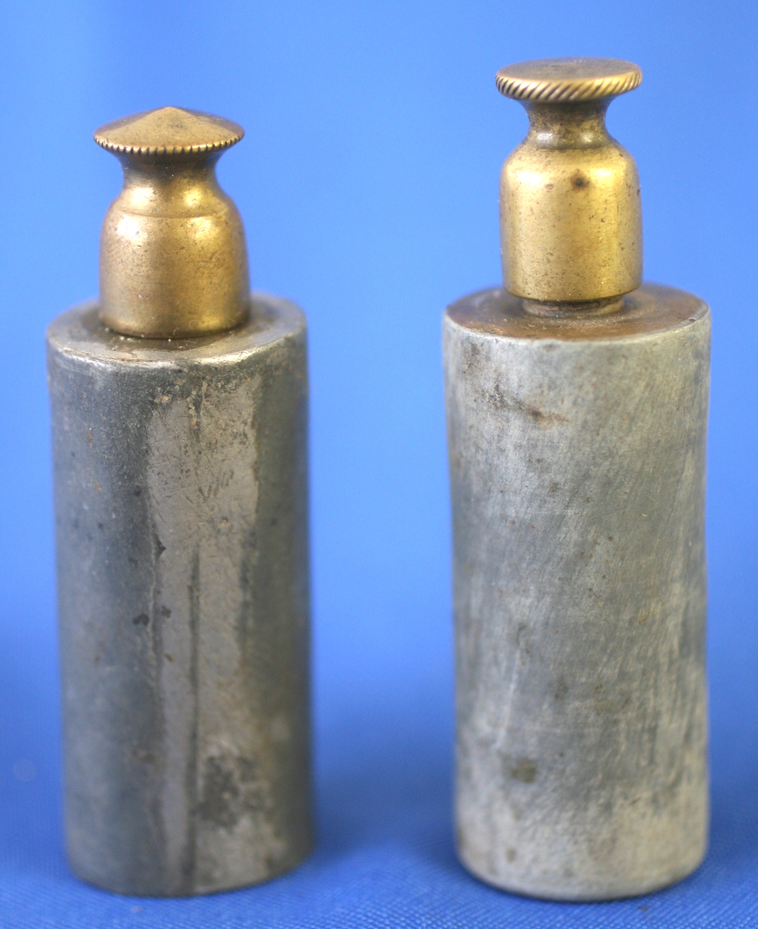

                The left oil bottle is made up from flat zinc sheet that is rolled, side-seamed and fitted with the cast brass top disk with threaded collar. A zinc disk is set in the bottom. If a lower melting point zinc is used to close the seams, technically it it a "weld" because it is of the same metal as that which it joins. If it is a lead/tin solder then it is a "solder". I do not know the identity of the joining metal here. This example is 2.135 or so inches tall and .975-.995 inches in diameter. It lacks an accompanying provenance.
                The right oiler body is seamless, made from deep drawn zinc with a brass top disk/collar set in. Zinc was extremely hard to work without cracking and this simple drawn container was at the time a metal working tour-de-force. It is 2.70 inches tall, .980 inches at the top tapering to .960 inches at the bottom. This taper enabled withdrawal of the formed body from the dies. No background on this one, either.
                The dug brass cap is said to have been recovered in vicinity Spottsylvania, VA, and was among a large miscellaneous lot of dig-ups.
                Dean Nelson
                1st Mary Infantry, CSA, N-SSA

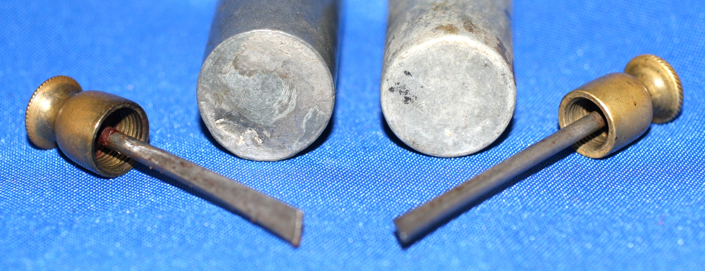

Name:	CW English oil bottles 049.jpg
                      Bottom view.....
                      Dean Nelson
                      1st Maryland Infantry, CSA, N-SSA
                          The seamless oil bottle retains its leather washer; it is a small diameter disk, centrally holed, that goes over the iron "feather" (dip stick) and up all the way to the top of the female threaded cap.
                          The seamed oiler is missing the washer, but there is a brownish residue in the very top of the threaded cap that I feel is a vestige of the missing leather, rather than just dried oil.
                          Hope this is of interest.
                          Dean Nelson
