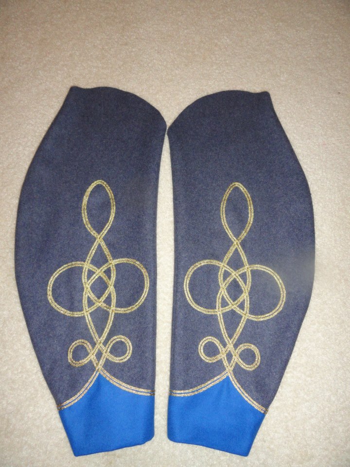

In preparation for some "'sesh" officer portrayals this year, I am making a "Charleston frock" and thought it might make good fodder for sharing the process of adding complex braid/trim to a garment. While the subject here is sleeve braid (aka - "Austrian knots"), one could easily use similar techniques for the trefoils on the braid to close the toggles on a Federal officer's overcoat, trim on "Zouave" jackets, etc.

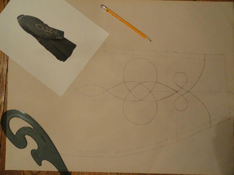

1) Drafting the pattern:
I used plain paper and photographs of some Charleston frocks to design the knots that I wanted to use. I used clear rulers, a square, and a set of French curves to draft the pattern.

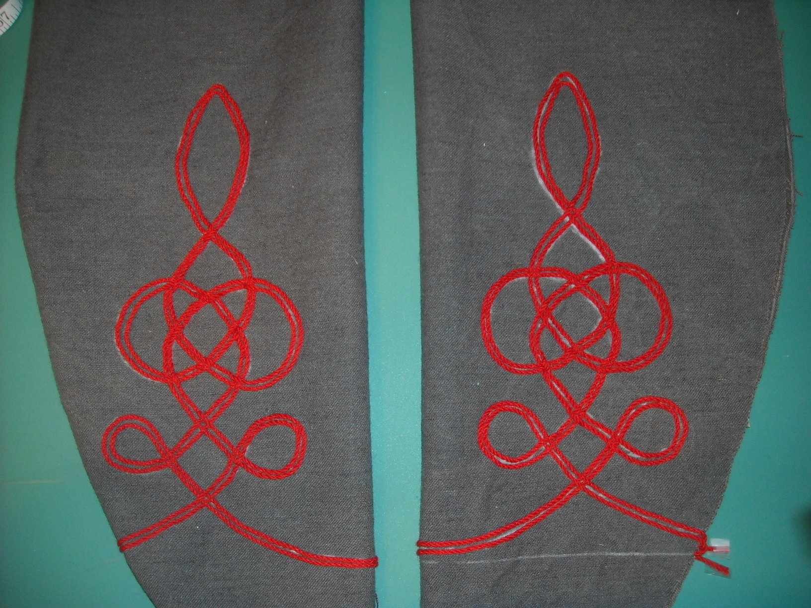

3) Chalk doesn't last! I used basting stitches to permanently mark the pattern.
4) Pin and stitch...
...and stitch and stitch and stitch
Stitching on the back of the piece...
