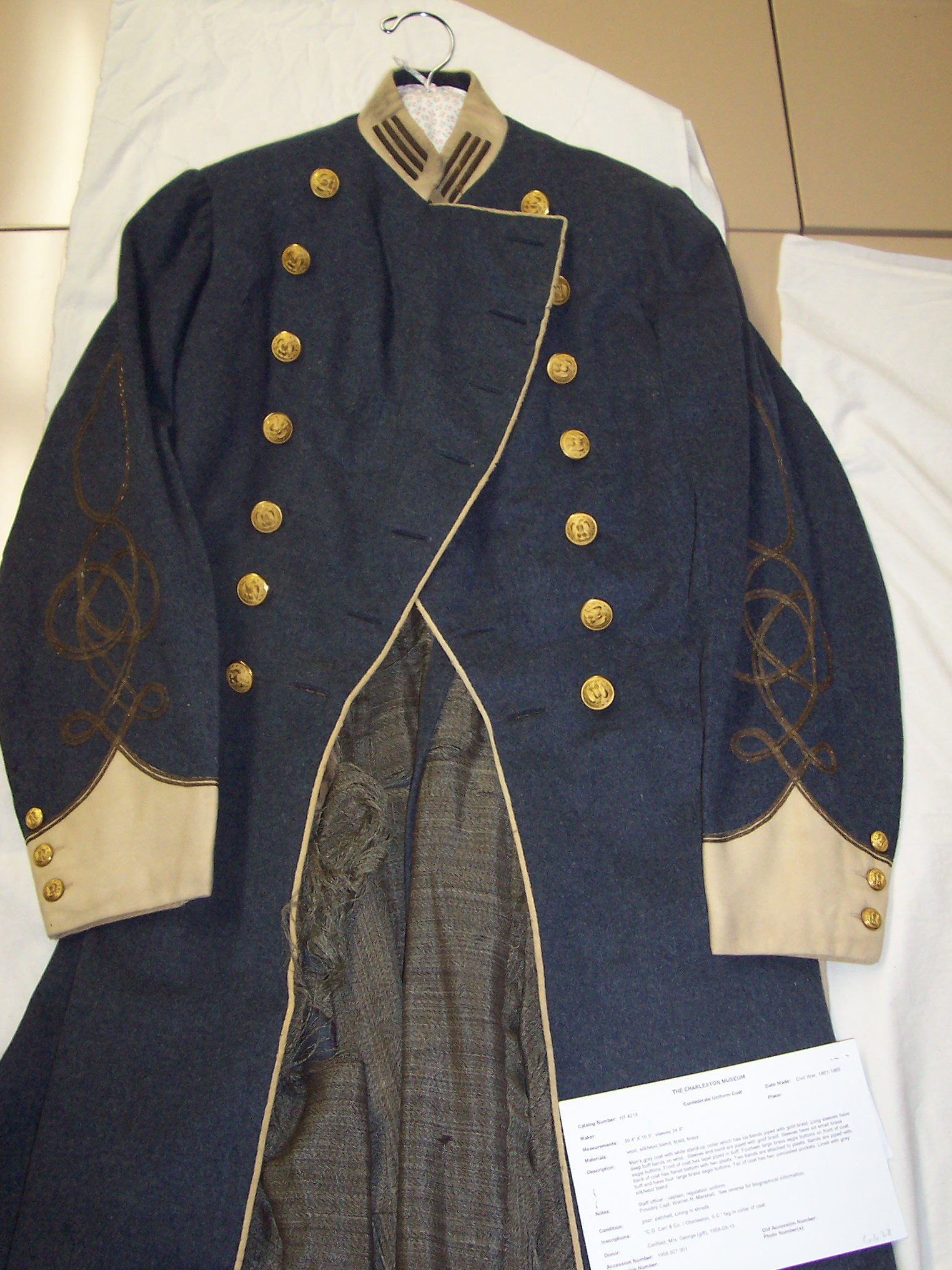

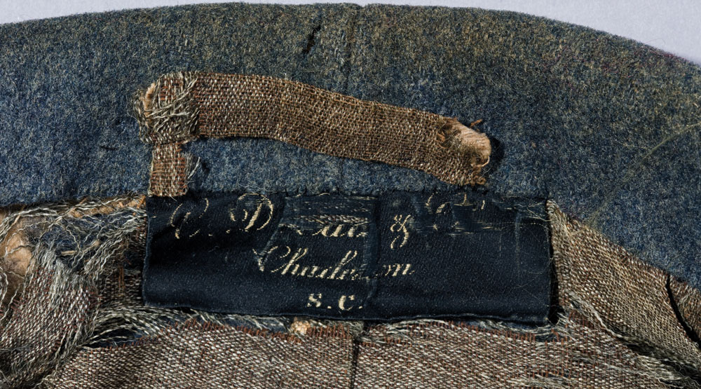

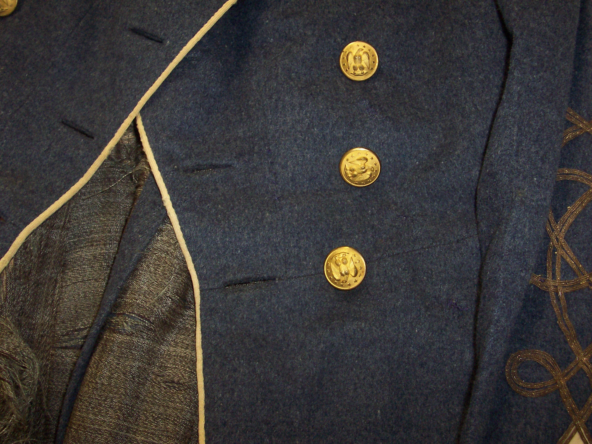

                      See attached. The two photos of the officer's frock are courtesy of Neill Rose and I believe that the garment is in the collection of The Charleston Museum. Unfortunately I do not have an ID for this coat. The close up photo with the Charleston tailor's label comes from the (really cool) jacket of Capt. Robert Chisolm, 1st SC Sharpshooters. Both of these linings are the same and appear to be a somewhat coarsely woven marled alpaca on a brown warp of unknown fiber content.

                          The link I provided shows two linings from Charleston Frocks that are in the Charleston Museum
                          http://s1171.photobucket.com/user/ty...rwood/library/#
                          The brown silk lining is from a coat worn by Edward Robinson who is thought to have been in the Washington Artillery and the Gold Silk is from the coat owned by Capt. Horace Sams of the 11th SC and the skirt is also lined in the same material.
