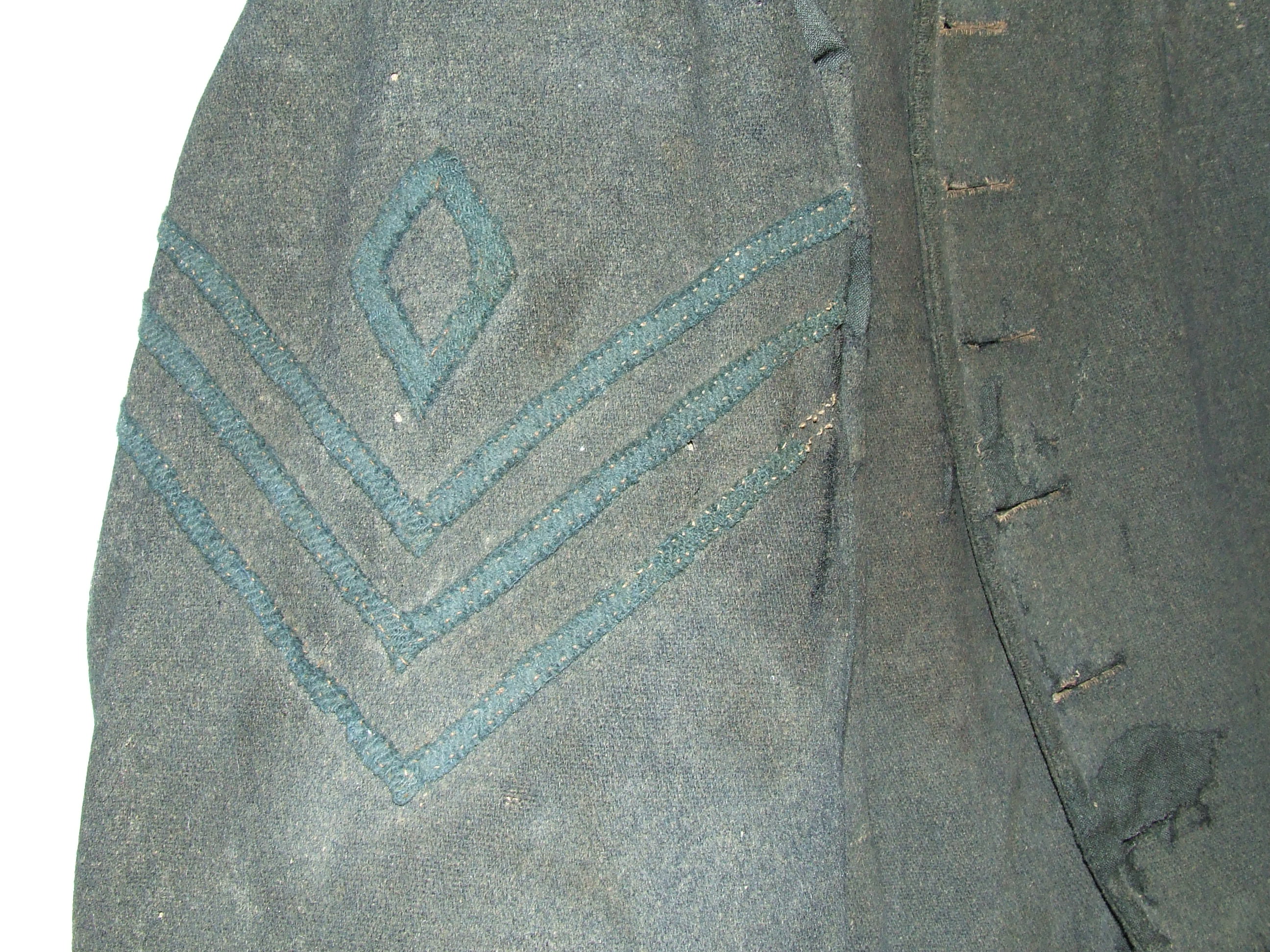

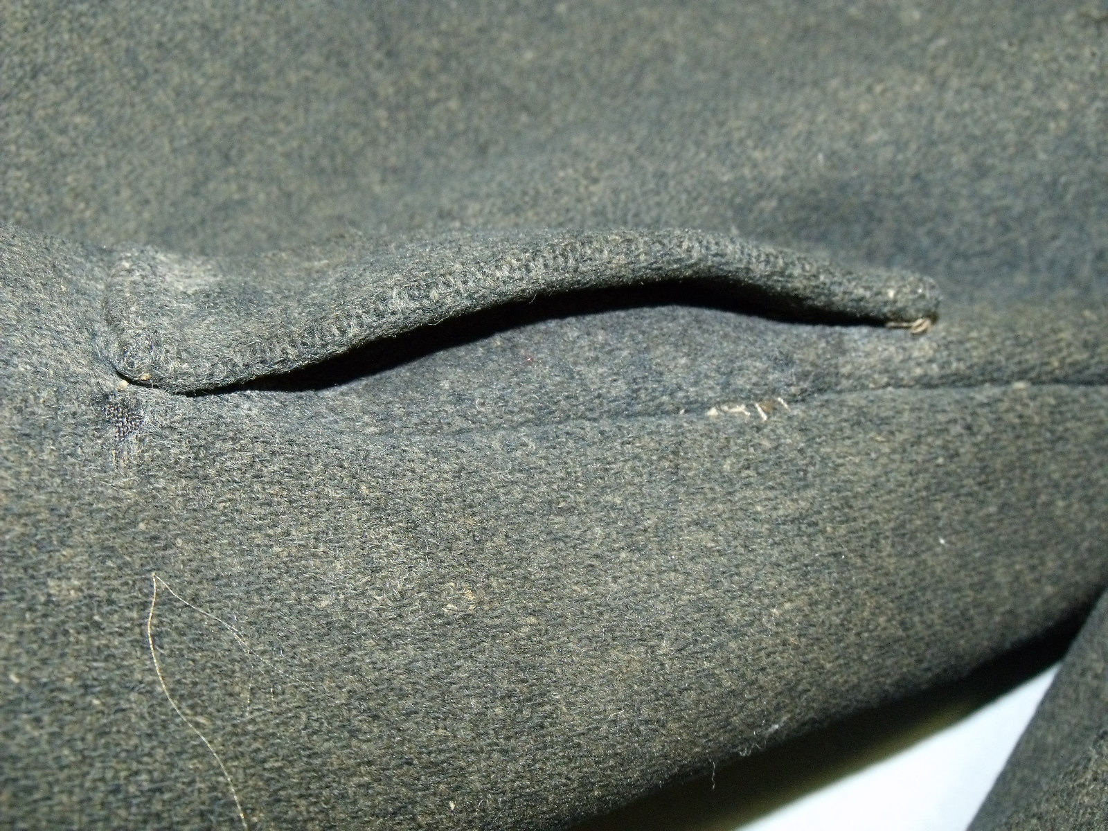

      I'd like to point to two original enlisted jackets made from blue-gray imported fabric, each of which can be dated to use in 1863. The jacket worn by Capt. E.S. Marsh, 4th North Carolina Infantry in the Pamplin Park collection and the unattributed 1st Sergeant's jacket in the Gettysburg Battlefield Visitor's Center & Museum.
      Dan Wambaugh and I had the good fortune to study the Gettysburg jacket in person last spring. While I was examining the interior I noticed that the very top of the sleeve and sleeve lining was re-stitched using a different thread than found throughout the rest of the garment, and by someone else (hand stitching techniques can differ wildly and noticeably). I pointed this out to one of the staff members who said they had never noticed it before; my opinion was and is that the war time owner of the jacket had deliberately removed the epaulettes and sewn the sleeve and lining back into place. Unfortunately it is not known exactly where on the battlefield it was found but it was found there. Because of the lack of epaulettes the staff wasn't sure if the battlefield attribution was correct, thinking it might have been a transitional later-war RD jacket or maybe an RDIII. I'll also add that the jacket is not made of kersey but rather a mixed blue gray broadcloth or melton. The jacket is also heavy with soiling and dirt, making it appear darker/grayer than it was originally (areas under the belt loops are unsoiled and still vibrant). The chevrons are hand sewn directly to the sleeves and cut from what believe is royal blue kersey. Some select photos below.
      Detail of chevrons and fabric.
      Detail of belt loop. This may not show the color different well, but the material under the loops is unsoiled blue-gray.

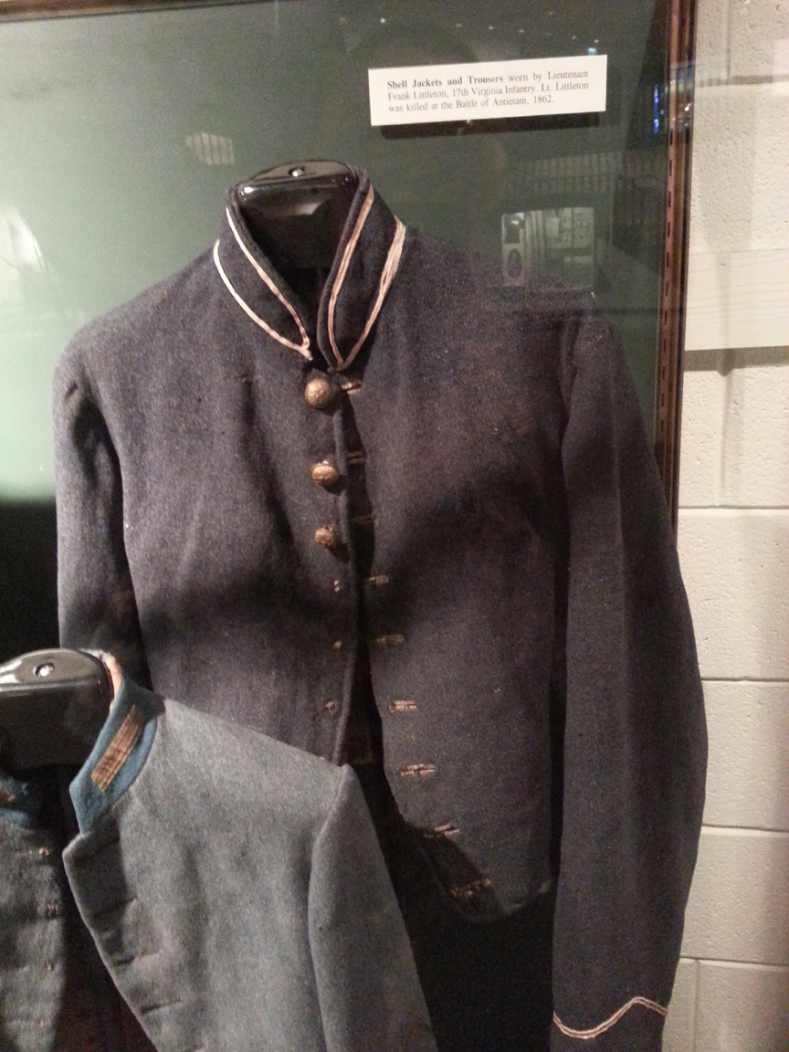

              I forgot all about this, but the Virginia Museum of the Civil War in New Market, VA has a BG kersey jacket and light blue kersey trousers worn by Lt. Frank Littleton of the 17th VA who was killed at Sharpsburg. His pants are from when he was a 1st Sgt., which still have the stripe down the legs. The jacket is a 9 button front, looks just like an RD3, the buttons are 3 piece US Staff domed eagle buttons, and has trim around the collar & chevrons on the sleeves.
