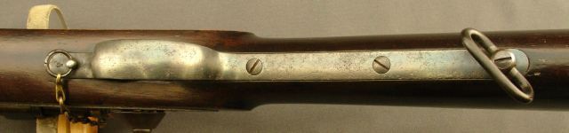

    I'm working on a rifle project and was wondering if anyone had an original and could take a picture of the trigger guard from the bottom. I'm trying to determine screw placement. I've got pictures of originals from every angle but that one.
    If anyone can help, it would be much appreciated.

    This is a snider conversion, only pics I could find that showed the trigger guard. Screw placement should be the same with of course the handmade element of rifles imported during the ACW coming into play.
    Well that did not work like I planned. Under the above link, go to antique longarms and scroll down to item 4359.

      Maybe this will work.
Name:	1856 trigger guard.jpg
      I have noticed while looking at partial pics of t/g's from College Hill that the placement of the screws does vary.

        That's perfect. The casting I received from overseas wasn't clear about the location of all the screwholes. I knew the one for the sling swivel would be near the bottom, and the one closest to the trigger was visible in the casting, but the rest of the trigger guard was so long that it seemed intuitive that there would be another screw there. Thanks again!
