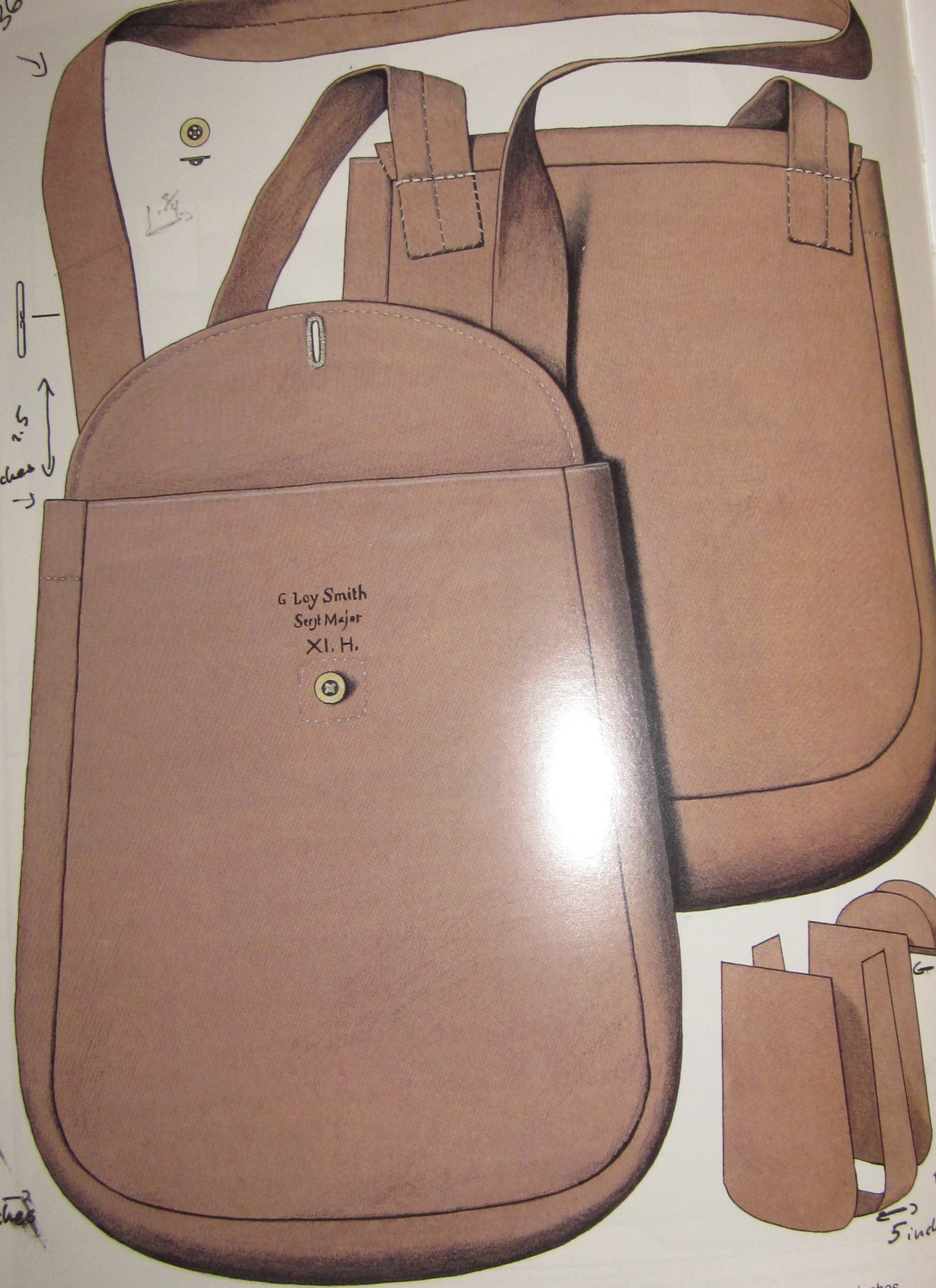

      I don't think Boyd's is the one Dave is talking about. It would probably look like the 1854 model. Click image for larger version
Name:	brit haversack 1854.JPG

              Thanks Marc, as can be seen in the picture David posted above, that is certainly the P1854 type. The other type imported were stamped "S ISAAC CAMPBELL & CO in blue ink and these were the types issued to the British Rifle Volunteers as SIC & CO were their main providers.
              So it appears that two types were imported - although in small numbers. Both the P1854 and the volunteer type.

                From what I gather reading some books on British Issue equipment, there are a couple variations issued around this time period. The one pictured above is has provenacne to 1854 via the Sgt. Major Smith. it was issued to, but may have been an issue item to earlier than 1854. The one with the brass adjustment buckles on the strap is suppose to have been issued in 1860. The 1860 was "upgraded" around 1864/65 with a button on the back of the bag that allowed it to be rolled up when not in use. I haven't found any information about British Rifle Volunteer bags as of yet. But I do know that Don Smith of the Trans-Mississippi Depot made a reproduction of the Volunteer bag at one time. I believe he copied it from one in a collection also, but don't have that information.

                  Thanks for the detailed reply. The picture of the painted bag looks to be the P1860 type bag complete with the altered strap- which you correctly say- was issued in 1860. I know Huse invoiced 2000 'Haversacks' in August 1861, but there are no other mentions of them in all the other papers in the McRae collection. And Gorgas did not mention any in his "Abstract of Summary" letter of February 1863. This leads me to believe that this 2000 were indeed the only ones exported on government account as Huse would know that a haversack could easily be made by southern seamstresses - and as he was desperate to save money- I believe he would not have ordered more.
