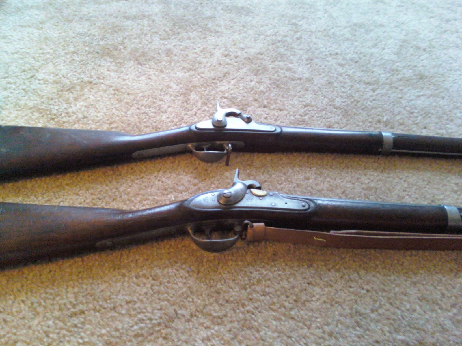

                  I have built a few muskets from dissociated original parts and junk parts guns now. I do all my metal refinishing very gently by hand being very conscious of the markings etc. Like anything time and patients are key. Click image for larger version

                  Robert Johnson
