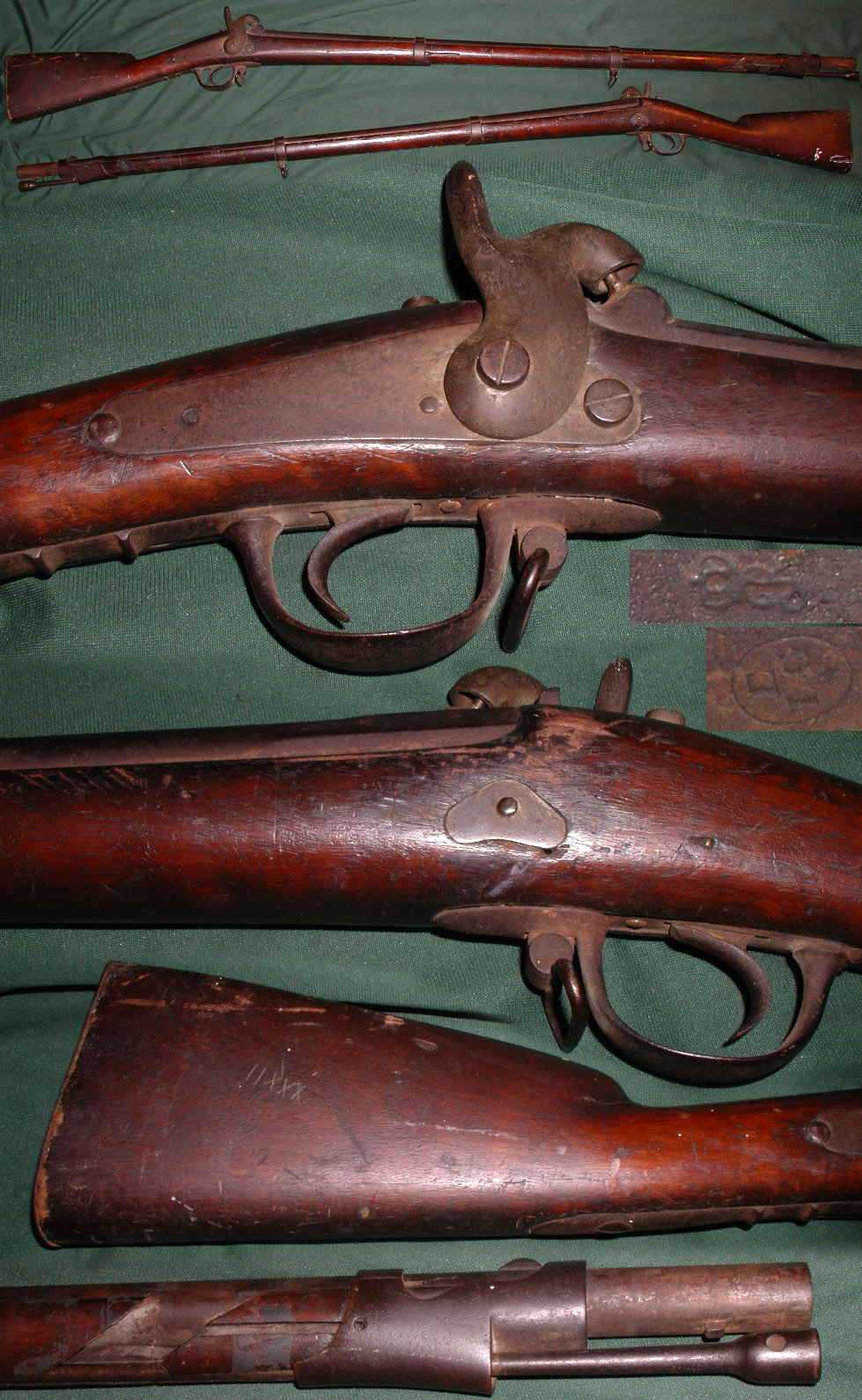

ID:	224298 I cant see pictures of your musket in question - but I bough an old Belgian musket a few years ago for the same price as an Indian repro. It was missing a little chunk of wood, the front barrel band spring and the nipple. Nobody else had messed with it. It was evenly brown all over, but I had no idea just how deep it was till I got it in my hands. I ended up making a front band spring, patched the stock with wood from an old Tabatiere, straightened up the original rammer, and now have a 98 percent original musket that looks like a well maintained period musket and not a hundred and fifty year old relic. My rust was light and cleaned up with no pitting at all. Many people overdo things - round off corners and muddle things up. I was able to match the degree of brightness to the still bright bottom of the barrel. It would pay to practice on some junk parts. I only have before pictures, not after.

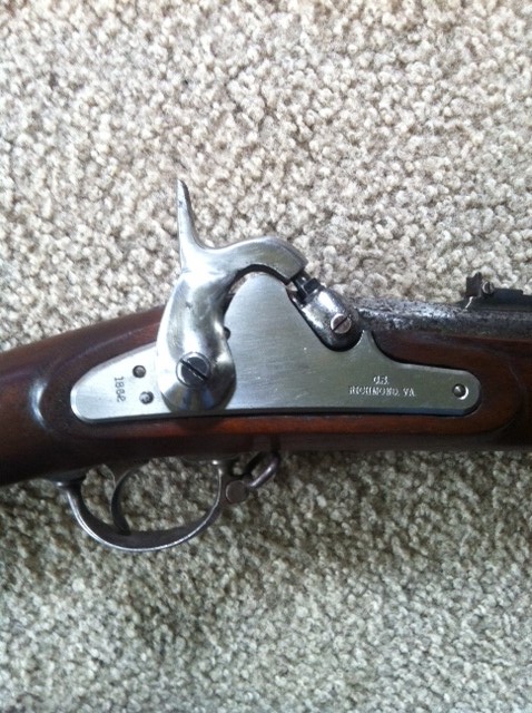

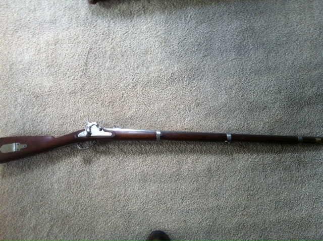

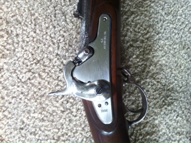

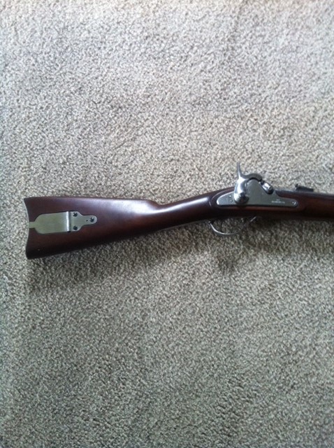

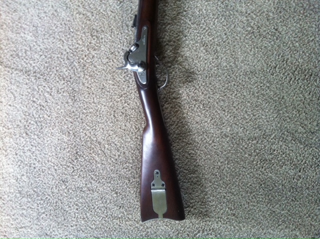

            I have been working on a Richmond rifle musket for a couple of years now and just got it completed. This was a project gun that was started years ago by another unit member. It was in bad need of some TLC. It had an original '61 Springfield barrel, which had a Hoyt reline done on it. I added a '62 dated high hump lock plate from Rich Cross, cleaned the original stock of years of dirt and grime, and hand rubbed in several coats of oil. I polished the barrel by hand. I put on an original US trigger guard assembly which had been stamped as condemned by the inspector. Lacking the correct tools, I had a unit member who happens to be a very gifted gunsmith, fit an iron butt plate and patch box. The end result was well worth the years and time I put into it. I copied an original that is in a private collection and was very pleased with the end result. Bottom line is that I spent about it would have cost for an incorrect Italian repro. The Richmond probably would have sat in a corner for years, only to be eventually broken up for parts. With a little work and some time, I not only saved a mostly original gun, but had the fun and money savings of doing most of the project myself.
