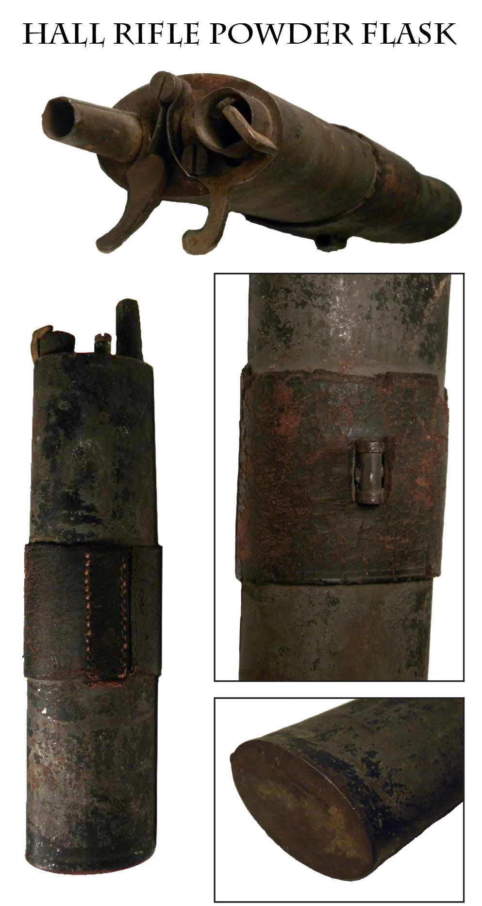

              Any idea how they would load the cartridges? If I recall correctly, I thought the flintlocks were loaded using a powder horn. How would it work for percussion altered rifles?

                Originally the Hall's Rifle was intended to be used with a specially designed double flask. The flask had two compartments; one holding 18 balls, and the other 1/4 pound of powder. There are some variations in design, apparently some early flasks held only 16 balls. 10,678 flasks were produced at Harpers Ferry between 1822 and 1837. I'm not aware of Simeon North supplying any, and given their rarity, he very well may not have.
Name:	Hall flask 2.jpg
                Flintlock Hall's were loaded by priming the pan, then pouring powder into the chamber. Lastly, the ball was funneled out of the flask and seated with the little finger. All Hall's Carbines were produced as percussion arms and were presumably used with ready made cartridges (definitely after 1840), although they have have been flask loaded like the rifles early on. The service charge for Hall's Rifles was listed as 78 grains in 1837, 100 grains in 1839, and 78 grains in 1842. Given that the M1841 Hall would be in production the following year, and no new regulations were posted it is likely that Civil War era Hall's cartridges contained 78 grains of powder. The loading of the M1841 or a percussion altered M1819 would follow the same procedure as before, excepting the percussion cap replaced the priming of the pan, and the flask was replaced with an individual cartridges that was torn and poured into the chamber.
