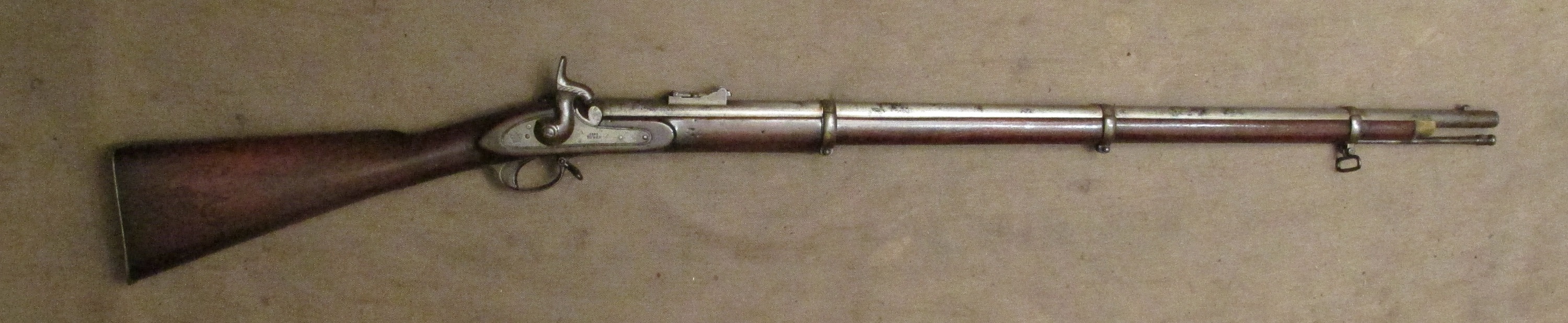

          Wouldn't it be proper to make your Enfield into the most common imported model? One good choice would be a BSAT marked Tower. This one is a dated 1862 Tower with BSAT rondell. It was issued to the 9th Vermont. For your use I would go with 1861 date with or without the BSAT mark. I see more without than with.
