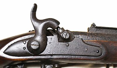

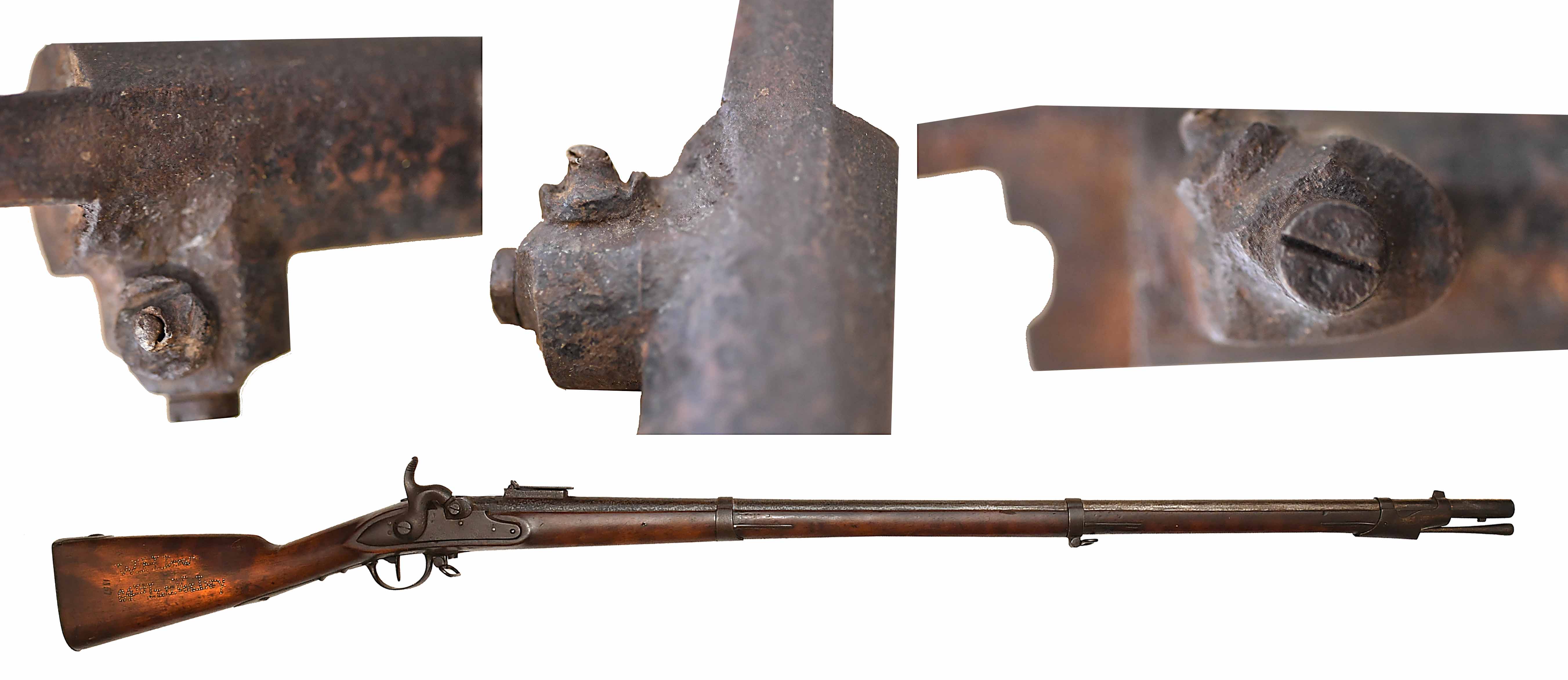

    I recently picked up a European musket with tack decoration on the buttstock identifying it to William Dow of the 64th Illinois. The item was described by the seller as a Liege musket; it appears to be a copy of the French model 1822 musket, converted to percussion by German gunsmiths in Baden or Wurttemburg. The cone/nipple has been pounded flat and I would like to replace it. Does anyone know the size of this nipple, and a source for an original replacement? Does a period Springfield, Enfield, or French nipple have the same threads? Thanks for any help!

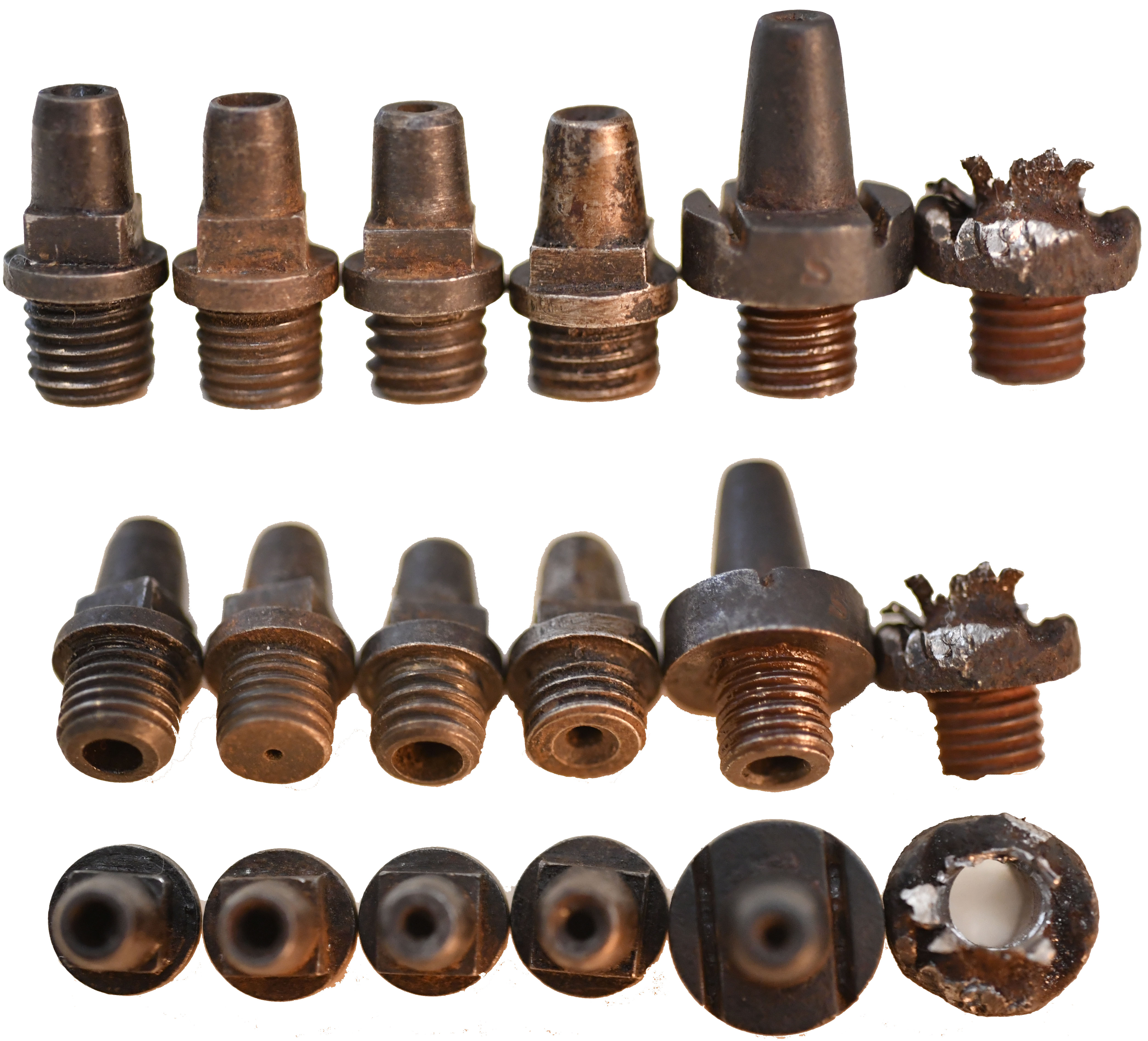

            I drilled out the old nipple in my Liege musket with Baden bolster conversion. I tried to seat an original Springfield, Sharps, British Enfield and French nipple in the socket (shown in that order in the photo). None fit. Click image for larger version

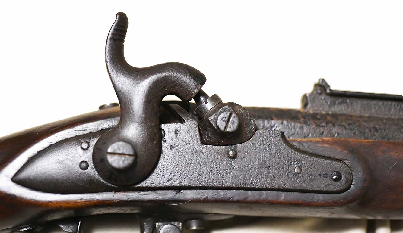

            Fortunately, I stumbled onto a seller on eBay who offered for sale a Prussian musket nipple. The photo of the nipple showed two parallel slots in the base, like my nipple that needed replacing, rather than the familiar square shoulders. When the nipple arrived, it was bigger than I expected. In fact, it looked just like what are sold elsewhere as a Ketchum grenade nipple. But, the base paralleled that of my destroyed nipple, and the threads were a match and seated perfectly both in the bolster, and in the face of the hammer (see second photo). ATTACH=CONFIG]51621[/ATTACH]
            I found what I needed, but a question remains. Did Ketchum grenades use Baden nipples, or are what are called Ketchum nipples misidentified for the past 40 years?
