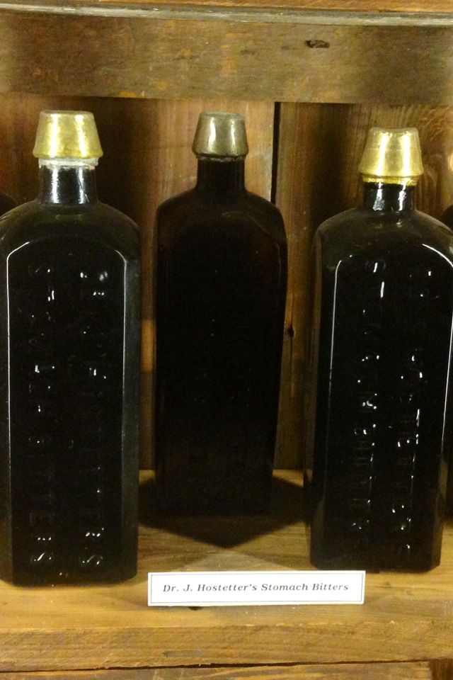

    The only foil items I recall from the Arabia are the lead foil used to seal bottles, like stomach bitters, etc.

      A way to replicate this at events is to use dental foil (although pricey)... modern aluminum foil is too thin for our period use. Heavier gauge dental foil can be used on period bottles like in the Arabia collection and it simulates the feel of period 'tinned foil'. There is a reason why champagne and wine bottles have foil on them in supermarkets today and it is heavier than aluminum foil... it comes from the tradition of using tin foil to seal them versus wax.
