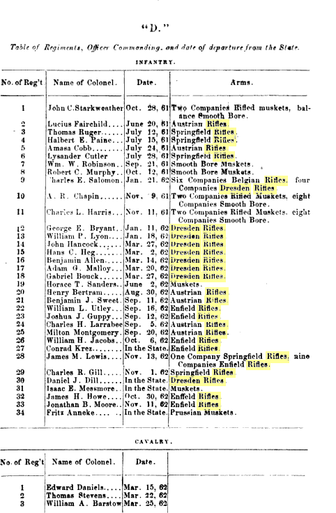

                        Re: Need Help on Shiloh for Presentation and Research - Uniforms & Firearms.
                        Hello-- Wisconsin arms issued by the State-- The 14th, 16th, and 18th Wisconsin had Dresden-Suhl Rifled muskets at Shiloh. A Class A firearm.
                        Tom Arliskas
                        CSuniforms
                        Tom Arliskas

                          7th Arkansas Infantry, went into Battle with Model 1819 Hall’s flintlock rifled muskets, .52 caliber.
                          2,290 men, all armed with Rifles, Hall’s and Enfields, but the Hall’s “flint and steel muskets put the men at a great disadvantage.”
                          Cleburne’s Brigade
                          2nd Tennessee Provisional Bate’s, mixed civilian rifles and flintlocks initially.
                          6th Mississippi Infantry, two flank companies Enfield Rifled muskets, and the rest “mixed”
                          15th Arkansas Infantry, poor arms, but picked up new Enfield Rifles from Peabody’s camps.
                          23rd Tennessee Infantry, Flintlock .69 caliber smoothbore muskets.
                          24th Tennessee Infantry, some 1841 Model Mississippi Rifles and the balance flintlock .69 caliber smoothbores.
                          2,537 men, maybe 500 rifles, and approximately 1,258 smoothbore muskets.
                          Wood’s Brigade
                          3rd Mississippi Infantry Battalion, UNKNOWN
                          8th Arkansas Infantry, Conflicting evidence, one source says Enfield Rifles and the original ordnance records show 24,000 Flintlock cartridges issued post Shiloh, April-May, 1862.
                          9th Arkansas Infantry Battalion, Model 1819 Hall’s Rifled muskets and a mix of civilian guns.
                          16th Alabama Infantry, cap and ball .69 caliber smoothbore muskets.
                          27th Tennessee Infantry, issued new Enfield Rifles in December of 1861.
                          44th Tennessee Infantry, UNKNOWN
                          55th Tennessee Infantry, only two Companies armed with flintlock .69 caliber smoothbore muskets.
                          1,996 men, 3rd Mississippi Battalion and 44th Tennessee UNKNOWN- 490 rifles known and 580 smoothbores.
                          Reserve Corp
                          Brigadier General John C. Breckenridge
                          Trabue’s Brigade
                          3rd Kentucky Infantry, evidence to mix cap and ball .69 caliber smoothbores and flintlock .69 caliber smoothbores.
                          4th Alabama Infantry, evidence to Enfield Rifles and smoothbores
                          5th Kentucky Infantry, “Ragamuffins’ armed with long-rifles [civilian].”
                          6th Kentucky Infantry, went into the Battle armed with smoothbores, traded them for Enfield Rifles on the 6th.
                          31st Alabama Infantry, evidence to part Enfield Rifles and smoothbore muskets.
                          Crew’s Infantry Battalion, “poorly armed.”
                          2,678 men.
                          Second Brigade
                          Brig. Gen. JOHN S. BOWEN (wounded)
                          Col. JOHN D. MARTIN
                          9th Arkansas, mix of Hall’s Rifles, cap and ball .69 caliber muskets and civilian rifles and shotguns.
                          Col. Isaac L. Dunlop
                          10th Arkansas, Model 1819 Hall’s flintlock Rifles .52 caliber
                          Col. Thomas H. Merrick
                          2d Confederate Infantry [25th Mississippi Infantry], UNKNOWN
                          Col. John d. Martin
                          Maj. Thomas H. Mangum
                          1st Missouri Infantry, evidence to Enfield Rifles
                          Third Brigade
                          Col. WINFIELD S. STATHAM, 15th Mississippi
                          15th Mississippi Infantry, Co. G Maynard Rifles and Mississippi Rifles, the rest flintlock .69 caliber smoothbores.
                          22d Mississippi Infantry, evidence to all Enfield Rifles.
                          19th Tennessee Infantry, initially flintlock .69 caliber smoothbore muskets, days before Shiloh, cap and ball .69 caliber smoothbore muskets and 97 Mississippi Rifles .54 caliber.
                          Col. David H. Cummings
                          20th Tennessee Infantry, initially with flintlock .69 caliber smoothbore muskets, in March of 1862, all new Enfield Rifles and accoutrements.
                          Col. Joel A. Battle (captured)
                          28th Tennessee Infantry, “615 flintlock smoothbore muskets for 915 men October of 1861.” Possibility of Enfield Rifles for the balance.
                          45th Tennessee, Mix of cap and ball .69 caliber smoothbore muskets, some Enfield Rifles and Mississippi Rifles.
