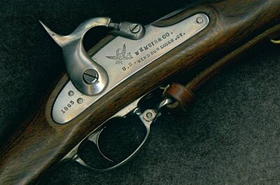

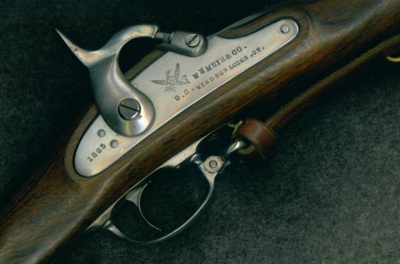

      Here is my contract Springfield repro. This is an Armi Sport 1861, now turned into a William Muir contract model '61 made in 1863, William Muir and Co. was from Windsor Locks, CT. The first pic is the repro, the second pic is the original that was copied.

        Wow! Thats a real beauty! Great pics and shows off the details real well.
        Did you have any problem with the Armisport When you did this work?

          I cannot take credit for the work, only the idea. Our units home impression is that of the 149th NYSV out of Syracuse, NY. Several of us were invited to the home of a decendant of a member of the original 149th, a gent named Peter Foster. His ancestor was Isaac "Ike" Foster of Co. G. He has Ike's musket and upon viewing it I saw that it was a Muir contract Springfield, since we do a 149th NYSV impression I wanted to have it reproduced. I actually had Mr. John Zimmerman do the work for me. As far as I know he had no problems. I was very satisfied with the results. FYI, the 149th was originally issued Enfields at Elmira, NY, but were then issued contract Springfields later.

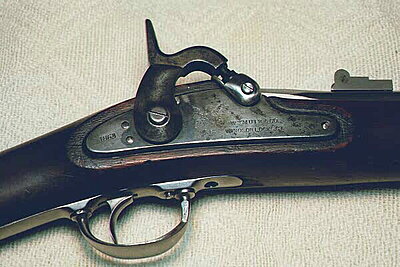

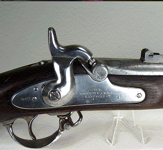

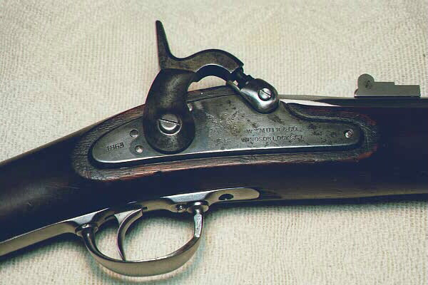

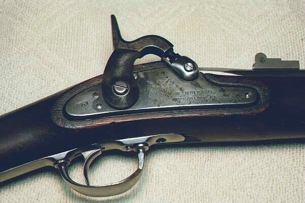

                    I added an original Wm Muir lockplate to my old repro EuroArms several years back. As I remember it slipped right in with a minimal amount wood work. I did make new lockplate screws, but original screws are probably available.
                    I have included two photos of original lockplates. Notice the stamping, the overall quality, and precision of the lettering.
