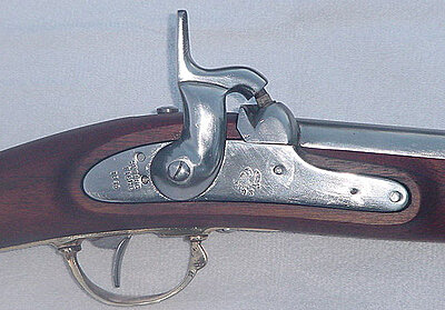

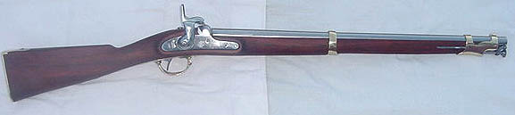

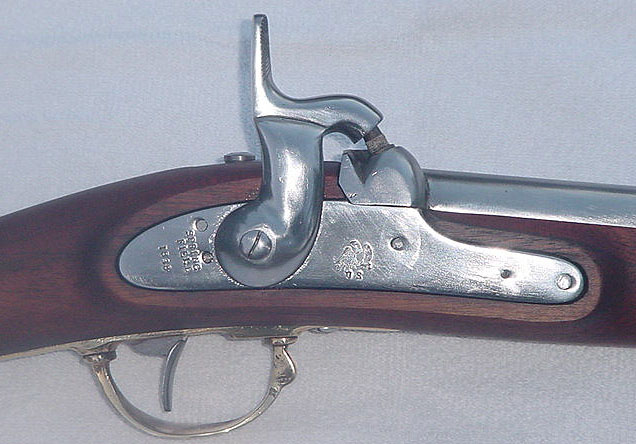

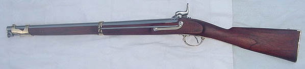

    Since I was made aware of it, this reproduction has fascinated me. I was wondering has anyone here actually purchased one? I do not have access to the reproduction, or an original to compare it to so I have been comparing photos.
    the best pictures of an original I have been able to find are at
    http://www.lodgewood.com/carbine%201847.htm and
    Loyalist sent me the pictures I have attached below. In comparing the two the most noticeable differences are the length of the barrel past the forearm where the swivel ram rod attaches, the trigger, and the shape of the hammer spur having slightly more curve to it in the original. Also the trigger guard has a vestige of where the sling swivel would attach on an 1842. I expect Loyalist just didn't retool for the carbine.
    Here is a link to their site.
    Given these flaws, can anyone with a more experienced eye spot any other deficiencies? Are these inaccuracies any more obvious or harder to fix than the Italian reproductions we are so familiar with?

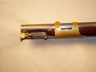

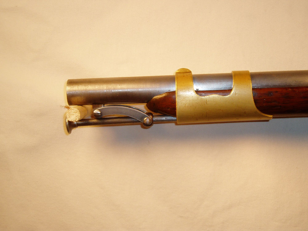

      There are several visual issues with this version of the '47 Musketoon.
      As pointed out the swivel is much too close to the front of the barrel -
      also the swivel is too short and curves too much.
      The front barrel band is also incorrect - for the Cavalry version of the
      '47 Musketoon. While it is correctly brass mounted the shape of the
      front band is closer to the front band of the Artillery or Sappers & Miners
      version of the '47 Musketoon. On original Cavalry Musketoons the stock
      also comes forward of the front band.
      The front ("nose") of the lock is also too extended.
      I have attached two images - from one of my original '47
      Cavalry Musketoons.
