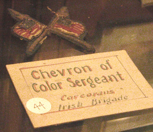

      As Will suggested, the designated Color Sergeant isn't supposed to wear anything special. There are surviving examples of the crossed flags, but for the sake of practicality and for the dearth of period images showing them, they were likely exceedingly rare for use in the field. Besides, who other than one of those specific "carried the flag in all of our engagements" guys would really have the time or inclination to purchase and attach them?
      This is the set that's in the 69th Regiment armory, which I'm sure you've seen.

          Marc & Will, Yes i have seen the flags in the 69th Armory, And have taken pix of them. BJ Zerkle of Texas as sent me the gold bullion to do this project. I have an extra frock that I'm going to set up for Color Sgt. I also have Seaklea Chevron's. I made a pear already but think there alittle to big. I wanted to see if i can get the right size for them. Any help would be great!
