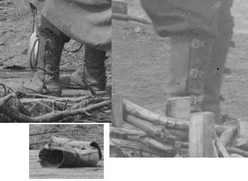

              Leather gaiters abound, including one pair that isn't being worn.
