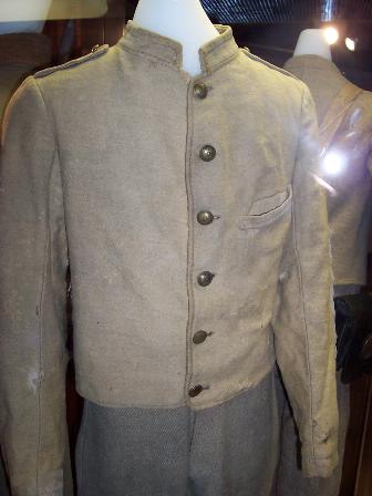

      Gents,
      I thought I'd post an image of this jacket since Scott made mention of it. This is the supposed Wythville Depot jacket that currently resides at the AHC. The image was taken while it was at the Kennesaw RR Museum I believe. An interesting jacket for sure, the shoulder straps match most Richmond jackets but the collar is trimmed with very narrow, faded tape. The rest of the details you can see for yourself. It does have six Virginia buttons.

        Neill,
        Are the Virginia buttons period or post-war?

            I'd be very interested in more details about Wythville and Staunton Depot jackets. design details, colors, fabrics, etc.
            The American Civil war Society in the UK (www.acws.co.uk) has an article that references a Wytheville Depot jacket made of a heavy dark grey wool with features of the Richmond Depot Type III. But ither than that and a drawing, I have not been able to locate any other references to Wythville Deport jackets other than on this thread.

                Neil,
                Was there any information on this piece ( Wytheville Jacket AHC) regarding the provenance ? I have heard about this piece for a couple of years now.

                    Scott,
                    There is little documentation with jacket to my understanding. When Gordon Jones get back from vacation in a couple weeks, I'll ask in for more information and report back. That whole collection includes some great items including the Schumpert frock and trousers; they certainly aren't made from "ticking" but that's another story.

                        Has any information come to light regarding the "Staunton Depot" jacket housed in the AHC? I am very interested in this jacket.
