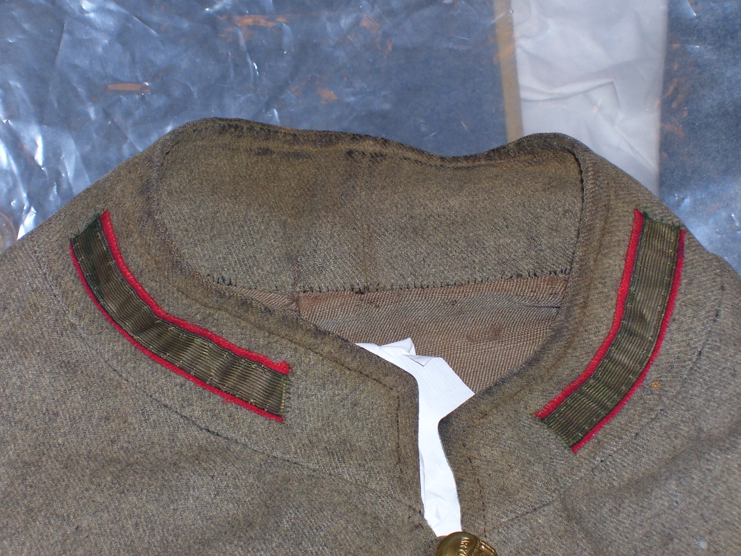

      On topstitching:
      I'm a backstitch fan, but have used a running stitch as well. It depends on the project. In looking at the Otey jacket in the "Echoes..." book, it is clear that it has some topstitching, but that's about all you can tell. It could honestly be just about any kind of stitch.
      It can be tough to reproduce an item based on a picture(s). Even with some highly detailed shots, at some point you're going to have to make your best guess. At the end of the day, if you have a reasonable facsimile of an officer's jacket, none of your pards will think twice when they see you wear it at an event. No, it ain't an exact replica. This is the "sliding scale" of authenticity that Curt Schmidt talks about. If you like it and it meets the authenticity regs of the events you attend, then it works. Others seek the exacting replica and that works, too.

        In referring to the piping on Otey's jacket I am speaking of the red piping trim surrounding the pocket flaps, etc. ...His piping goes a little beyond what is considered the norm for RD jackets. By commutation pattern I am referring to something more along the lines of a common jacket or common purchase, not specifically a government issue pattern. Otey died in early 1862, at a time when the Richmond Depots were just being issued. Wambaugh & White offer a commutation pattern jacket that very much resembles the cut of the Otey jacket.

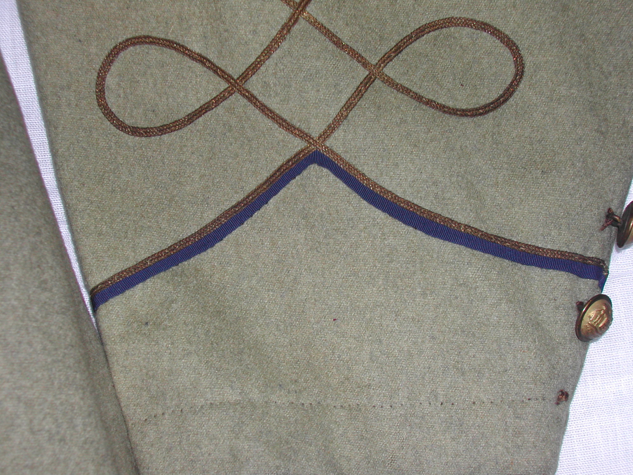

          I will try to post some of the pictures. I am having a hard time finding the button to attach photos. Could use some help on that.

            I have no specific knowledge of the Otey jacket. However, I think that your argument that the Otey jacket is likely not a reworked version of an issue jacket makes sense. "Never say never," but if he died in early '62, I think you have a point.
            In any case, I think all the red trim on that jacket was probably added at the same time, whether when the jacket was originally made, or if it was modified later. My comment on trimmed RD jackets was simply to illustrate that your earlier comment was a bit of an over-generalization. Generally, you are correct, but it is not an absolute truth. ...what is "absolute" when it comes to CS garments?!? ;)

                    Well, for the record, I pulled out my MOC Catalogue of Uniforms, in which Capt. Gaston Otey's jacket is described (for those who are now curious about this jacket)......
                    Cadet gray wool with off-white osnaburg lining, red wool facing on collar with gold braid captains bars, red wool worsted piping, 2 slit pockets with flaps trimmed in red wool worsted piping, red wool worsted captains sleeve braid, 8 button front with Block A locally cast brass buttons...Otey was wounded in May 62 near Lewisburg, West Virginia and died of his wounds several months later. Best regards, and good luck on your jacket.

                            I wanted to try and post some of the pictures you asked about before. I think I can do it now. The first picture of the sleeve is an example of what I would call the prick stitch from the earlier post. You can only see a very small stitch on the outside of the coat. The larger stitch is on the inside of the hem. The second picture, the topstitching around the collar is very close together almost touching and you can barely see anything in the back of the collar. It is pretty much the reverse of the sleeve. These were both officer coats and very well tailored.
