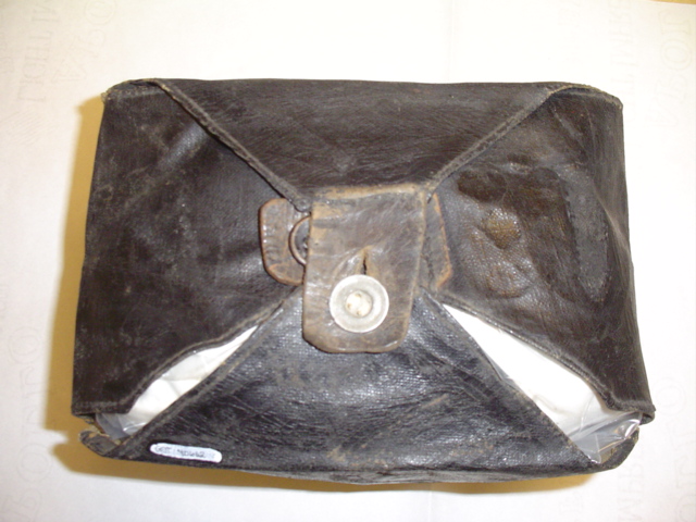

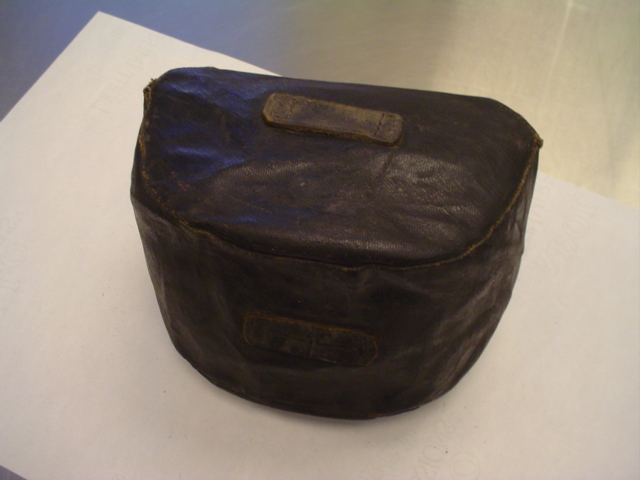

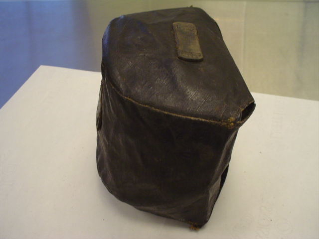

      I have also included a photograph of an original mess tin cover in the GNMP collection

              • Re: Help with I&C Knapsack
                Forgive my ignorance: How does that contraption button around the messkit? Does it fold around the back and button? Is it tarred canvas?
                Rob Weaver
                Co I, 7th Wisconsin, the "Pine River Boys"
                "We're... Christians, what read the Bible and foller what it says about lovin' your enemies and carin' for them what despitefully use you -- that is, after you've downed 'em good and hard."
                [I]Si Klegg[/I]
                  The mess tin fits into the cover and then the cover is buttoned closed enclosing the mess tin inside. The cover in the GNMP collection is of painted linen.

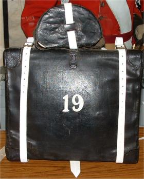

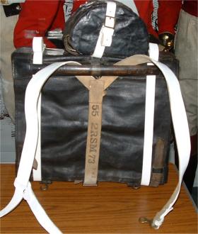

                      Although these photos are not of an American Civil War I&C knapsack and mess tin, they are from roughly the same period and of roughly the same style. I'm no expert on British goods, such as I&C packs, so if this is wrong, someone please point it out.
                      This particular set is in the The Green Howards Museum (Alexandra, Princess of Wales's Own Yorkshire Regiment - 19th Foot) in Richmond, North Yorkshire.
                        Eric,
                        Those photos help tremendously. All I have to do now is come up with a strap and I'm all set. Thank you.
