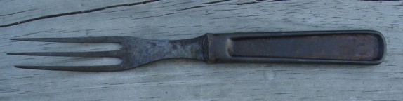

    I ran across the fork pictured below and was wondering if it was correct for our period. I've searched this forum and the web in general with no luck.
    The three tines of course are an early feature, but the 1860's forks I've seen generally have a bone or wooden handle. The handle -- disregarding the tines -- looks a lot like WWI-era mess gear. Can anyone shed any light on this?

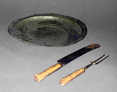

    I haven't seen this variation of fork documented to American Civil War (ACW) use, but did find a few other variations of knife and fork sets datable to the period.
    The attached image depicts a knife and two-tined fork, attributed to Union Col. John S. Crockerof the 93rd NY Vol. during his time as a prisoner in Richmond City's Libby Prison. These pieces reside in the collection of the Smithsonian Institute, and the picture was pulled from their website.
    Note: This is an older style of Silver-ware, and I believe this same style to have been used in the 18th c. as well as 19th c.
    Paul B.

        Looks to be the standard Indian War period Model 1874 issue fork.
        Steve LaBarre

              You are correct -- I found a photo on the web using your information! I bought the fork because it was cheap and I figured it might be military. Even if it won't do for our period it will fit in nicely with my other collecting interests! Thanks to all for the information.
              Bill Reagan
              23rd Reg't
              Va. Vol. Infy.
