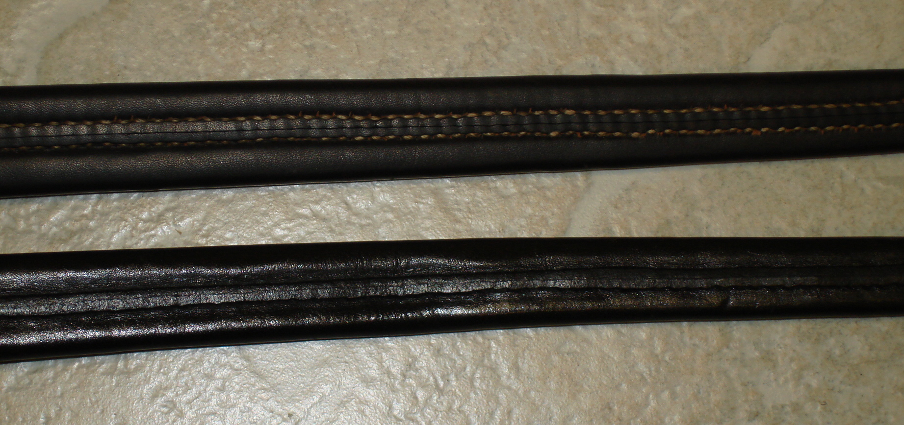

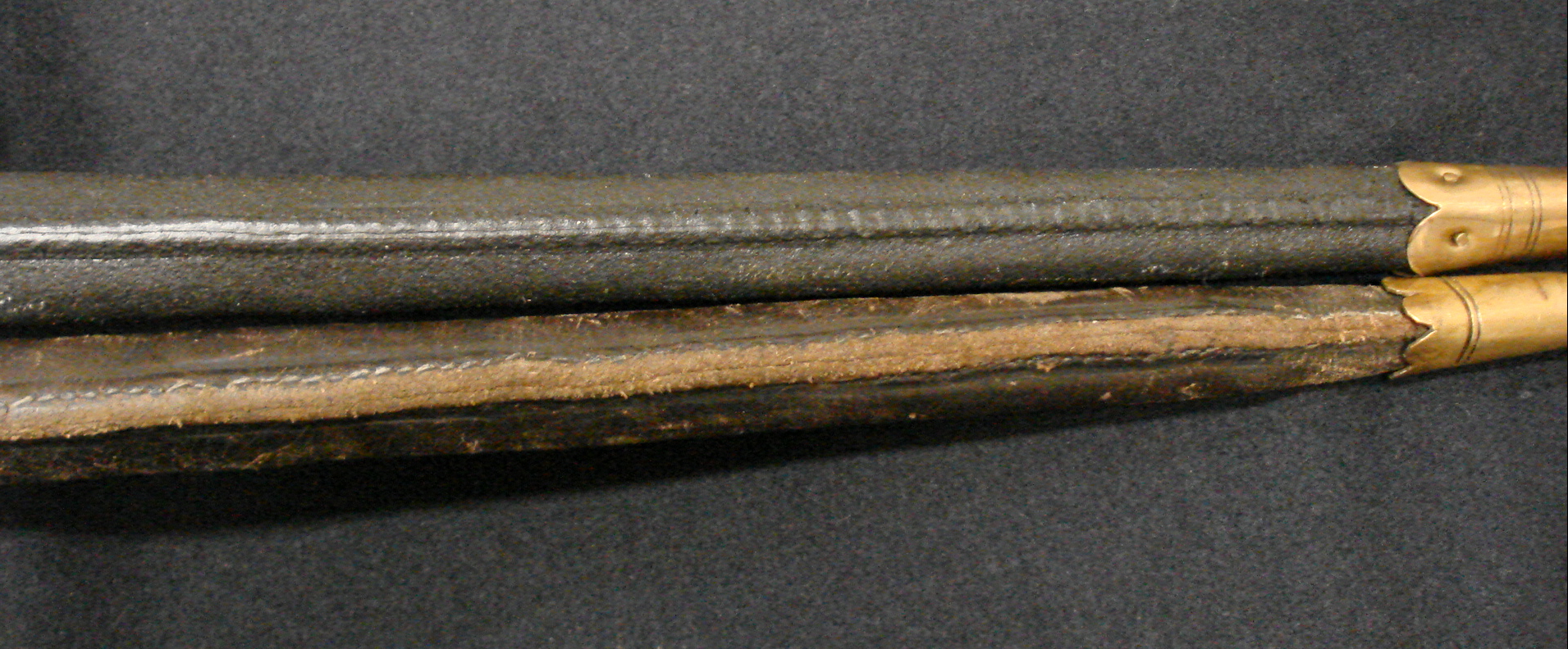

    John,
    It's tough to tell from pics, but I would say they have a welt. Whoever made them should be able to tell you how they stitched them. They look very high quality.
    Will,

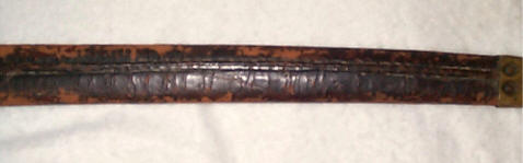

    Craig is right about the leather wearing away to expose the stitches. Scabbard C is in pretty rough condition.

        Looking at Reproduction Bayonet Scabbards
        (I have merged two threads together. On rereading, one thread on this made more sense than two... Sorry if it is confusing to read. Thanks!)

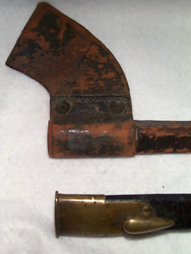

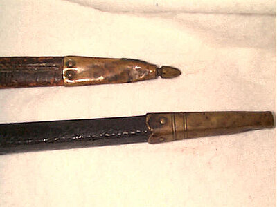

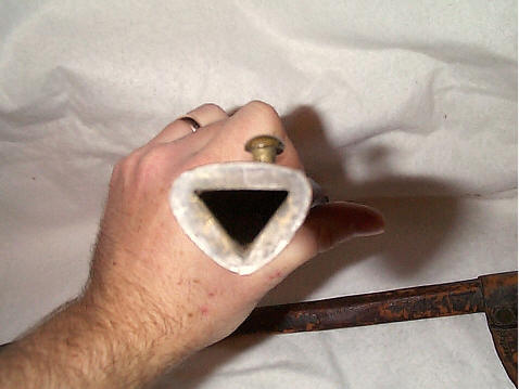

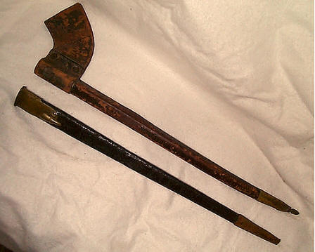

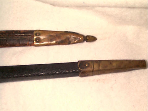

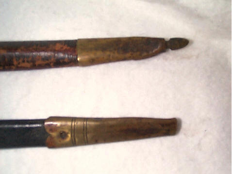

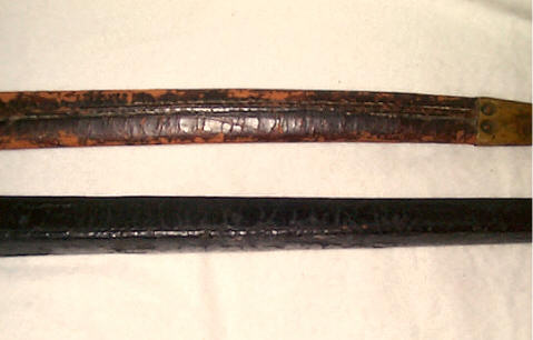

        Here two more reproduction bayonet scabbards from two different makers.
        The first two are from the initial post.
        The next two are attached in the thumbnails, below.
        Enjoy!

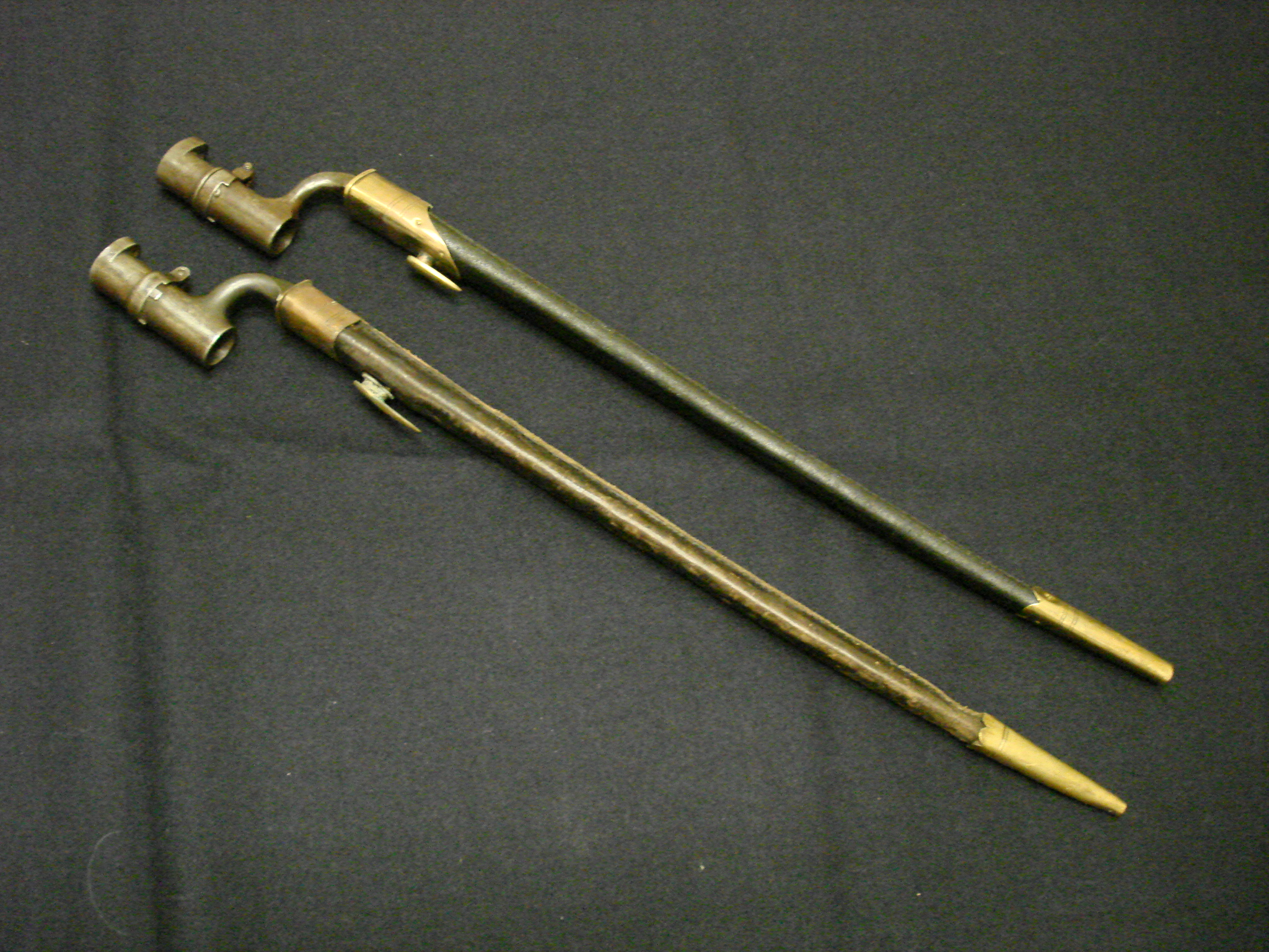

          The above were Federal style scabbards. Here are two different Enfield reproduction scabbards.

            Hi John,
            I don't mean to be rude, but what is the point of this thread? There was no stated purpose why these are posted.
            Is this just for comparison sake? Is there a control sample of an original to compare these against? Or are they being compared to each other?
            I would be happy to post pictres of an original Enfiled bayonet scabbard and an original US 2 rivet scabbard for comparisons

              Re: Looking at Reproduction Bayonet Scabbards
              Don,
              No, you're not being rude. My apologies!
              I had stated in the earlier thread (I think) about orginal scabbards that I would follow up that thread with one to examine reproduction scabbards. Time passed, stuff happened... I finally took some photos to use as examples ... more time passed... then last night I had a few minutes to get the posted. So, I threw the thread up on the board and didn't take the time to say what the point of the whole thing was.
              It bugged me, but I haven't had the time to do anything about it til now. So, you are quite correct... I should have put more info behind the post, rathrer than just "pics in a vacuum".
              So, here's the point...
              Kinda like the repro buttonhole thread, I had intended that this could be a chance for folks to look at some repro items and comment on what they see and compare to some original examples (original examples posted on the other thread).
              I have kept "name brands" out so the label won't cloud the view of the discussion.
              That's all. Again, my apologies for the vague posts.
              PS - If you have pics of originals to post for comparison, that would be great! However, I would recommend posting pics of originals on the other thread (the one on original scabbards, linked in the initial post of this thread). Thanks!!!

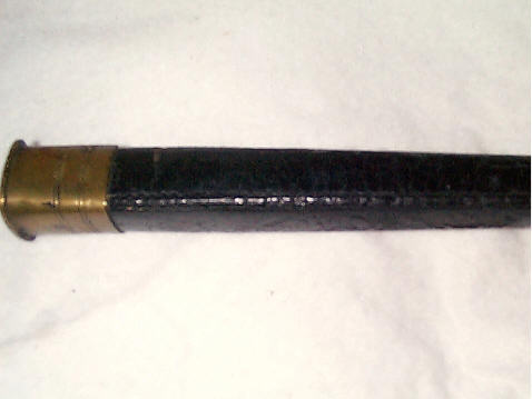

                      HI All

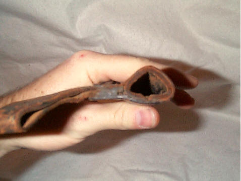

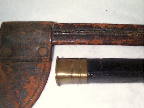

                      Here are pics of the Original Enfield and Original 2 Rivet Scabbards I own.
                      The 2 Rivet is a little worse for wear but complete.
                      The rivets are a little larger than what is sometimes encounterd, more than likely were set with a ball-pean hammer originaly (I know this due to the tool marks on the rivet & from experience in machine shops working metal).
                      It may have started out as an earlier all sewn type and then was retro fitted to meet regulations or was a contract variation.
                      The Enfield is more straight forward.
