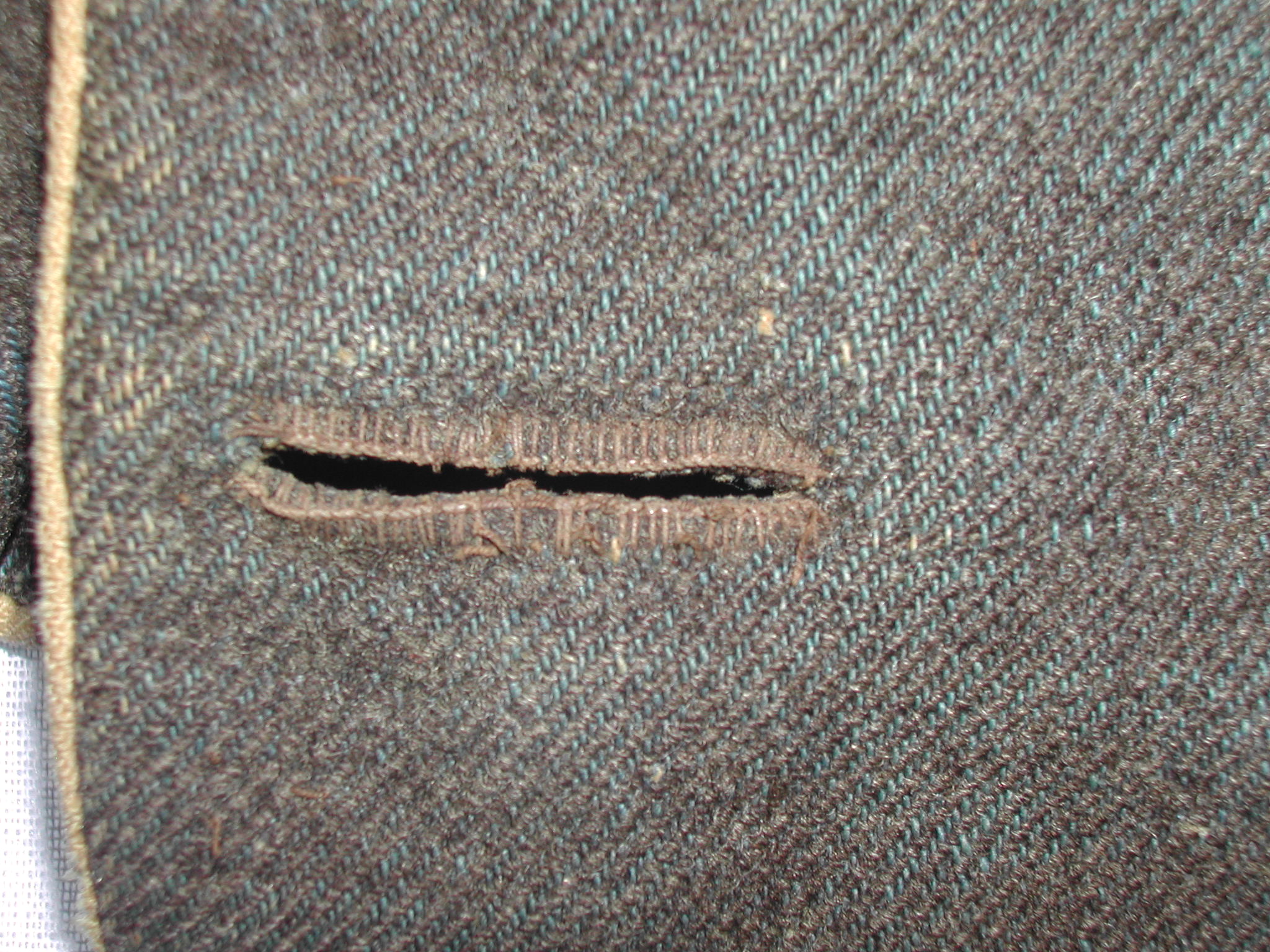

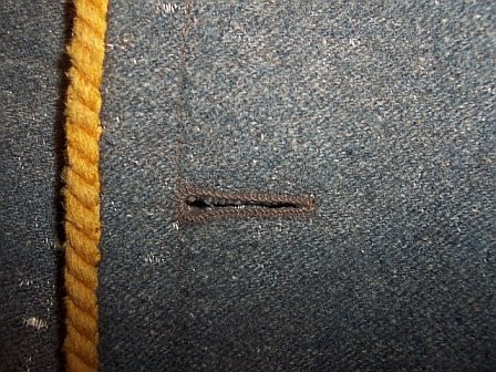

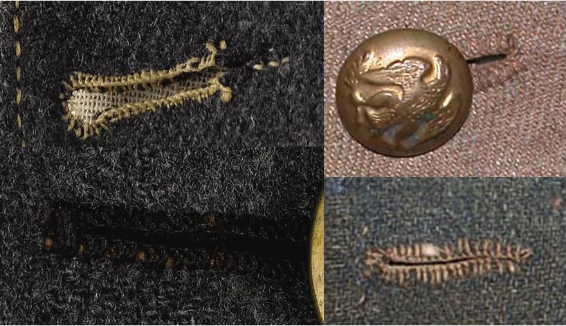

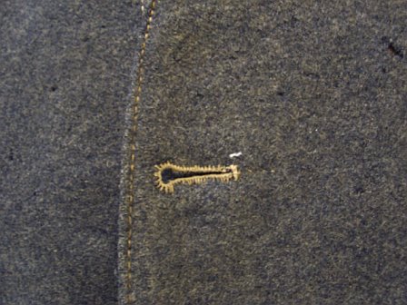

    Often, it is hard to judge the features on a given reproduction because one might not have had the opportunity to view original examples. Here are four examples covering a variety of enlisted items, and an officer-grade coat:
    Clockwise from top left:
    Tait jacket, McDill jacket, kersey RD2, officers frock
    If others have examples, it would be great to see them.
    (I labeled this thread "CS", so it might be a good idea to use a different thread for US items)
    Last edited by Eric Tipton; 12-19-2007, 03:30 PM. Reason: Removed embedded image and kept thumbnails - front page formatting.

    John,
    Thanks for posting these pictures - these kind of close ups are very helpful. I don't have access to originals and seeing this information is of great value for my winter sewing project currently underway and those I hope to do. I feel much better now on my own button holes too!
    Would you have some topstiching close ups besides what is shown on the Tait?

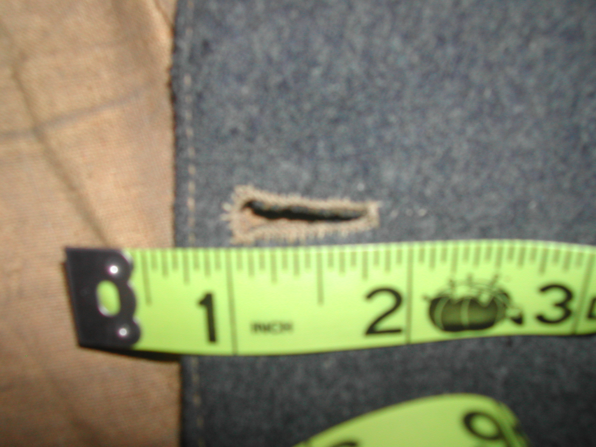

      Re: Reproductions: Looking at Buttonholes (CS)
      John,

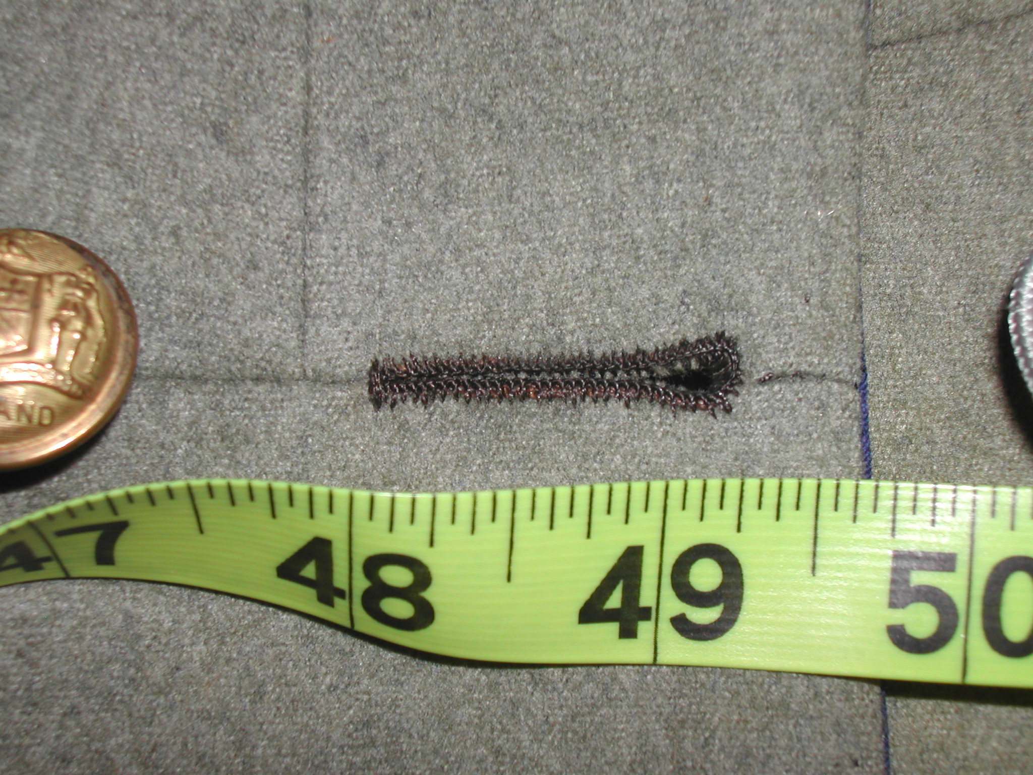

      These are the best pictures I have. Some of my others are little blurry. Because the pictures didn't turn out great, I made scetches when at home when they were fresh in my mind. I will check to see what I have at home (I am sending these from work). Hope some of this helps. I would like to see more of this type of discussion and posting of detail items. My interest is more in clothing, but other topics like leather work would be great.
      Rob Bruno

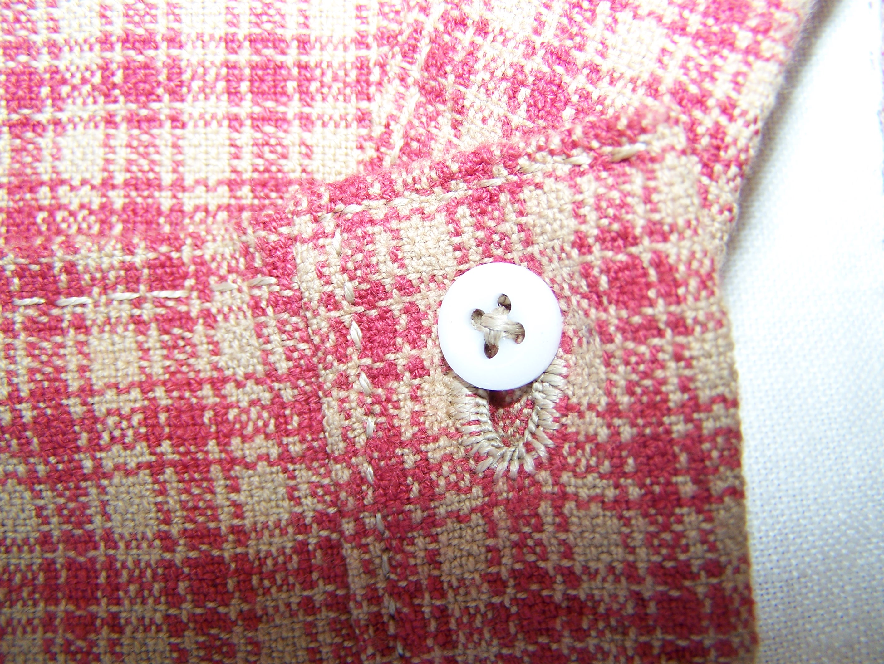

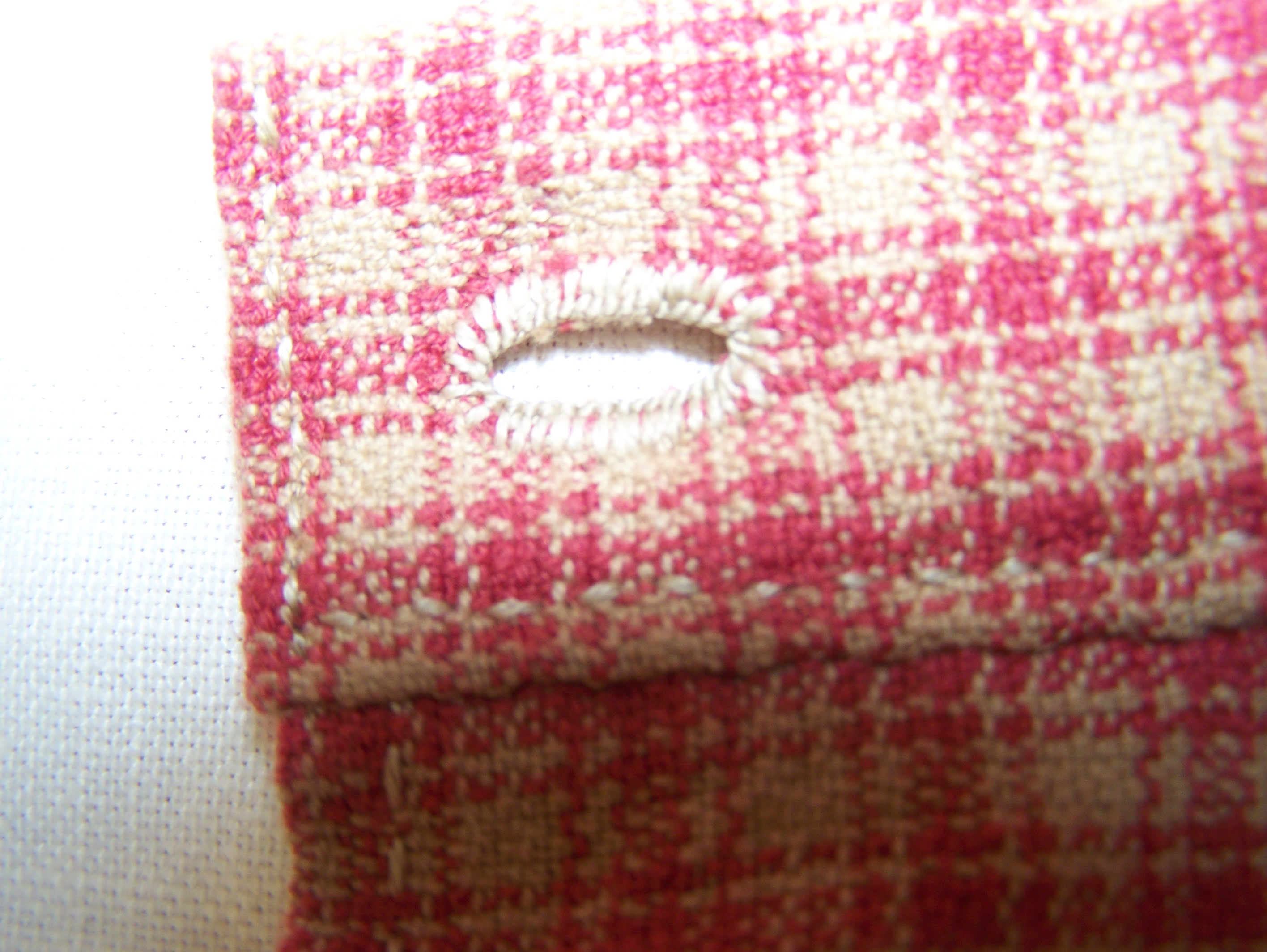

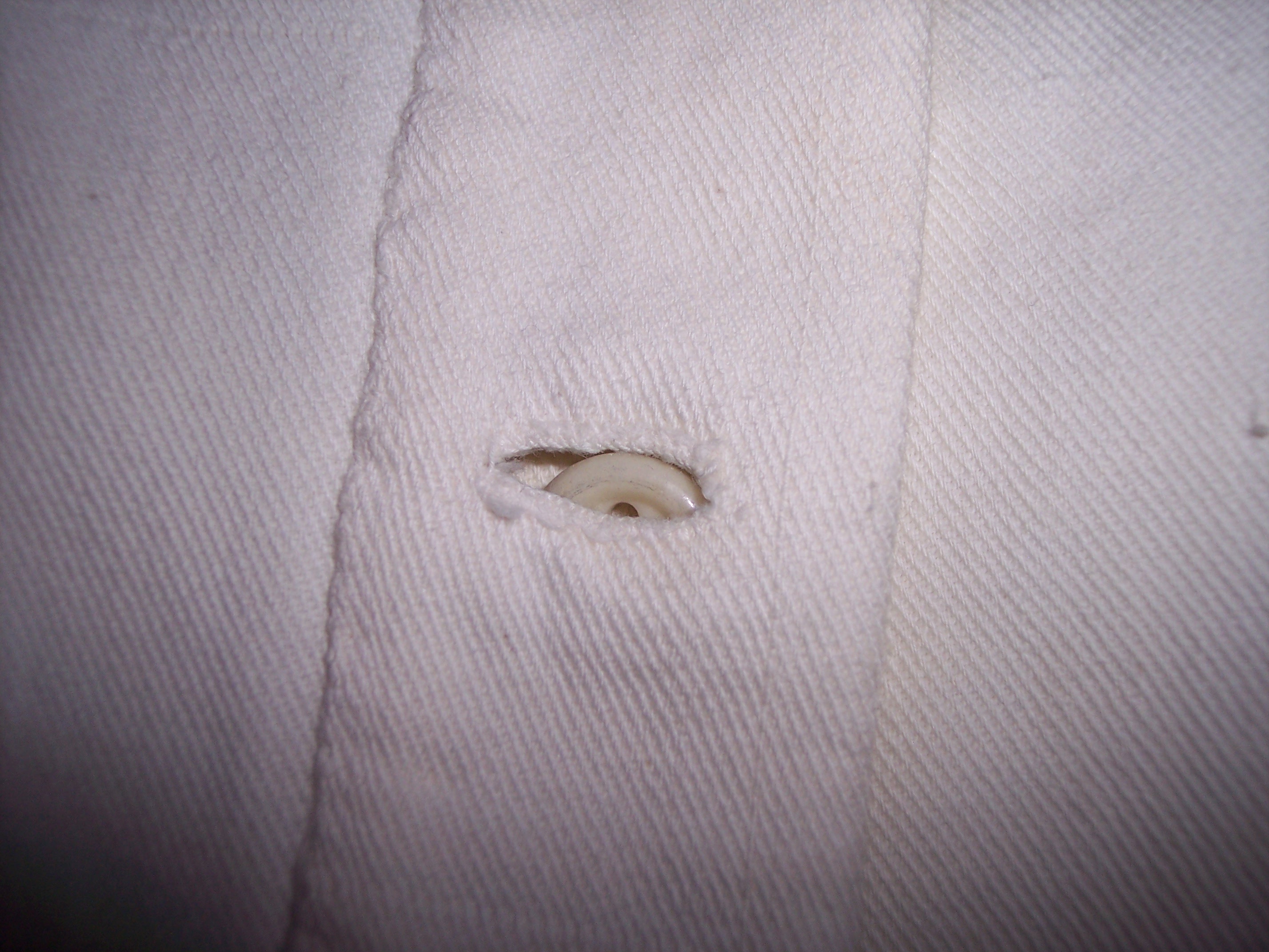

        I thought I should add some pictures of buttonholes I have done a civilian shirt. I think the nature of this thread is to see originals and compare to repro. These are on a shirt with much thinner material than on a jacket that pictured. So, when I do a jacket they may look different. I will interested to hear what people think. I look forward to more comparisons in this and other threads.

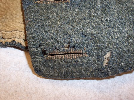

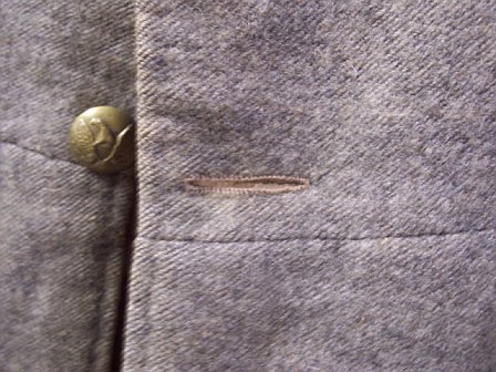

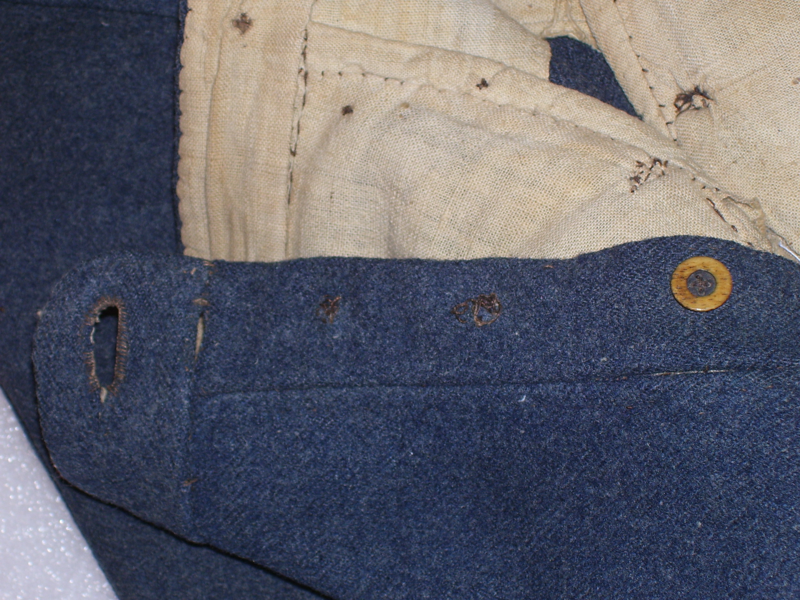

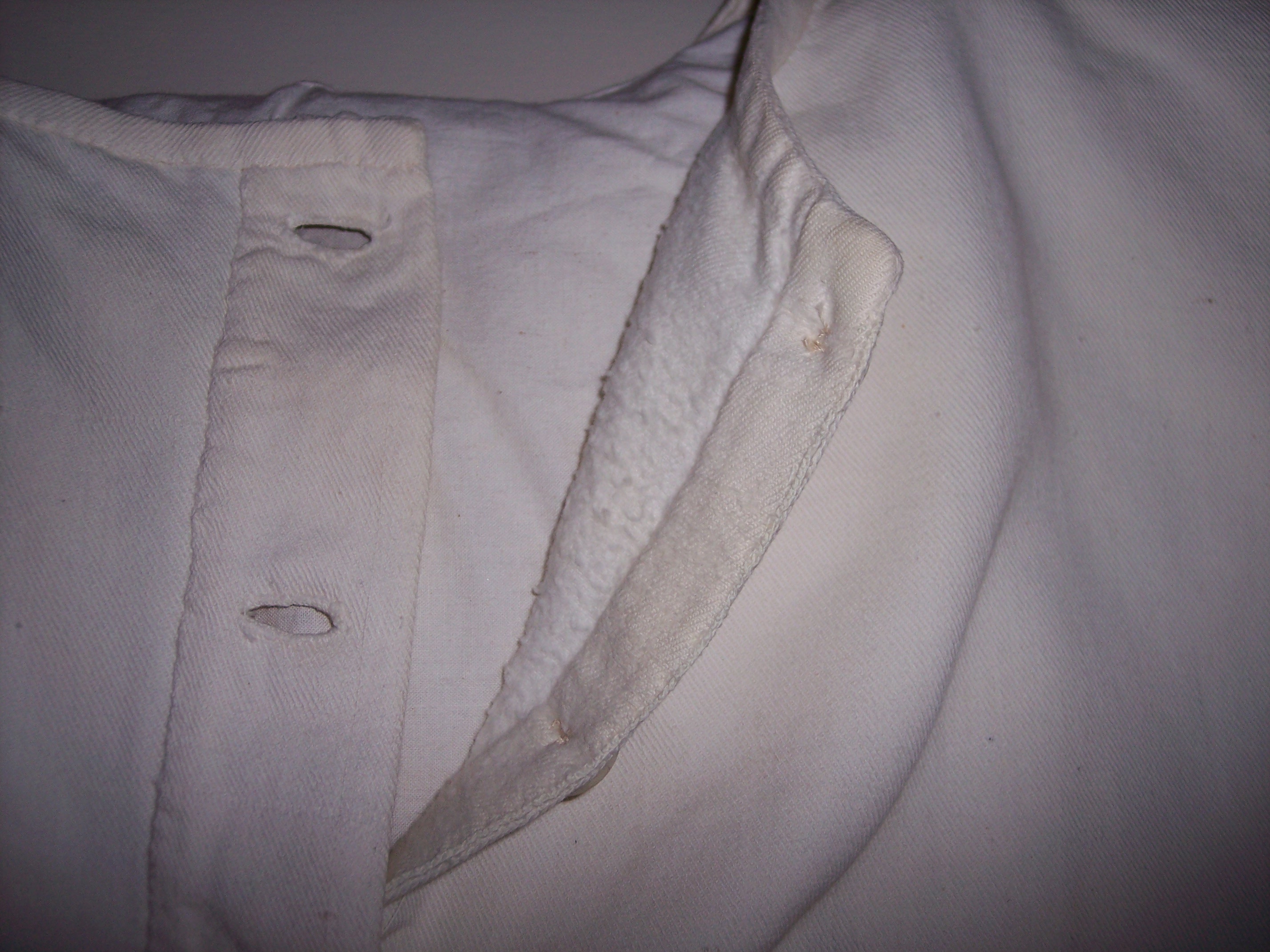

          OK,
          Here we go. A good many pictures here for everyone to view. I'll add commentary on the garment's history, etc. in a second. Hope this aids the discussion. There's nothing wrong with the hobby, we just need a healthy dose of study!
          Cheers,
          Neill Rose

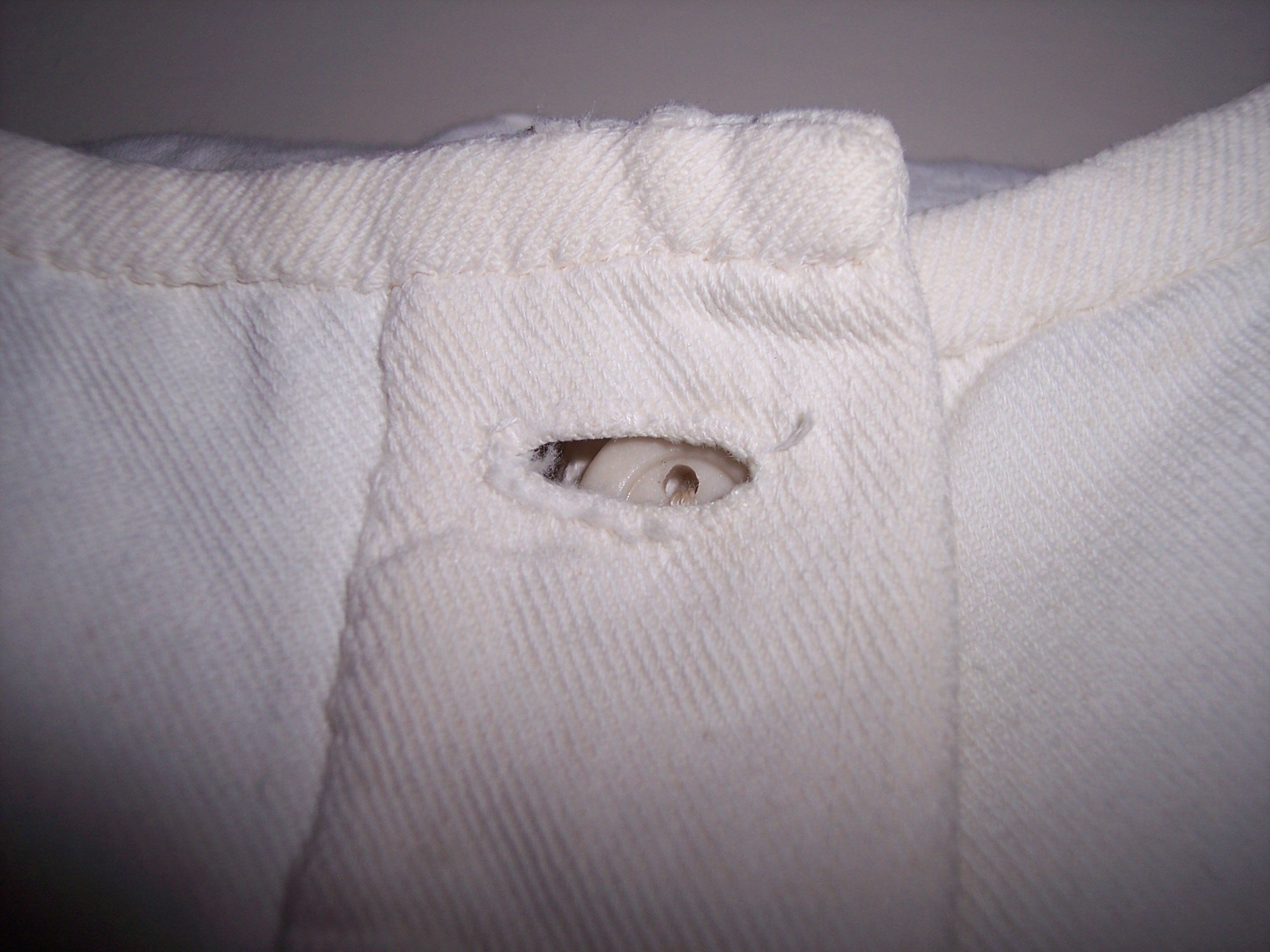

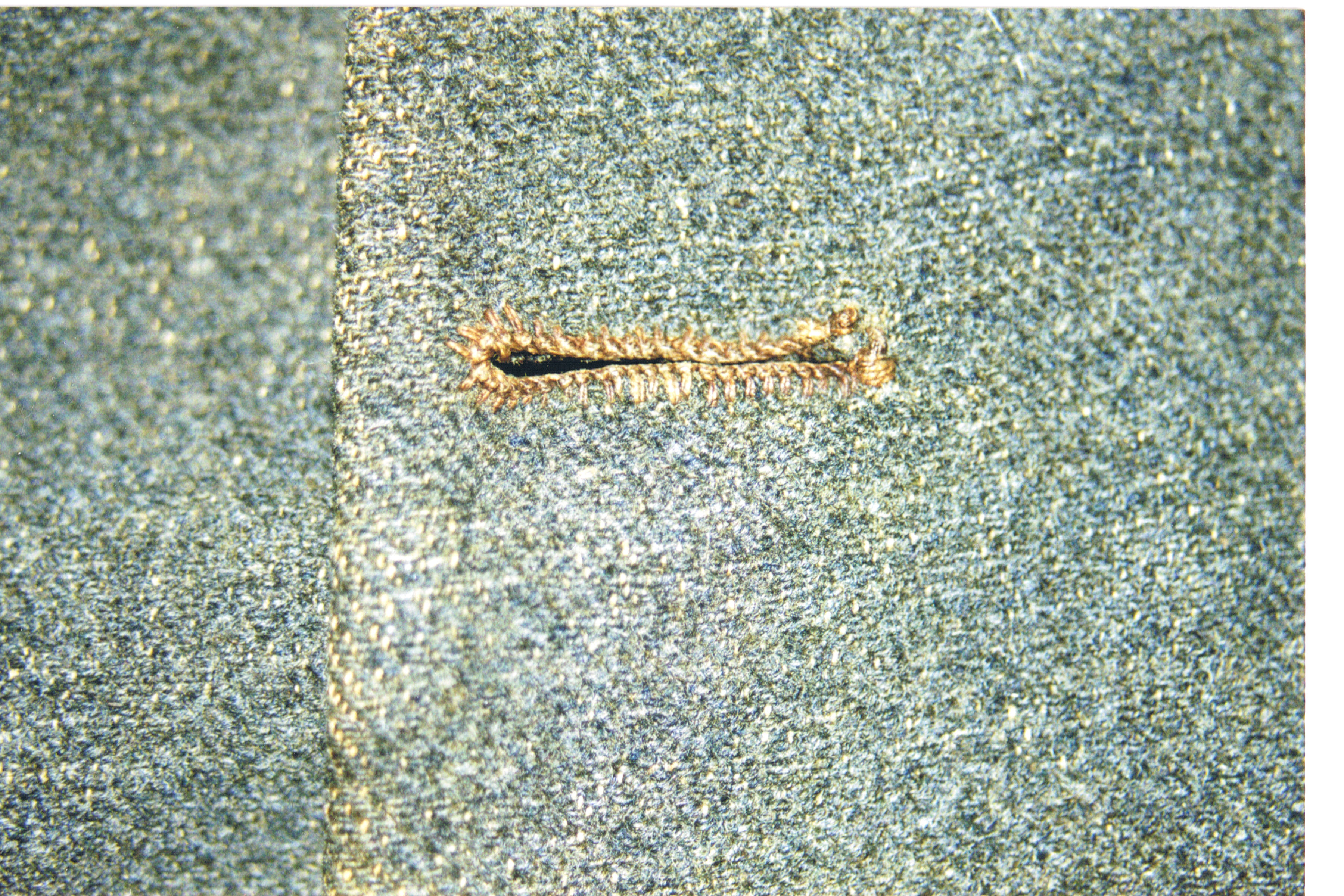

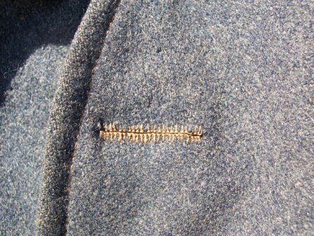

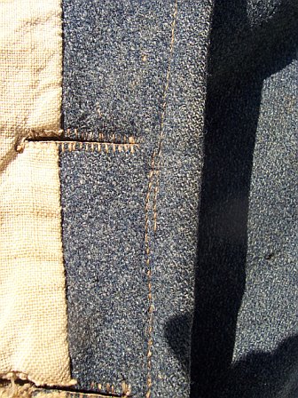

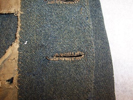

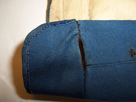

            Folks,
            Here's the last one for right now. These are just some off my desktop image program(s); I'll grab the CDs next.
            Neill Rose
                Neill: THANKS!!!!!!!!!

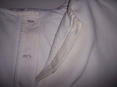

                Folks rarely consider the view of the button hole on the inside of a jacket, so those pics are especially good.

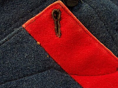

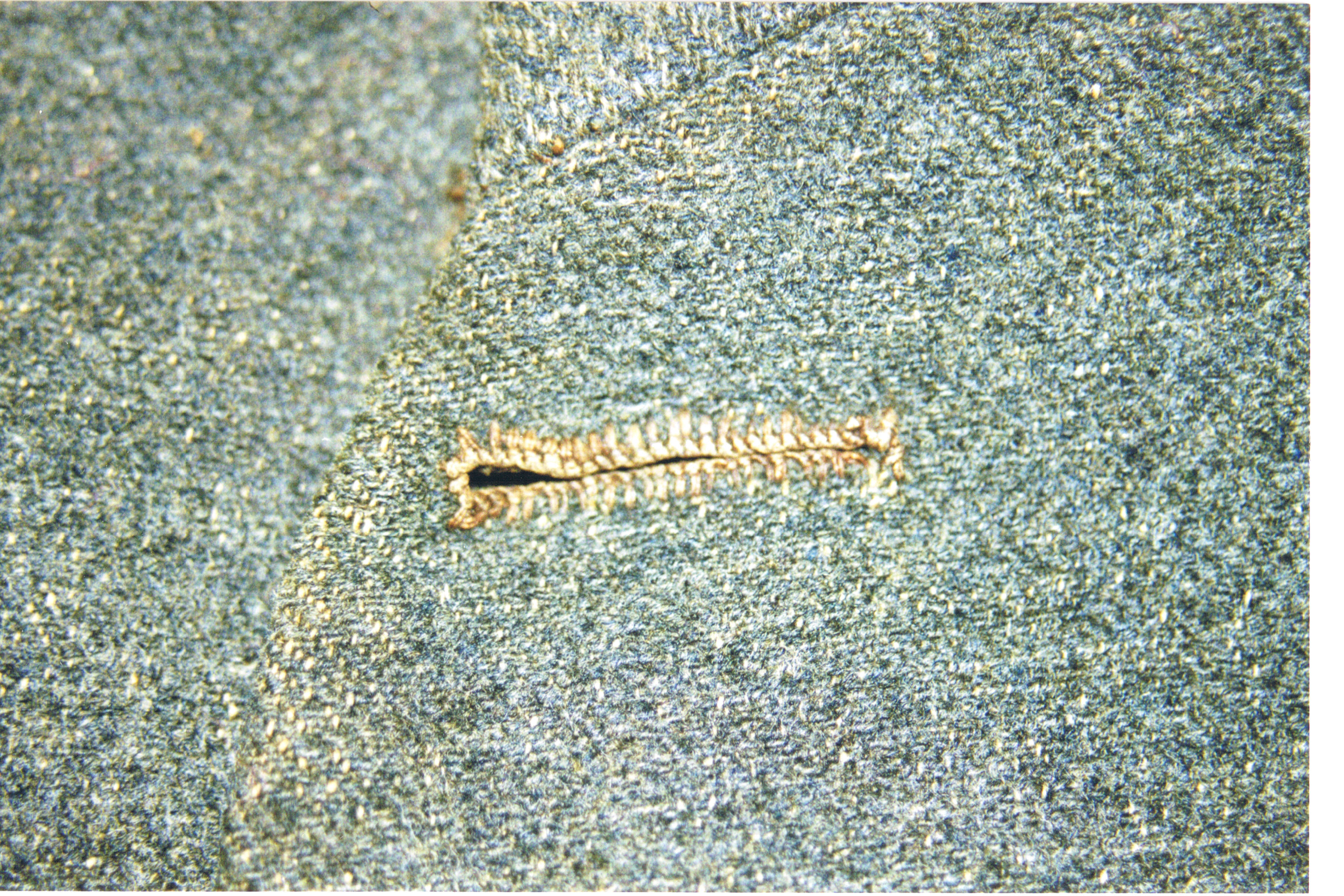

                All,

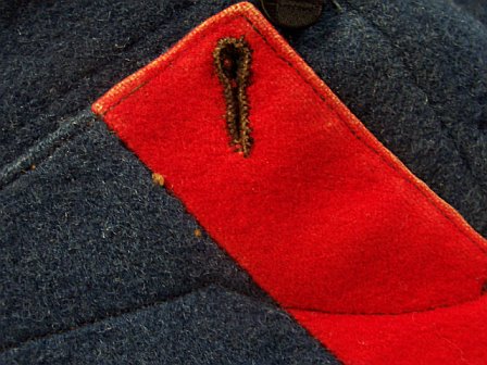

                Here is something interesting that I am seeing among all these pics of original items...
                On the side of the button hole nearest the edge of a given coat, each of the these button holes all appear to have either a "fan" or a "keyhole" shape. However, on the other end of the hole, I see them ending in either a bar-tack or "nothing" ...no fan, no bartack... just the stitching on either of the two sides, but nothing on the end.
                Am I viewing these correctly?
                ...and on the bartacks...

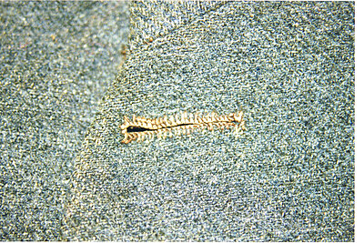

                each appears to be nicely finished by a blanket stitch as described by CJ Daley here on page two of this thread (reproduced by John Taylor after a crash wiped out an old 2002 thread):
                ...on the Tait jacket...
                It is interesting to view this buttonhole in its unraveling state. You can see the stitching laid out along the perimeter before the buttonhole stitching itself was applied.

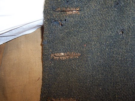

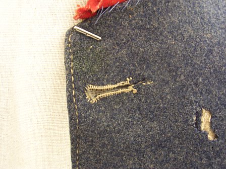

                    Look at "Iron Scout's" (Neill Rose) 11:00am post. Pics #6 and #10 show buttonholes from the inside of the jacket. ... a very dandy English kersey RD2!!!
                    Regarding the "Keyhole"...
                    They were done both ways (what I have referred to as "keyhole" and "fan"). In my limited experience... It appears that "keyhole" style buttonholes are more a feature of either higher grade clothing or industrially-made garments (as with the officer frock and Tait jackets shown in this thread). I may be completely out-to-lunch, but that's what I've noted within the limited scope of my experience.
                    Somewhere, I have seen a great pic of the original Bomar frock showing a buttonhole with bartacks at BOTH ends! Very unique, at least in my very limited experience.
                      Here are the basic button hole stitches for the Bottomshirt from Gettysburg. They have strectched over the years and show the typical effect of passing the button through the hole. The holes measured a little larger than the button itself, so I suspect (though we may never know) that they were actually the same size or a little smaller when initially made. I believe this is what gives them their somewhat oval shape. In making modern renditions, the material has alot to do with how the button hole turns out. Pulling them perls to tight will inadvertently cause the edge of your button hole to "roll" and make the hole larger than what you really want it to be.
                      More to come when I dig out the CD.
                        John,
                        Also in my limited experience, the "keyhole" end is found on the more tailored garments. Most of the officer frocks and tailored shell jackets I have looked at had this type of buttonhole. Some also had a piece of thread on top of the material and then the buttonhole stitch going over top of it. Someone told me this was done to produce a more finished stitch that did not sink down into the thicker material fond in coats. I think the link to a past thread from CJ Daley describes this. I have tried to do this type, but my fingers are not nimble enough to do this one yet. I think the depot jackets had the plain buttonhole stitch that just went around the opening of the fabric. As we can see, I don't think any of the pictures are same, although they all use the same type of stitch. So, getting back to I think the first point of this post, how do we look at repro garments and say they are authentic in the button holes? Again, just look for period construction techniques? Or, is there a quality standard for the use of the construction techniques?

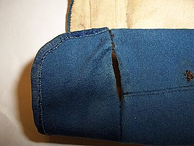

                          Here's two more images off of Lt Walker's Charleston Depot jacket at the UDC Museum in Chas.

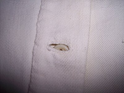

                              Here's a button hole from the MacRae shirt (EOG: Confederate) in the NC Museum.
