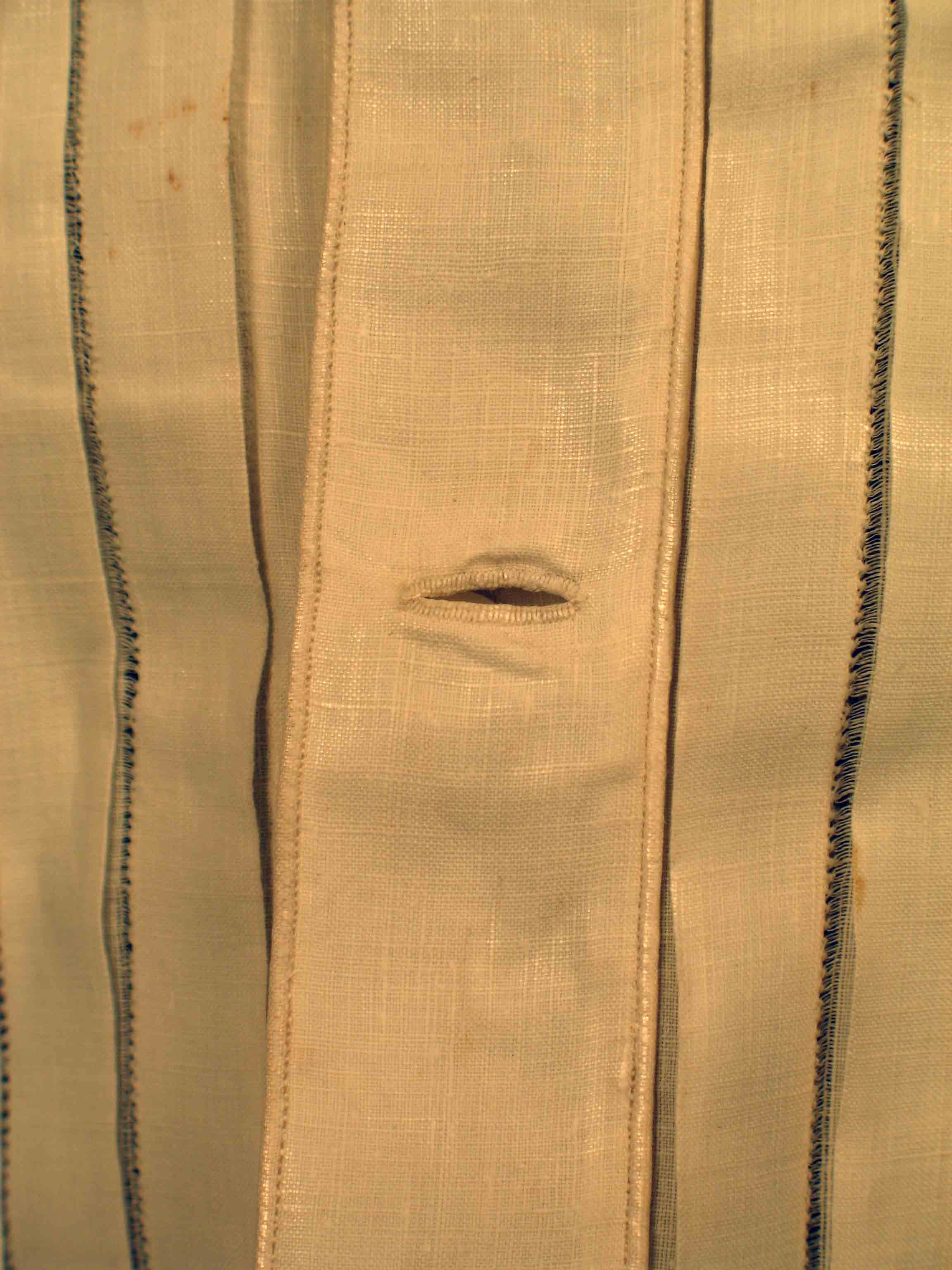

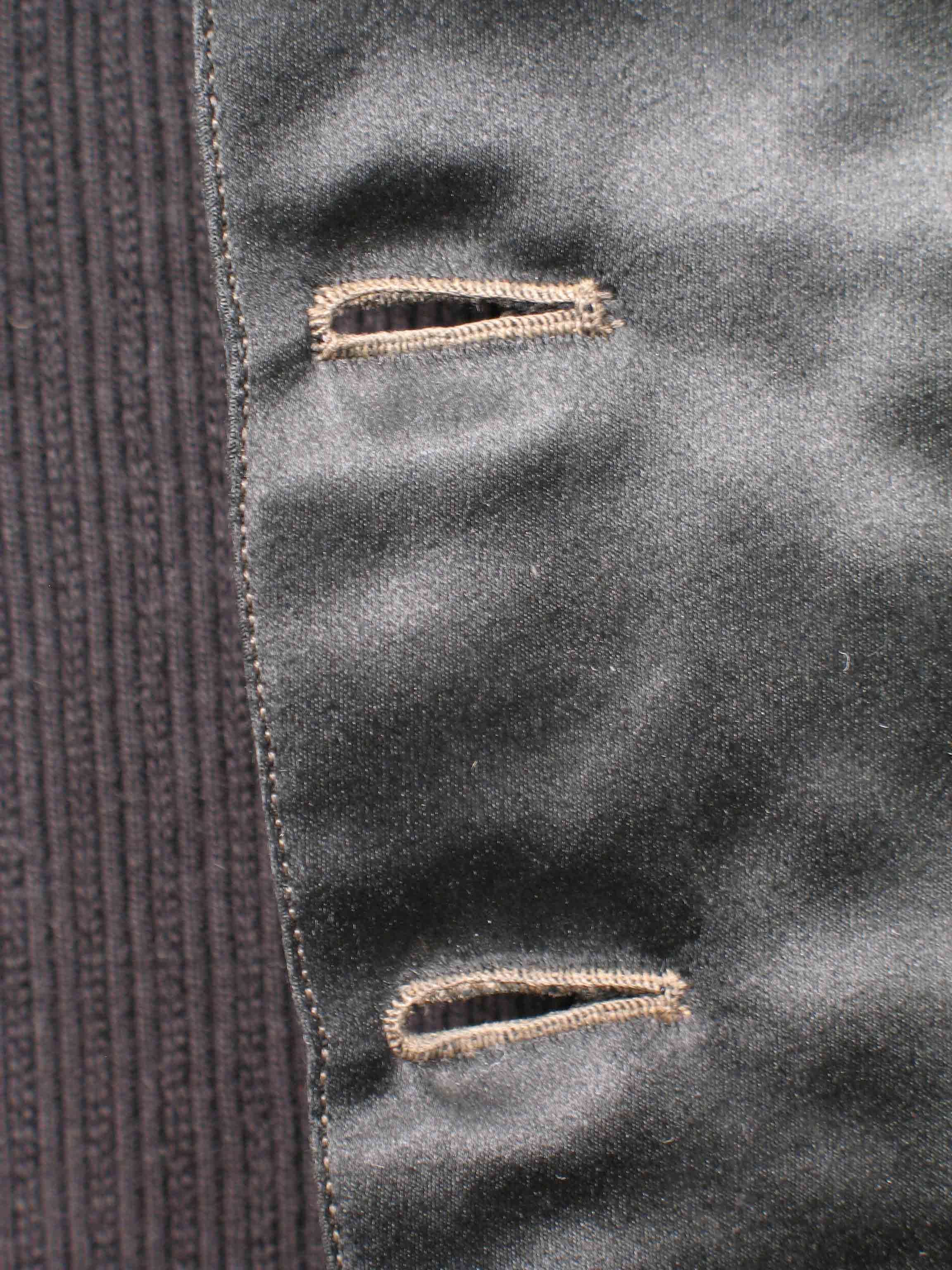

          These buttonholes are from civilian garments, not CS uniforms. However, they are typical of the buttonholes I find on many civilian garments - male and female - and show the skill and expertise of the sewist/tailor.
          The first image is one of the buttonoles on an original pleated front shirt c. 1850-1860. Each pleat is accented with drawn thread work. The length of this buttonhole is 3/8 inch.
          The second image is a buttonhole from an original silk satin vest. The length of this buttonhole is 7/16".
