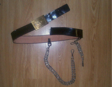

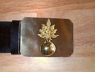

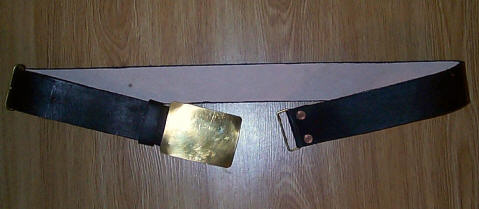

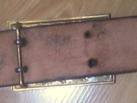

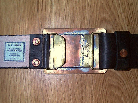

        HI All,
        Here is a plate I did up for myself for a Militia Officer Sword Belt. The plate it self is stamped off of an original set of dyed and is gold gilt.
        These belts appear both on enameled leather belts and on white webbing

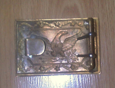

          Re: Correct Die-Stamped Militia Plate Reproductions

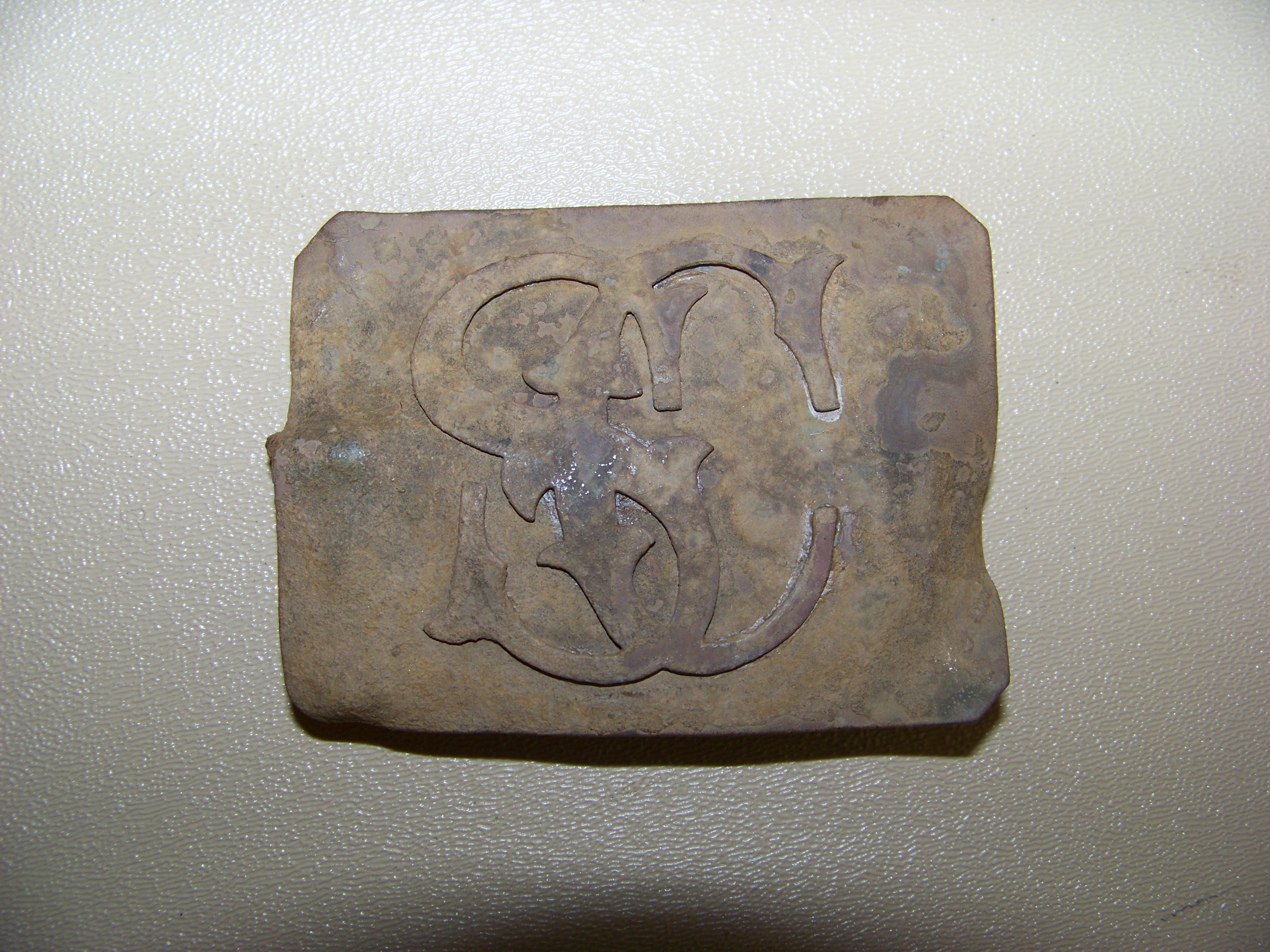

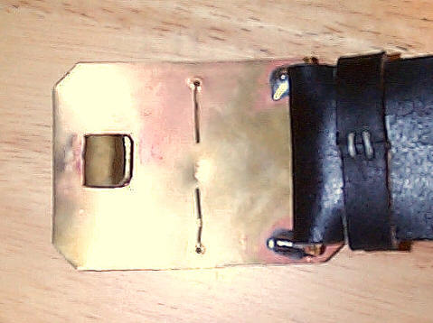

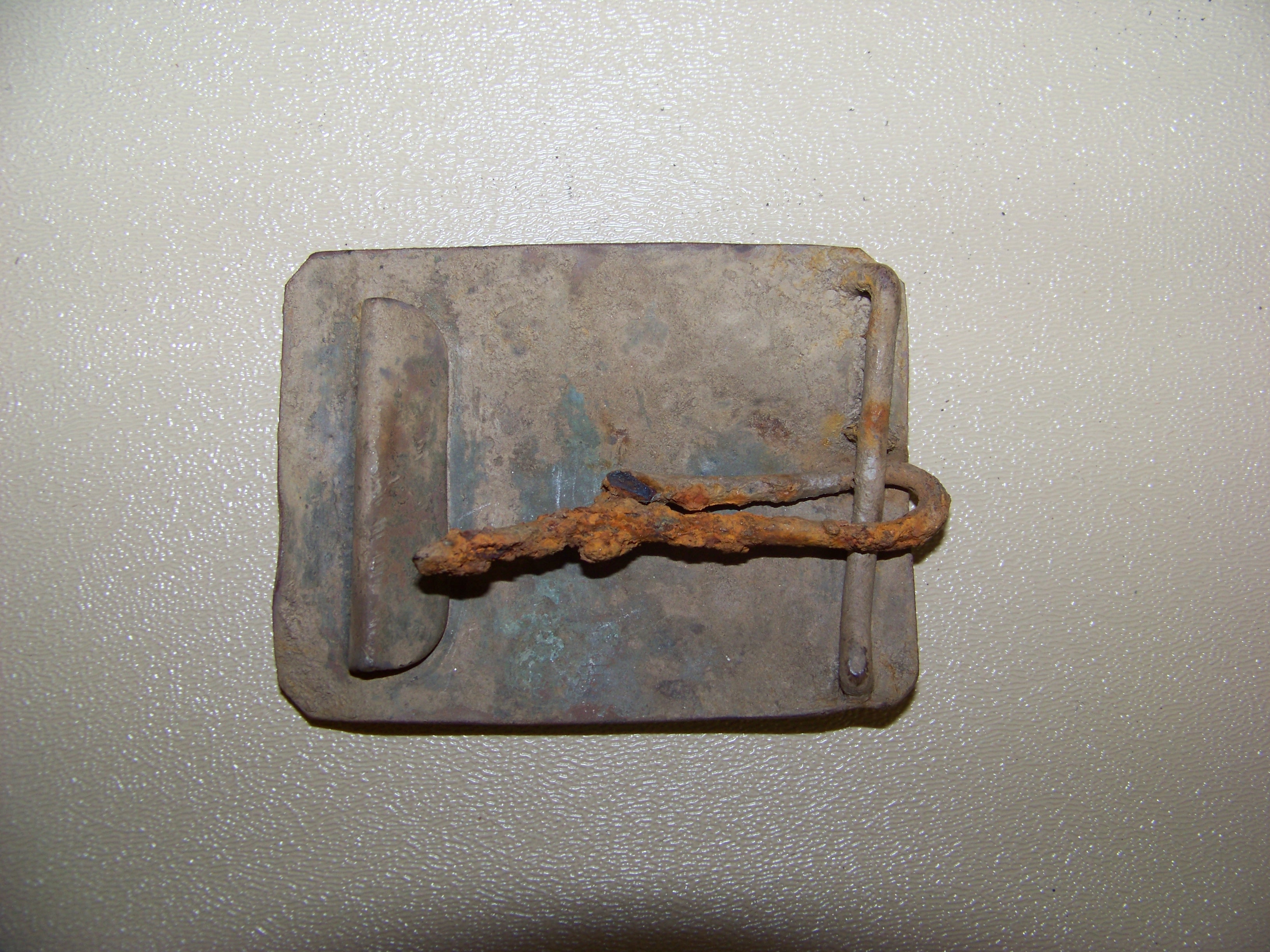

          Don,
          Thought you might like to see this. This plate came out of the ground several weeks ago in Pendleton, SC. While many would say the larger/longer tongue is indicitive to a later, post war plate, several other pre-CW items were unearthed nearby. Needless to say, this is one of the best plates I've ever seen with the applied SC, etc. Neat stuff.

            Hi Neil,
            Wow! what a nice example of a SC plate!
            It is intersting about the back on it. I too have heard the statement that this particular back is post war. Although Silvia & O'Donnels book on plates shows that it largely depends on "which" plate has theis back as some have very, very solid pre War and earliy war provenance.
            I have heard this type of wide tongue arangement "French Fastener" or " French Hook"
            I have a war time Officers Plate with this same arrangement. Initially it was thought to be post war , but one was dug from a site with solid provenance re dating the plate.
            I am amazed the the SC plate shoes thatt he "SC" portion is still keyed to the back of the plate. Is it wired into place?

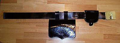

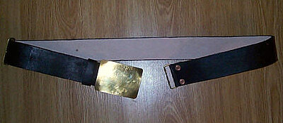

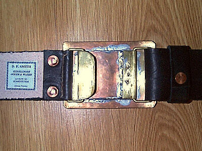

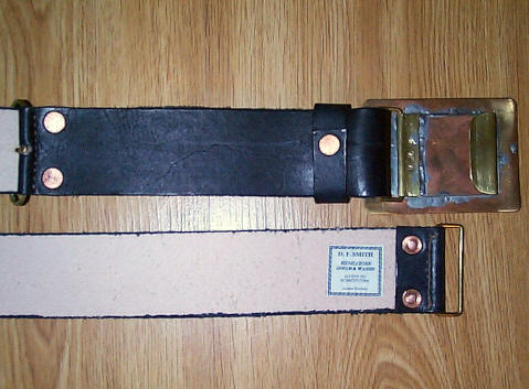

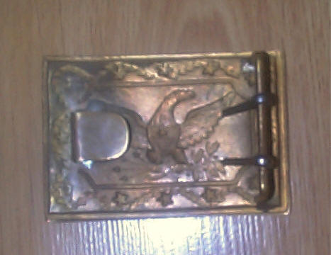

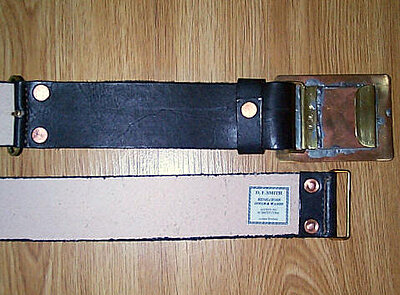

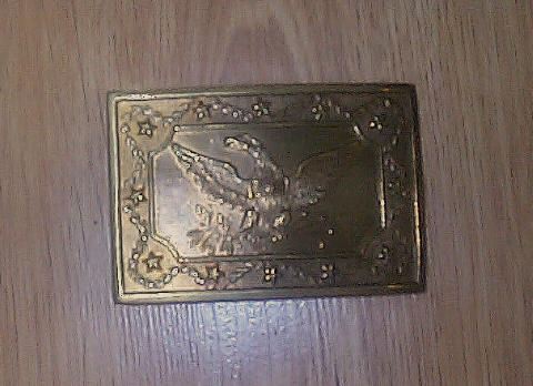

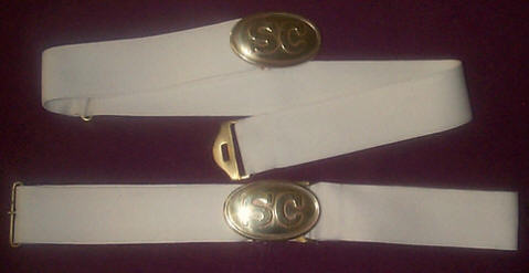

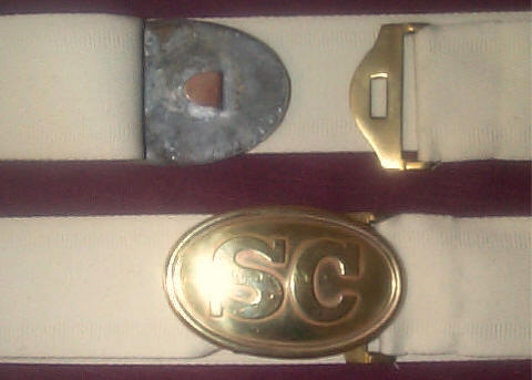

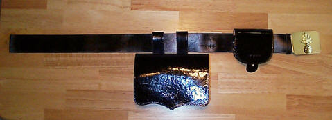

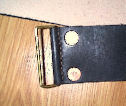

                I almost forgot,
                Here are some examples of Militia plates and belts I have done for customers on a custom basis, based on originals
                Pictured are:
                Belt I made for a fellow portraying an early 9th NYZ Hawkin's Zouave
                SC Milita Belt & plate , based off of photos Neil Rose posted and email & PM Converstions with him
                Early US Militia Belt with "French Fastener" plate and keeper

                  Hi Jeremy,
                  I can make most any militia plate ( I have a back ground in metal working , among other things) I love to make these . Just because of the shear variety of them.
                  The SC Plate shown by Neil is a bit tricky to make . It consists of a cast or die cut 'SC' more than likely "sweated" to the plate face with solder. Some were "Keyed" to the plate face by soldering a loop to the device and cut a slot in the plate face . By wich, the loop was passed through and the device held in place by a small leather "key" that slipped into the loop.
                  The reason for the "key " as two fold. It developed was so that the plate could be dissasembled for cleaning, as well as a way a manufacturer could offer and make several differnt types of plates very easily by interchangeable devices that could be indexed to a single type of plate body.
                  There are several differnt types of these plates in collections that have been dug with out the front device, that either was lost, or was separated from the plate at some point. Leaving only a plate body with a slot or two in the front.
                  I can make this plate by very carefuly hand cutting the appropriate metal to the shape of the "SC" and sweating it or "keying" it to the plate. It would be a bit spendy just because of how labor intensive the hand cutting and finish fileing would be on the "SC" portion as there are no repops of that particular stamping around. (est $75-100 for the plate).
                  Other Militia Plates are eaiser to reproduce as the stampings are avilable still off of the original dies or high quality thin castings are available. Cost for most types of Militia plates with a device or fancy stamped types are around $35 and up.
