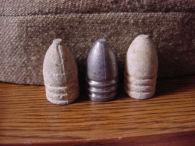

            Andy: Is the one in the middle close enough for your needs? If so, it is cast from Lyman .575 213OS mold. "OS" stands for old style. I believe another maker also makes a mold for an old style bullet but I can't remember who it was.
            Jim Mayo

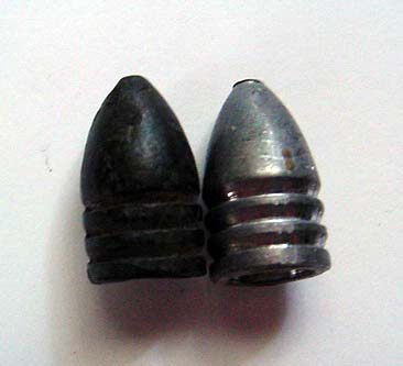

              Non-dug original and reproduction 575OS
              Here is an original and the modern reproduction. The rings are a little more narrower on the original .
              Jim Mayo
              CW Show and Tell Site
                Re: Authentic .58 Minnie Bullets
                Thanks for the good photos, Jim. The Lyman "Old Style" minie that you pictured is the closest I've found to an original in a commercially produced mold. The only obvious flaw is that it's a little short and has the flat top caused by the nose cast sprue cutter. We need someone to cast about 200 of these, solder a glob of lead to the nose and then lathe turn them so they'll look like the original pressed (swaged) bullets. Any volunteers?
