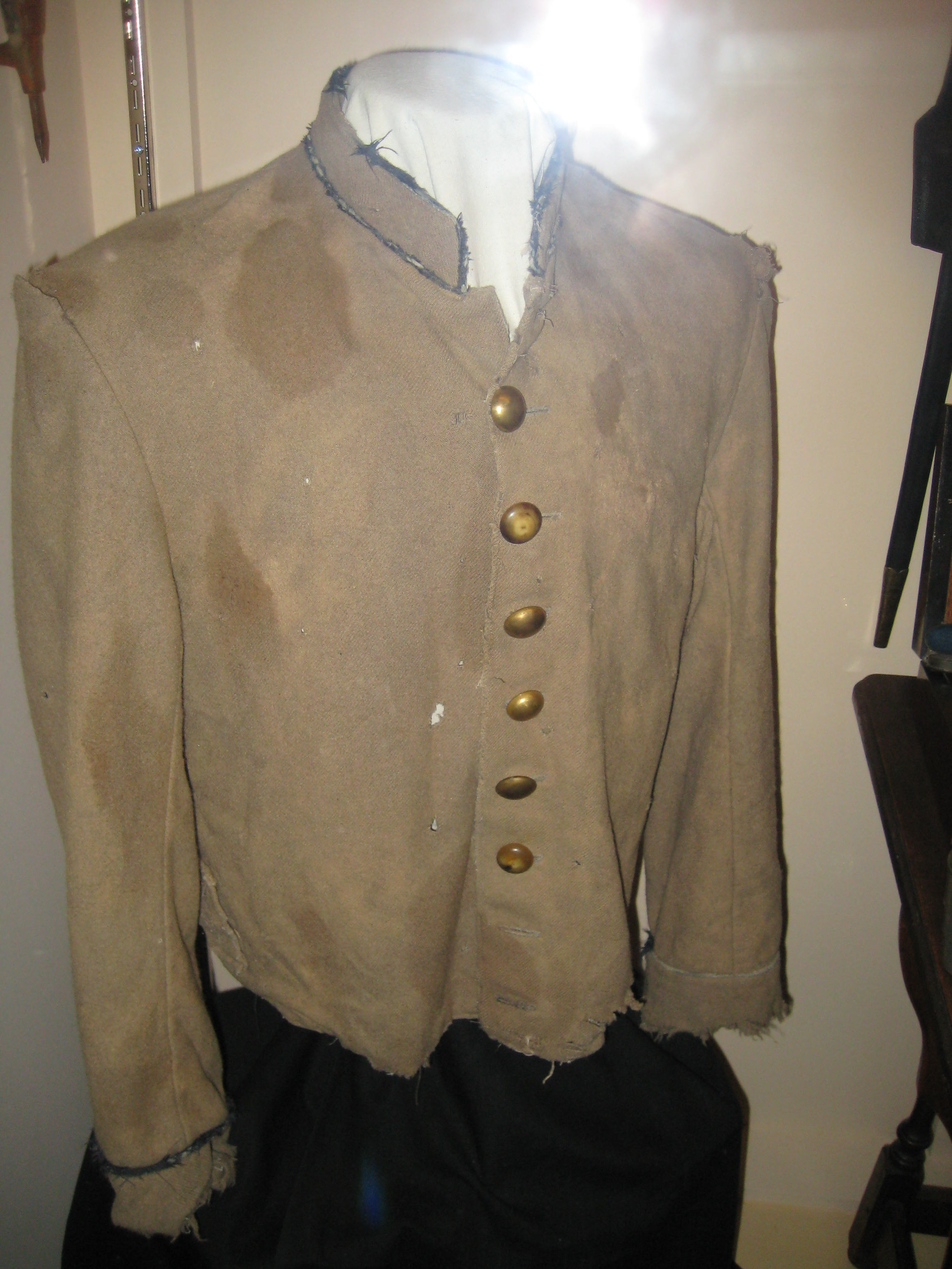

        Andrew,
        Some soldiers would cut off the epaulettes... check out this photo.

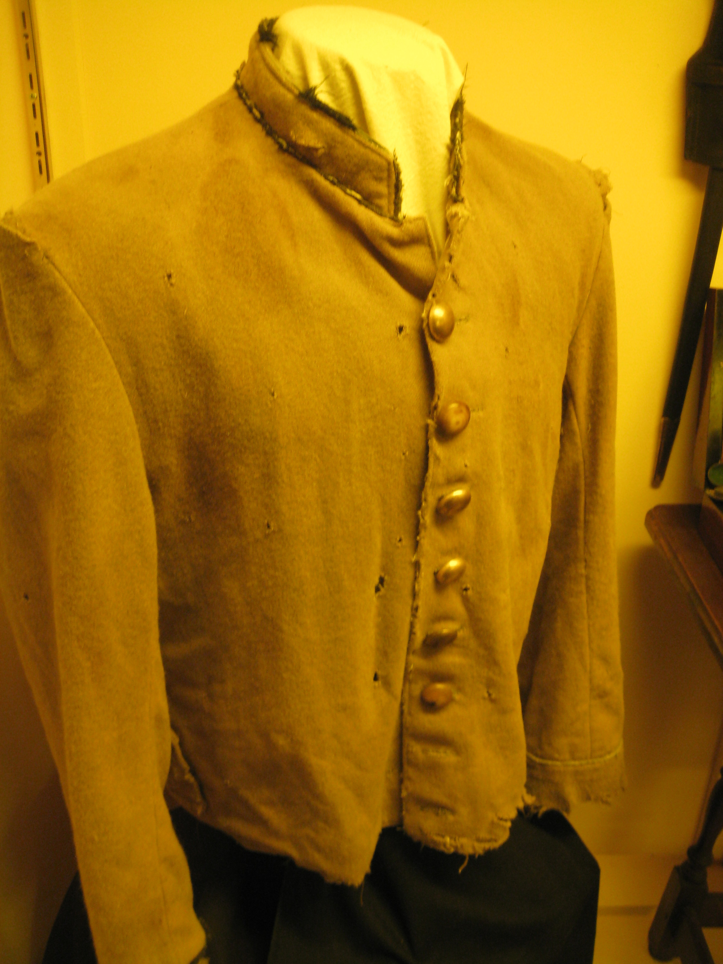

          Re: Richmond Depot Jackets
          Guy,
          Cool pics...do you mind sharing where this coat is on display?
          Note: Per Les Jenson's classification of Richmond Depot Jackets, this does not appear to purely fit those descriptions.
          Evidence of Colar Trim
          Evidence of Cuff Trim
          Am I wrong in thinking this jacket has a "Western-manufactured" feel to it...
          Paul B. Boulden Jr.
          RAH VA MIL '04
          (Loblolly Mess)
            All that I am willing to say is that it is located in Pennsylvania.
            I was told that if I was to show any pictures, to NOT mention where it was from. I wish to honor my promise.
            A little day tripping East of Gettysburg may lead you to this wonderful collection. Happy hunting... :wink_smil

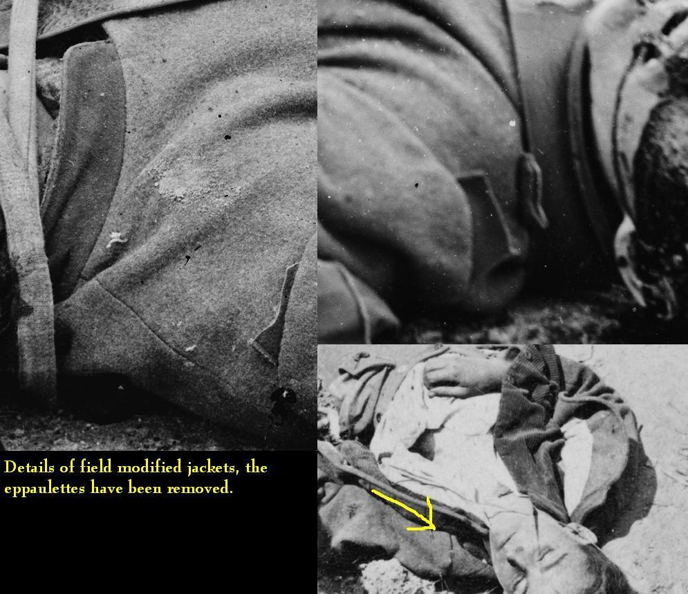

                    as to removing the eppauletts...
                      I believe the torn sholder straps on the Ft. Mahone photo above (artilleryman?)were from souvenir hunters cutting the straps vs. being done by the wearer. Look closely and you will see this.
                        The jacket with the epaulet removed is a P-Tait. This photo was discussed in great detail on the forum some time ago. If I remember correctly all the jacket buttons have also been removed. These high quality buttons were presumably cut off by souvenir seeking Union Soldiers. Based on the location and circumstances under which the picture was taken, I would not assume the epaulet was removed by the wearer but by the same Yankees that cut off the buttons.
                        Is the other picture also on the LOC web? I would like to take a look at the vest buttons.
                              Cheers,
                              I have seen this jacket as well Guy. However, most historians and collectors who've look at it are suspect of it's provenance. Unless the owner can provide us with a clear history behind this jacket, I would recommend to the AC forums that we not use it as an example of a Civil War era garment.
