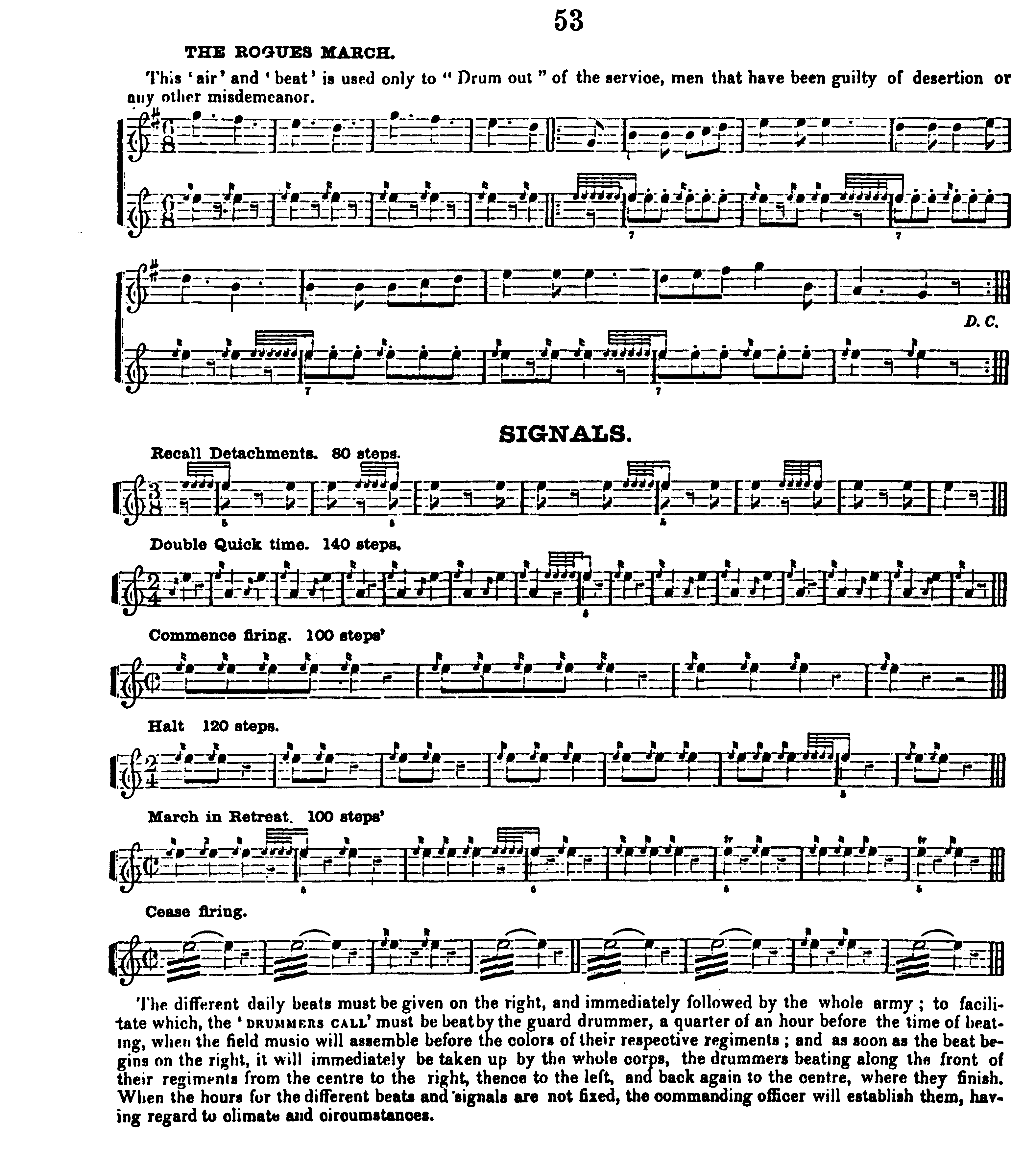

            The NPS video is probably the reenactorism "fire by the drum." The drum signal "commence firing" found in the manuals does not indicate that it is used for a volley, and if one listens to the period signals, he will see that they are not set up in a "ready, aim, fire" fashion.

              Here are the signals for commence firing from Hart (1862) and B&E (1861).
              Will Chappell

                Thanks everyone! I too thought it was a re-enactorism when playing during the movements. But I really didn't know so I wanted to double check with all of you. But I knew there was a drum signal in B&E for Commence Firing. Thanks for the help, I will let the people on the other forum know.

                  There are calls for firing, but as far as me own knowledge stretches, there are no calls for the steps of loading....
