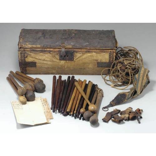

    I don't know how they came up with the 1790-1840 range, but it's highly likely that these sticks date to the Civil War or pre-war. I wish I could get the measurements of some of these. It's always hard to date drumsticks. People claim skinny post-war drumsticks to be from the war just because they happen to be made from rosewood or ebony, but when you have a collection this large, what are the odds that most of them are post-war?
    Sold For $2,160
    Buyers Premium included
    A CANVAS-COVERED WOODEN TRUNK FULL OF DRUMSTICKS, STRAPS AND ROPES, CIRCA 1790-1840
    MEASUREMENTS
    height 10in. by length 24in. 25.4cm. by 61cm.
    DESCRIPTION
    the iron-handled trunk filled with sixteen plain, four turned and six leather-covered wood drumsticks, some for bass and some for snare drums, a drummer's strap and assorted drum ropes. The trunk with the remains of old wall- and newspaper linings. Approximately 30 pieces.

      Guthman collected anything and everything relating to American militaria for many decades (I really wanted to attend that auction!), from many different sources. I don't think most of it had any provenance, and therefore their exact date of origin is unknown, especially items like drumsticks that didn't significantly change over time (there were no '61 and '63 model Springfield drumsticks, for example).
      So I don't think we can really know when these were made. It's actually more likely that most were made later than earlier, as the older items are, the more rare they are, especially things that people like to pick up and beat against hard surfaces and can break.
      In fact even if someone guarantees drumsticks or anything else "belonged to" a Civil War drummer (something like "passed down from my great-great grandfather" is typical), that doesn't mean he didn't pick them up long after the war (they don't mention that part, if they would even know).

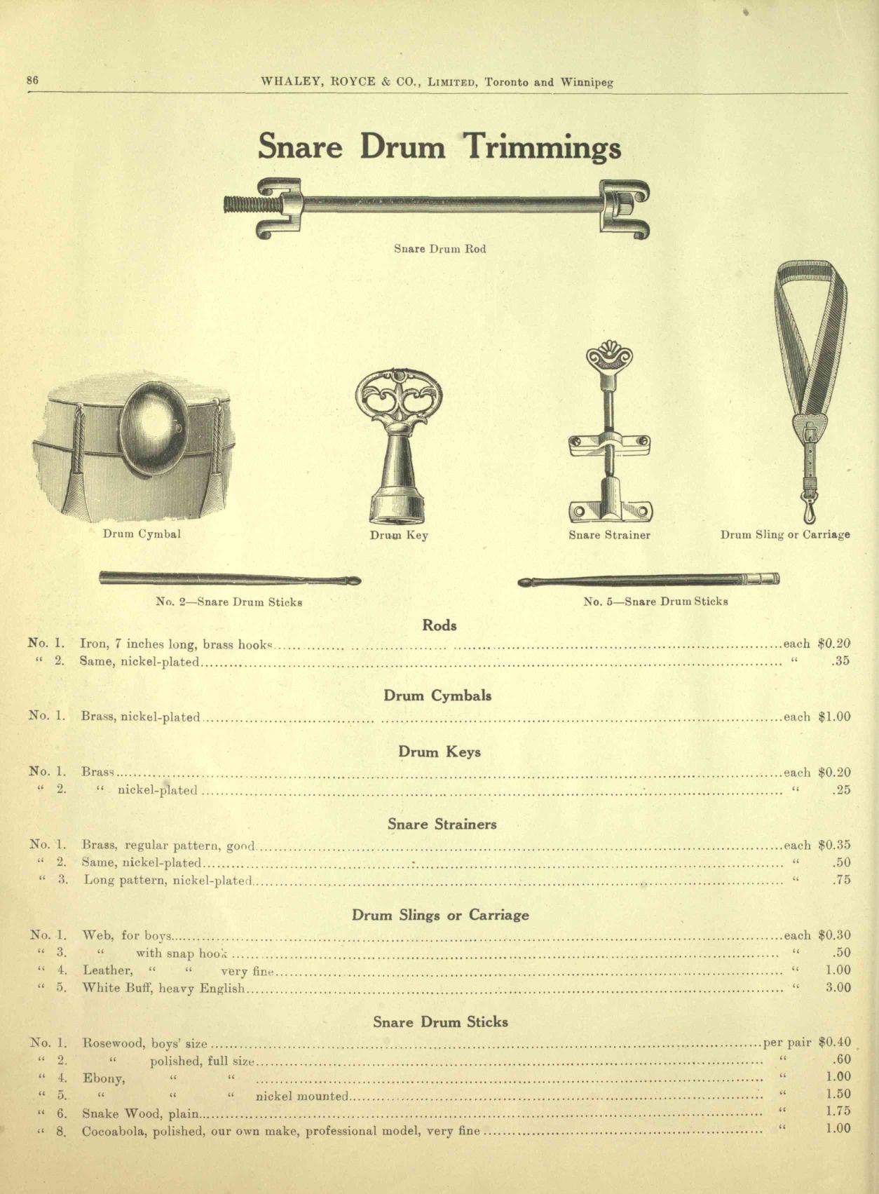

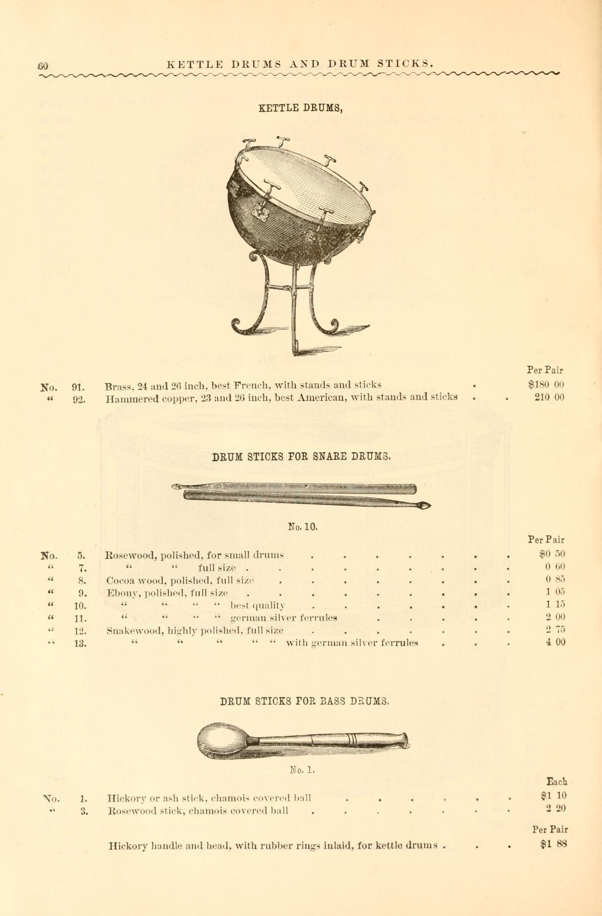

        And many of those ebay "Civil War" drumsticks look like the ones in these postwar catalogs:
ID:	222823Click image for larger version
        One is John C. Haynes 1883/1884. The other is Royce 1907.

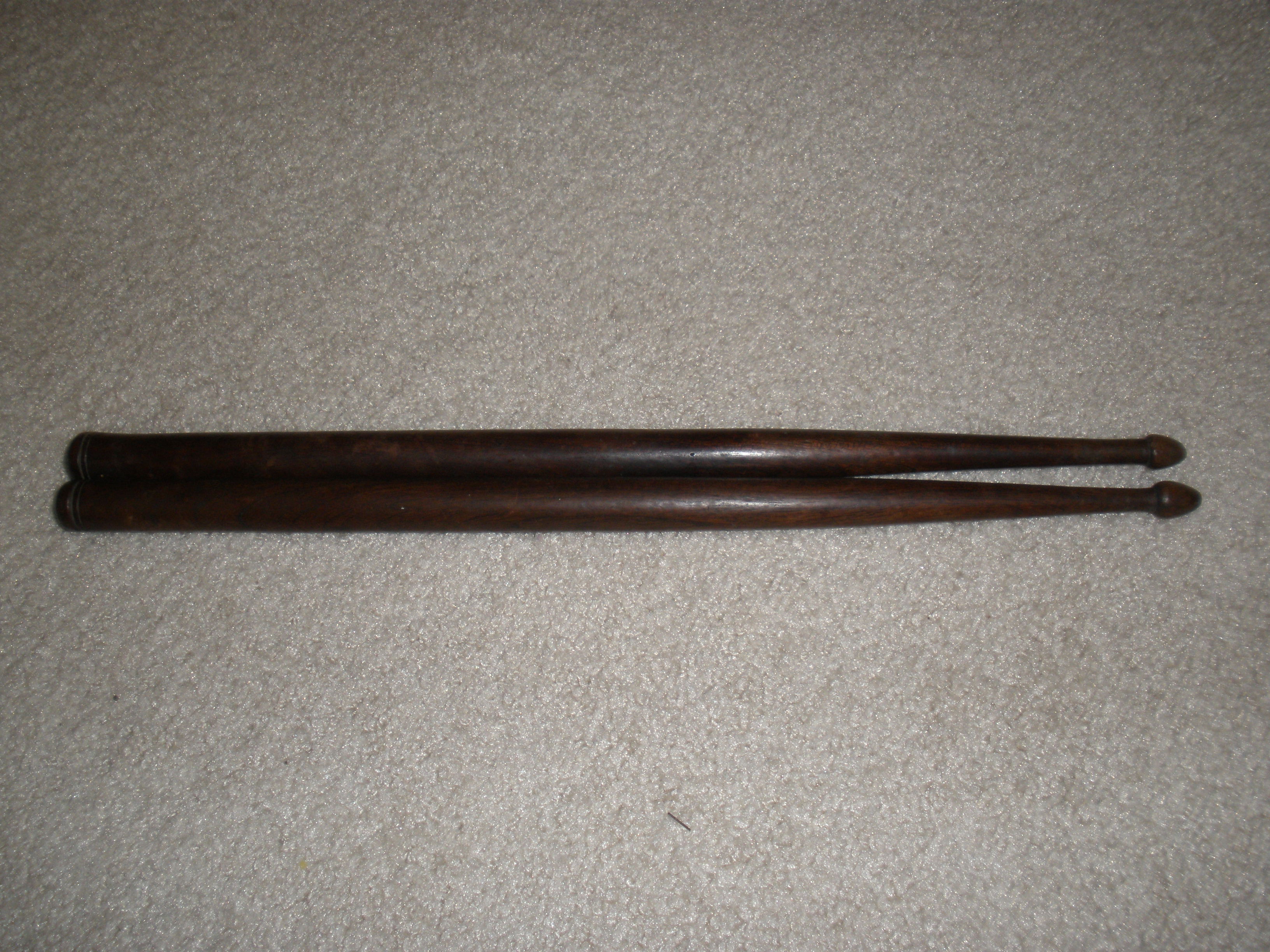

        It's impossible to know for sure how old sticks are, even with provenance, but there are tell tale signs, like sticks being slightly mismatched.

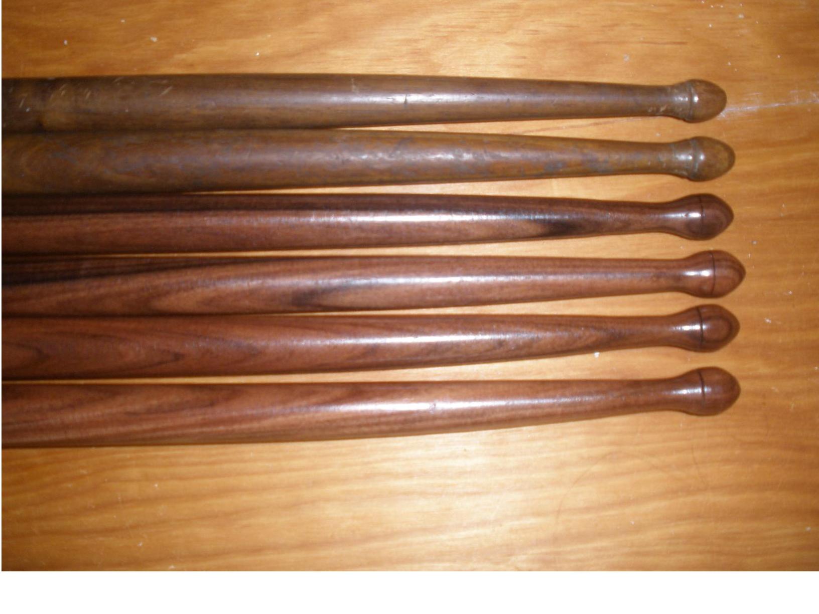

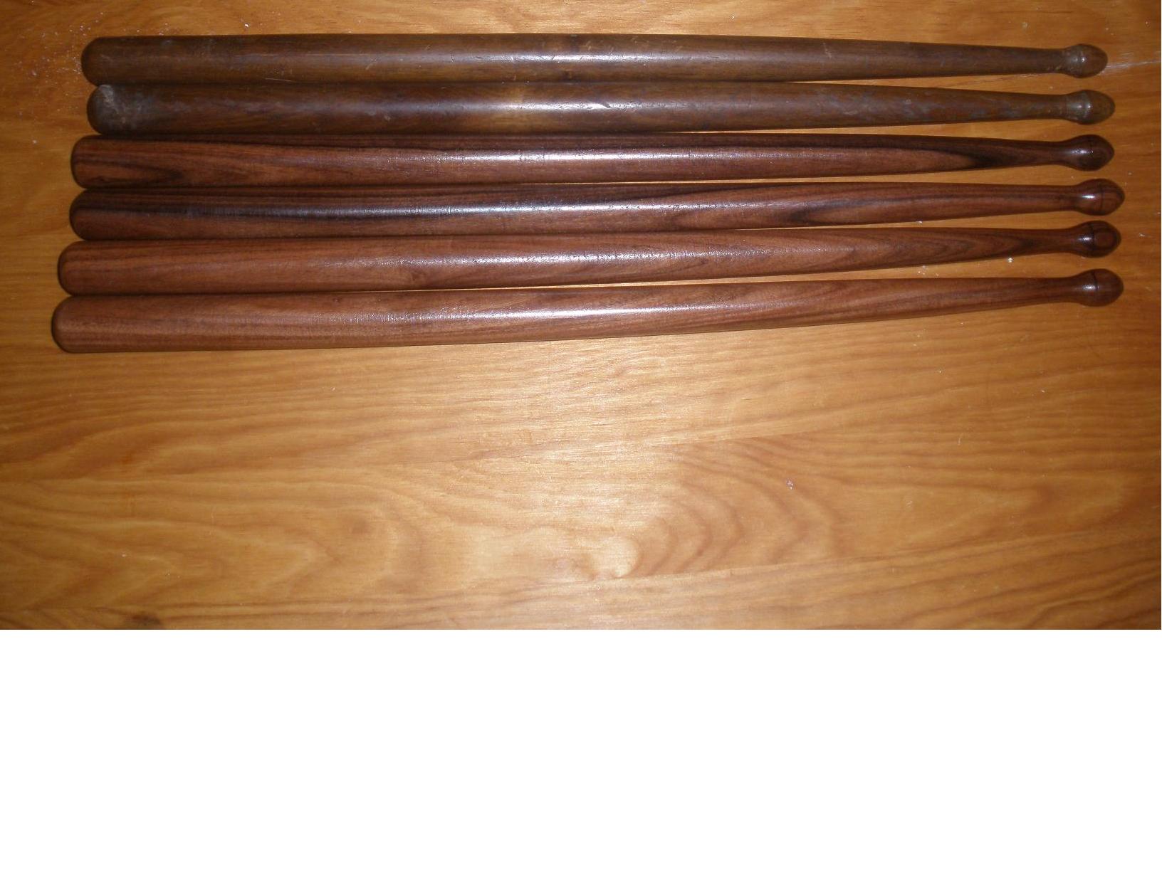

        Here are two pairs of "originals" I own. Ignore the two repros in the photos. They are clearly "handmade," but I suppose it is just as likely that some amateur was making them in 1930 as in 1830. So you can go round and round in circles.
