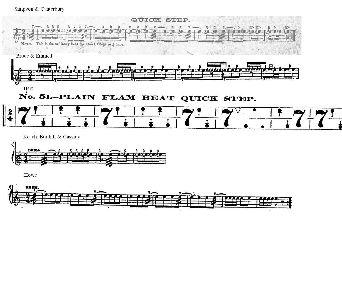

      I think there is probably a difference between Howe's notation and they way it was actually played or intended to be played. Remember that Howe was not a drummer and his tutors for various instruments were all mostly fiddle music repacked as accordeon, flagolet, fife (etc.) music. Howe relied heavily on Keach, Burditt, and Cassidy's Army Drum and Fife Book for many drumbeats, using the same plates.
      Most of his beats copied from Keach have the flams in the right places. But most of the beats unique to Howe's manual are missing flams where they should be. The 7 flam flam flam flam flam flam appears in several beats from many 1860s manuals (see attachment) but only Howe has it as 7 tap tap tap tap tap tap, like in Wrecker's Daughter. I think Howe or the printers were either sloppy or Howe didn't know what he was doing.
      If you look at the Army 2-4 Army 6-8 Howe attachment, you will see that for these two well-known beats Howe uses taps in some phrases and then flams when the exact same phrase is repeated. This must be sloppiness or errors.
      Perhaps several flams are missing in the notation for Wrecker's Daughter.

        I hadn't noticed the difference in manuals with the flams but you're probably right. I'll add those when I have a chance.

          The beat in Howe is actually pretty close to the one they play in Connecticut today. I am pretty sure they play 7 flam flam flam flam flam instead of 7 t t t t t t. There's also a version in the Moeller book.

            Will thanks for sharing your copy of S&C. I've added a version of "Wrecker's Daughter Quickstep" with additional flams at the above link.
