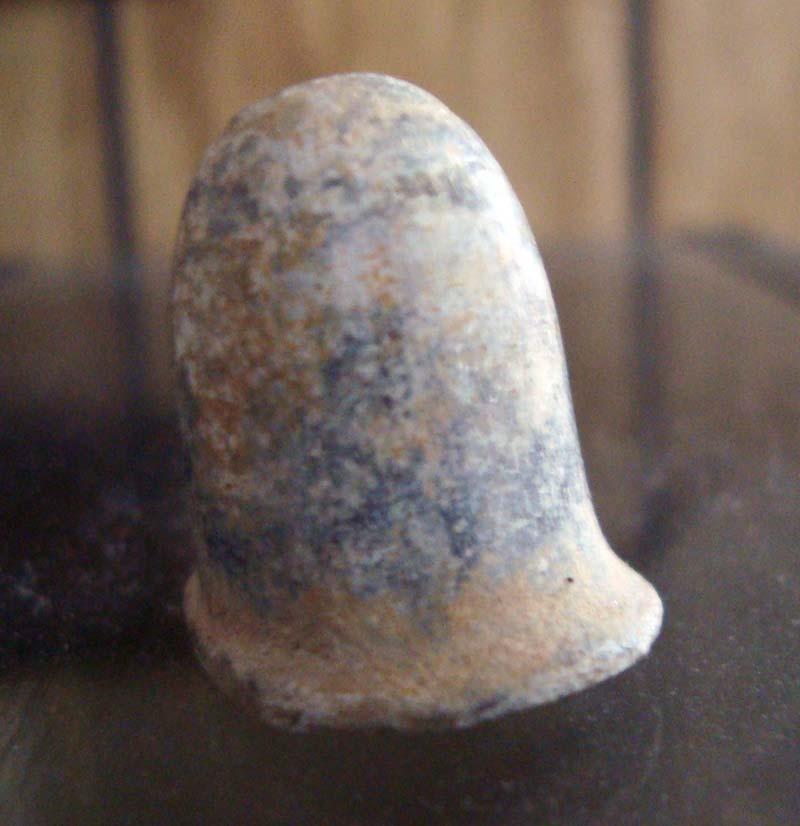

      And if they forgot to invert the bullet and loaded like a convential US minie this may have been the result. It would appear that this bullet was fired without inverting and the base struck first. Not too uncommon to find them like this. Click image for larger version
