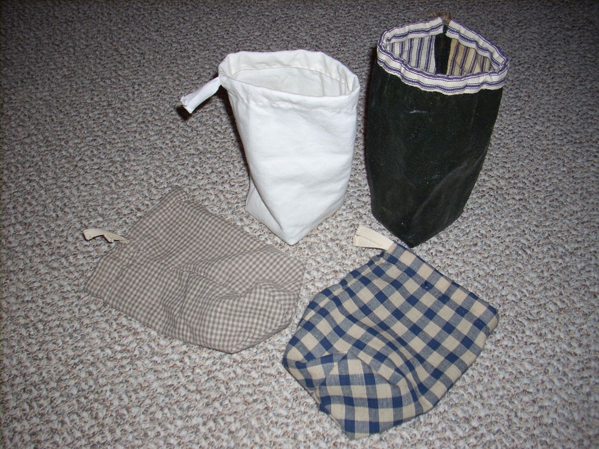

            • #36
              Re: USSC Patterns
              Troy,
              As promised, here's a picture of some of my attempts at the bags & variations there of. Nothing too spectacular, but a fun evening project just the same.
              You posted earlier in the Thread of the period accounts of enameling. How did you accomplish it? Did you approach it from period painting of fabric?

              • #37

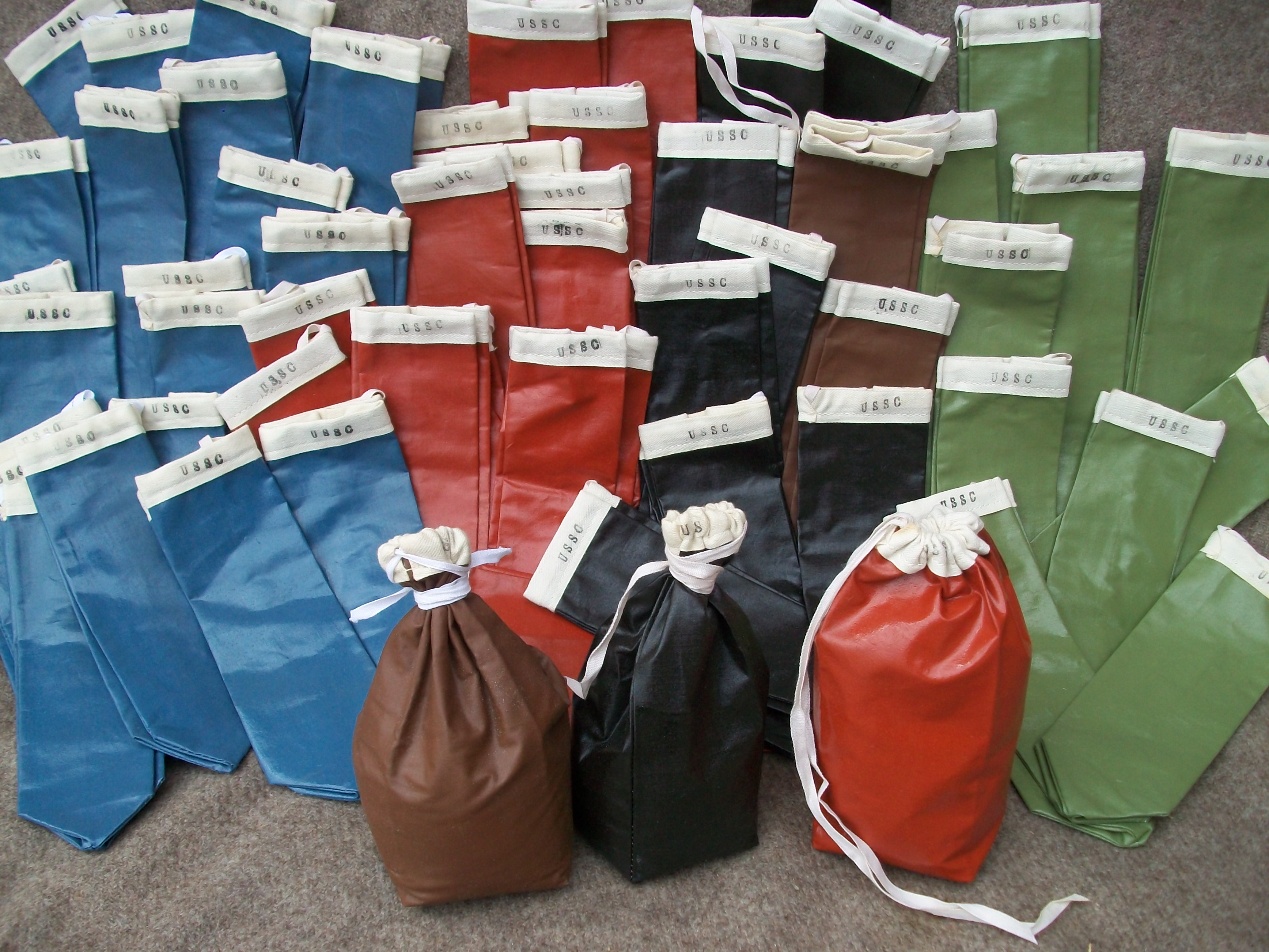

                          Since I uploaded photos of ration bags to the thread about how to tie a poke sack, I thought I'd upload some more examples of USSC ration bags here. I made the enameled cloth from multiple colors since it came in a variety of colors back then. As items made made at home and donated to the USSC it makes sense that they'd have made use of the variety of material available. This batch of painted cloth was made from a fine quality painted muslin. It is nice and light weigh but quite sturdy after sizing and two coats of linseed based paint.

                              The cloth for the USSC Bags was painted like Haversacks with cornstarch as sizing, or without, so that the colour was bleeding ?
                              Did this bags have an inner bag, like the Haversacks ?
                              A Picture from the inside ?

                                The bags I made according to the period instructions are made from very light weight pre-painted cloth which has no bleed through. According to the instructions they are not made with liner bags. They are much more like large fancy poke sacks and so for the small lightweight bags they are there really wouldn't much point to adding a bag to them.
                                The real challenge is not so much in making the bags which are a very simple design, but in replicating the period factory made enameled cloth . Aside from the descriptions of the cloth included in this discussion, I've acquired and examined several pieces of enameled cloth from the era and am even now still working on improving my methods and techniques as well as experimenting with silk and other fabrics that were factory in the period. Starching the fabric has proven to be critically important and significantly affects the finish of the final cloth.
